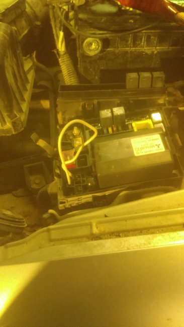

Is there a fuse that I am missing for the power to the PCM? I have checked all fuses and all are good the car will not start and run at all but if I take out fan relay and run a positive power wire to the pcm terminal for the fan the car will then start and run. So is there a fuse that I am not finding that is bad?

Looking at the wiring diagram that back feed goes to a splice that leads to another splice that feeds the PCM. But because it runs with the feed in place I am thinking you have an issue right in the fuse box circuit board. The splices feed multiple areas as well as the PCM so if the splice was bad those would not operate even with the jumper in place.

The splice is inside the PDC, it feeds the pump, PCM, Fan and a few others that all allow it to run. The jumper you add in bypasses the broken area and feeds the power "backwards" into the other side of the connection. So the pump and PCM get power.

THE pdc doesn't have any circuitry board to it it's all wires going to each fuse and relay is there possibly a fusible link that is bad

No fusible links showing up except the one from the alternator to the battery.
I would check the connectors in the PDC, It shows fuse 14 as always hot PCM feed, to splice S104 inside the PDC and that feeds the PCM and the auto-shutdown relay.
Fuse 12 - low/high fan relay and A/C clutch.
Fuse 11 - switched power PCM fuse
Fuse 10 - ignition switch fuse that feeds fuse 11

Well Steve I'm stumped now if traced it down what my wiring diagram calls the mfi relay figured out that it doesn't have a ground so I gave it a ground and car will start and run but don't hear fuel pump after running for about two minutes it dies but starts back up but I can't figure it out cause when I was checking wires at pcm that wire was at the pcm and had a very low voltage reading of less than a tenth of a volt but at rely there was nothing but that reading comes out on positive instead of a negative do u have any ideas on how to fix this issue

That sounds like the driver in the PCM may have failed. That should be a pull down to turn the relay on.
What doesn't make sense is the running for a couple minutes. Unless the immobilizer is going flaky. That would give you the no start and no power to the MFI but it should show the security light (unless it's blown?) Or set off the alarm if that was the case.
