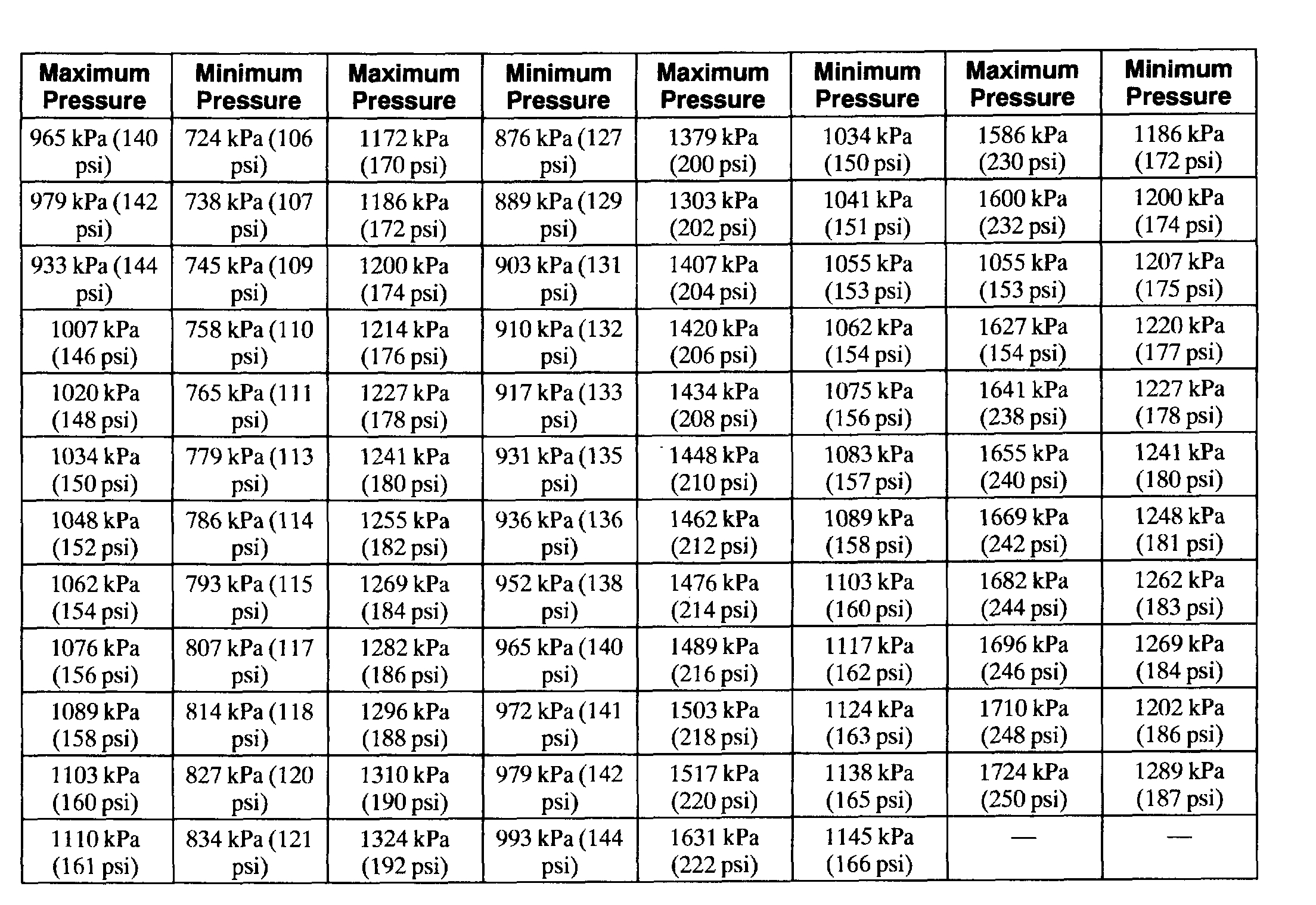

Engine missing on cylinder number four. New Bosch plugs, new wires, new coil pack. Totally random compression reading on cylinder number four. New decent quality compression gauge, screwed in tight and left in place for all tests. Low of 50#, high of 110#. After a half dozen varied readings, I wondered if time between readings would matter: 83# 12m. Later 85#, one hour later 90#, 1:20 later 90#, three and half hours later 100#.
Had a mechanic check with his gauge, two 60's and a 90. He believes a valve job is needed, pretty costly. So I am grasping at straws and also would like to know what a valve's problem would be to be so inconsistent? Sticking or bent?
I have run two cans of "Sea Foam" through the gas and currently have "Restore" in the oil.
Other than an obvious miss, especially on acceleration, it runs good and power's good.
I am stumped and curious. Any thoughts?

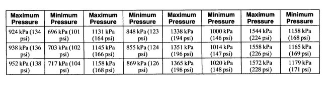

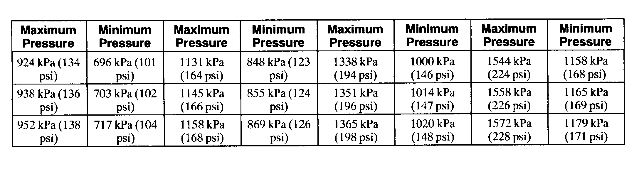

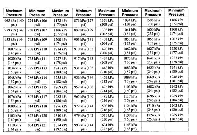

Next, keep in mind, it could be a valve or rings. The compression readings you got are exceptionally low. According for Ford, more than a 25% variation between the highest and lowest compression reading for the cylinders is a problem. However, Ford does not provide specific ratings for the compression other than that variation. With that in mind, I have attached two pictures for you to refer to. They indicate the maximum PSI and the lowest acceptable PSI readings. These are basically the highest compression found vs the lowest acceptable.
Next, since we are not sure if it is a valve or a compression ring issue, here is how you check. As far as the variations in testing, that can be the result of temperature, if you have the throttle plate open when testing. Usually, a weak/worn cylinder stays somewhat consistent.

Compression Pressure Limit Chart
If one or more cylinders reads low, squirt approximately one tablespoon of Super Premium SAE 5W-30 Motor Oil, XO-5W30-QSP or equivalent meeting Ford specification WSS-M2C153-G on top of the pistons in the low-reading cylinders. Repeat the compression pressure check on these cylinders.
Compression Test-Interpreting Compression Readings
1. If compression improves considerably, piston rings are faulty.
2. If compression does not improve, valves are sticking or seating incorrectly.
3. If two adjacent cylinders indicate low compression pressures and squirting oil on each piston does not increase compression, the head gasket may be leaking between cylinders. Engine oil or coolant in cylinders could result from this condition.
Use the Compression Pressure Limit Chart when checking cylinder compression so that the lowest reading is within 75 percent of the highest reading.
