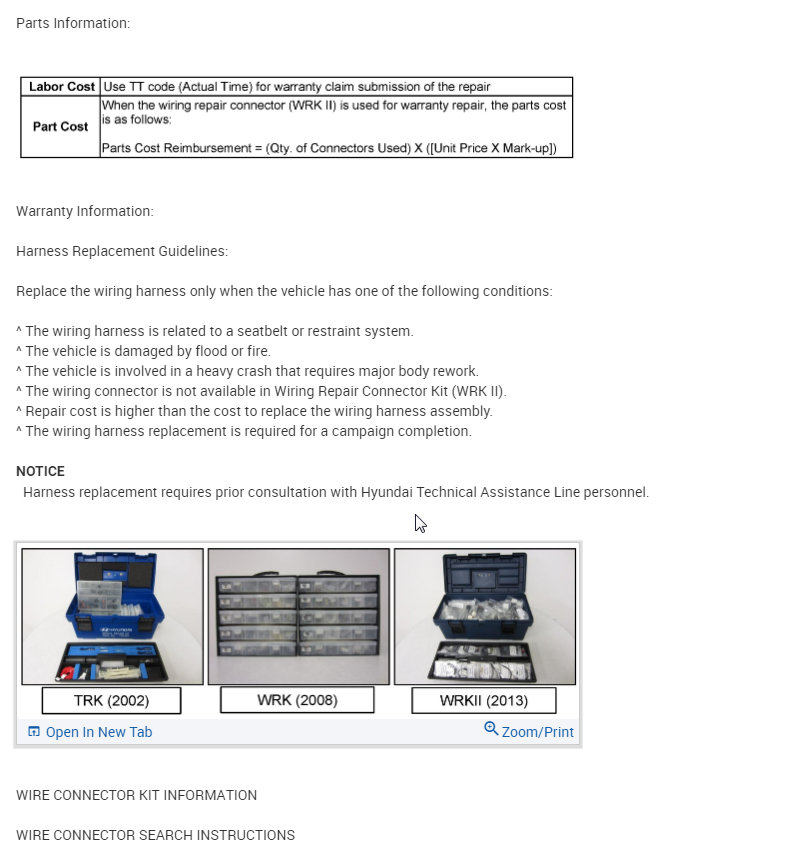

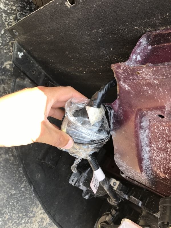

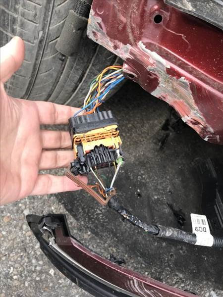

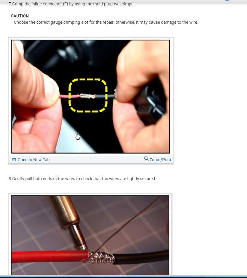

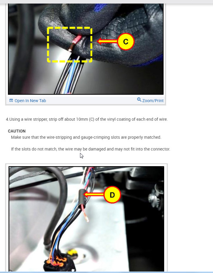

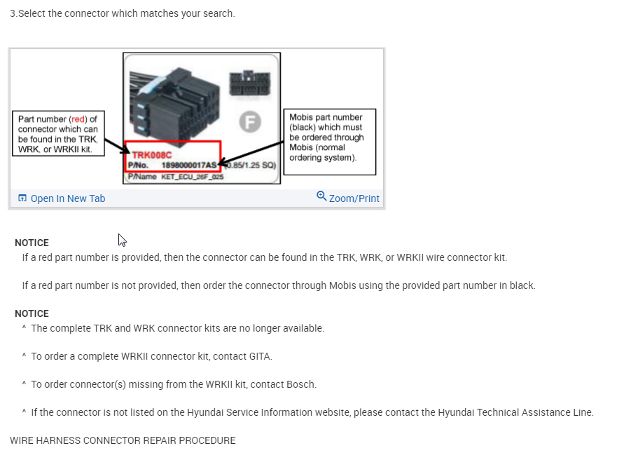

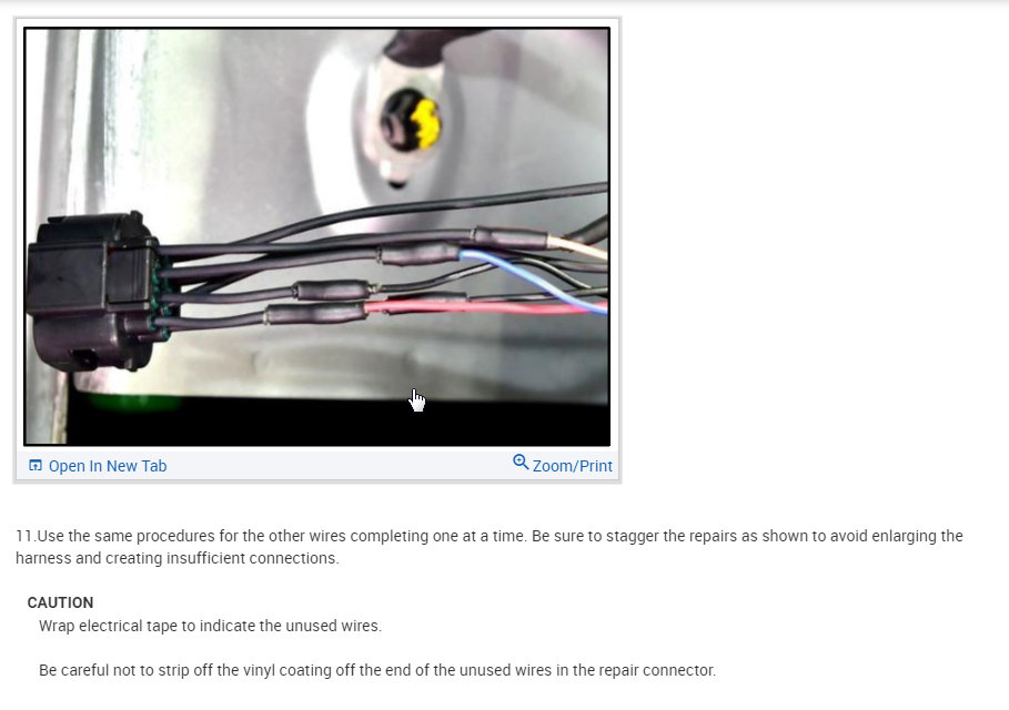

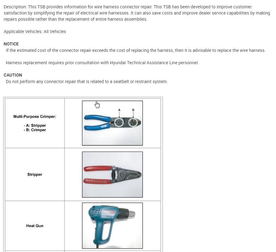

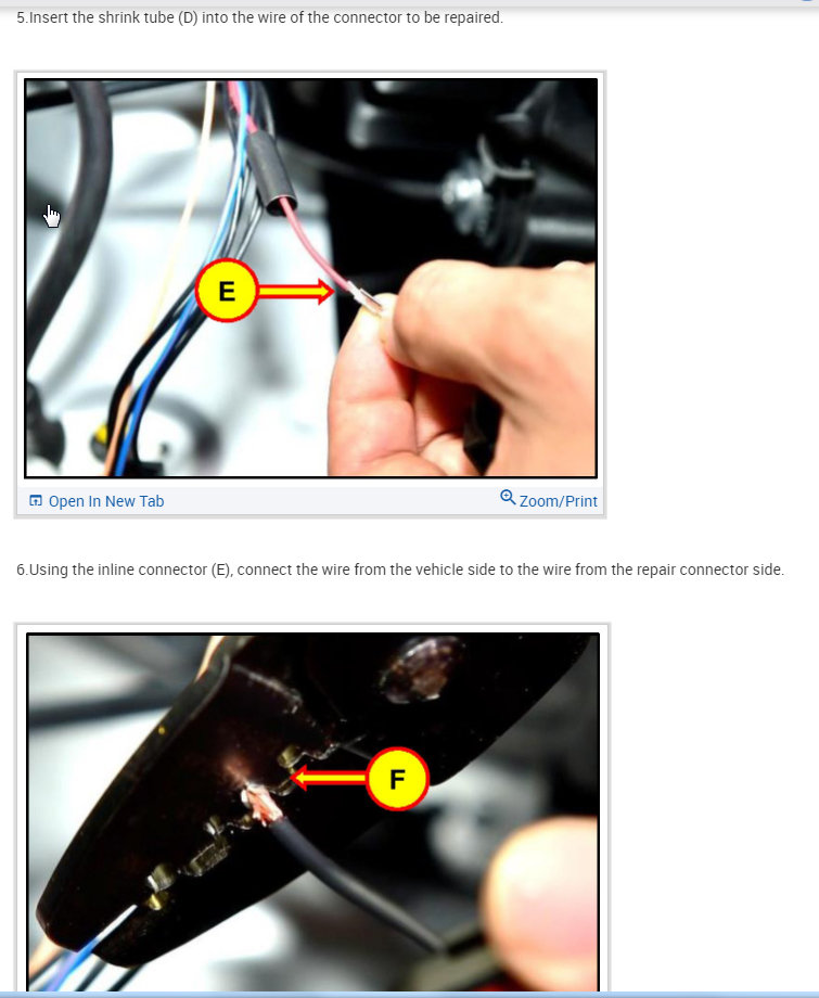

The electrical harness was damaged and needs to be replaced. The auto repair shop told me the engine needs to be pulled to do the repair. Could this be true?
Jul 25, 2019 at 1:09 PM
  • CAR REPAIR CONTRIBUTOR

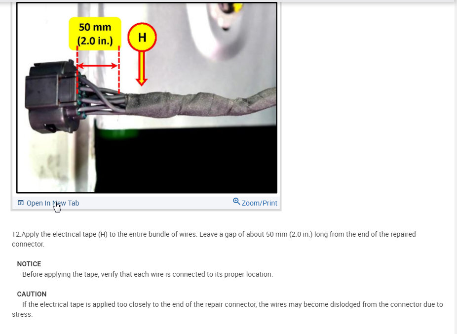

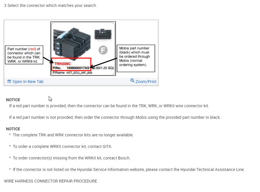

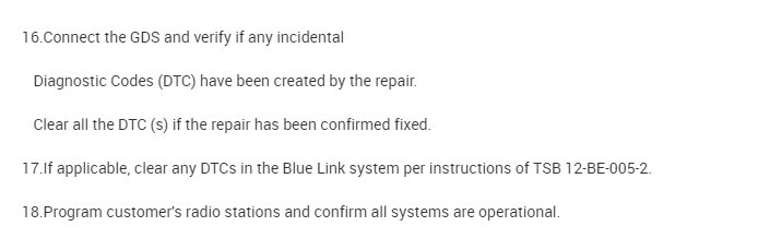

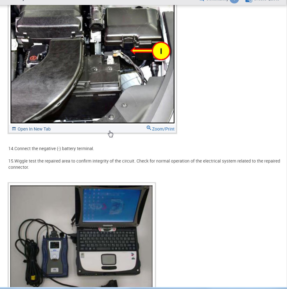

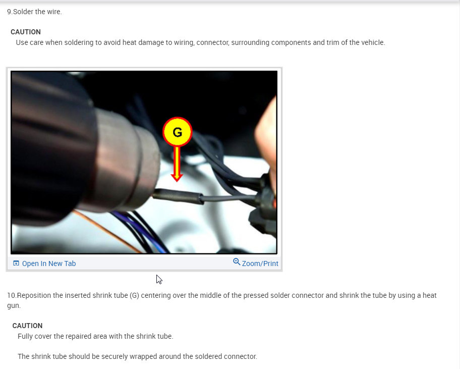

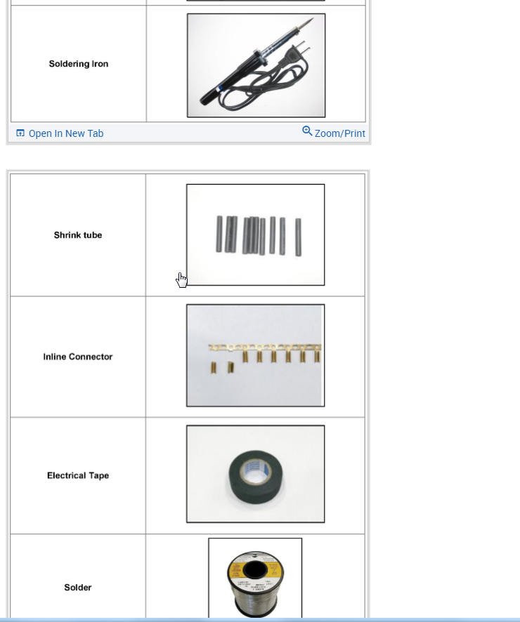

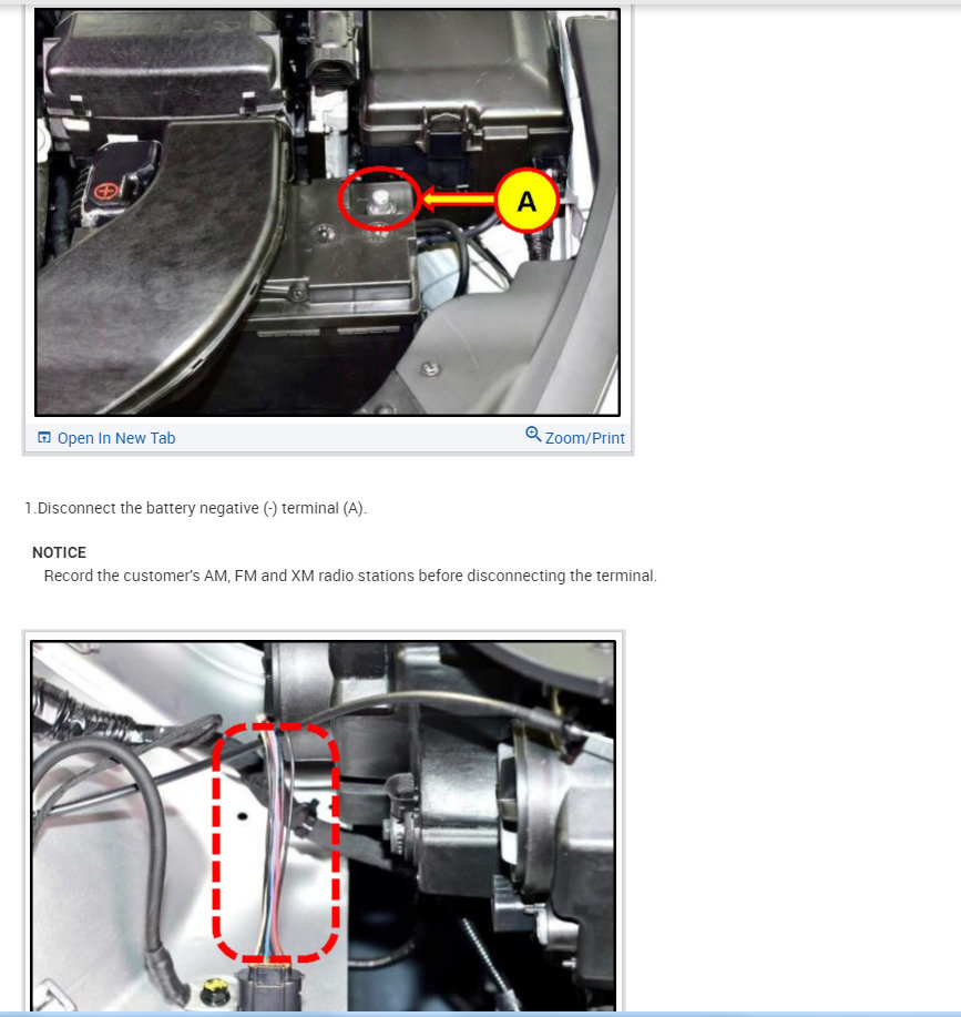

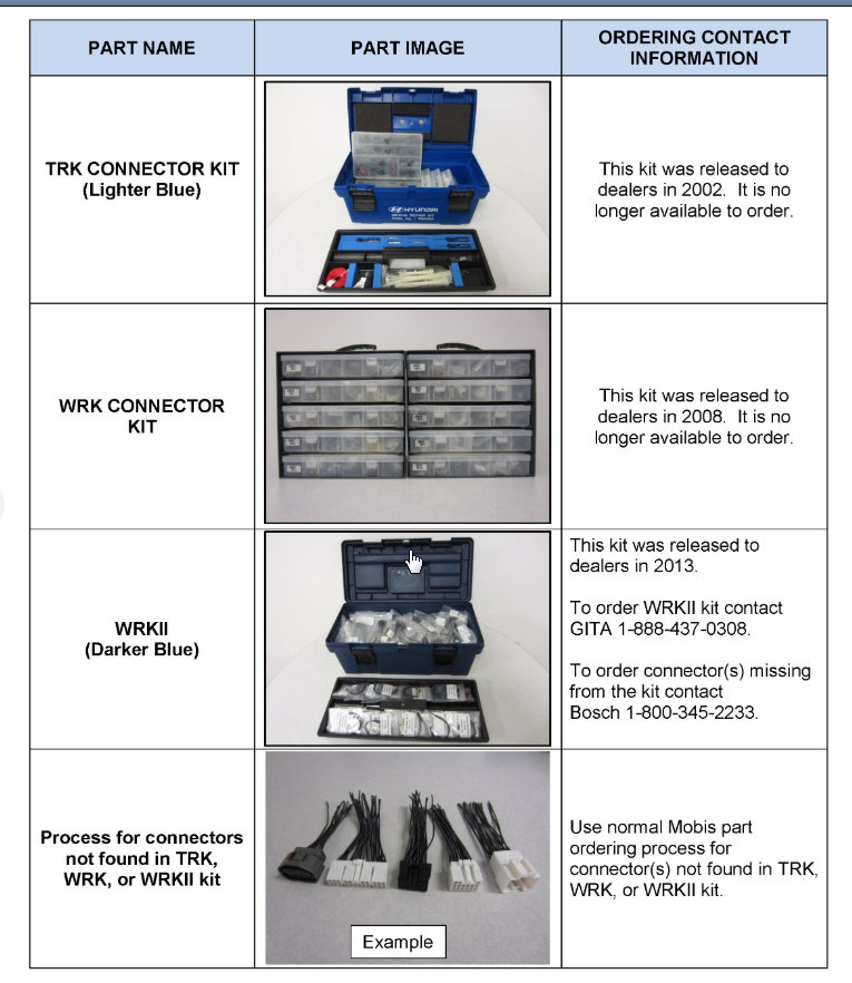

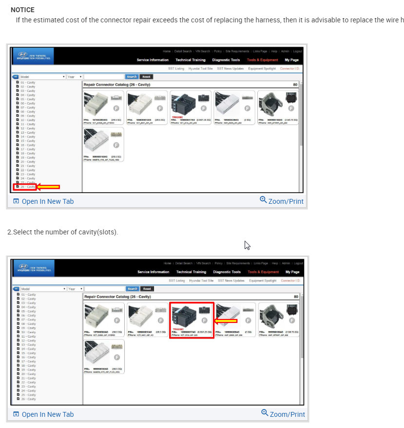

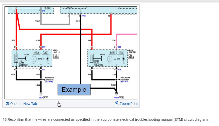

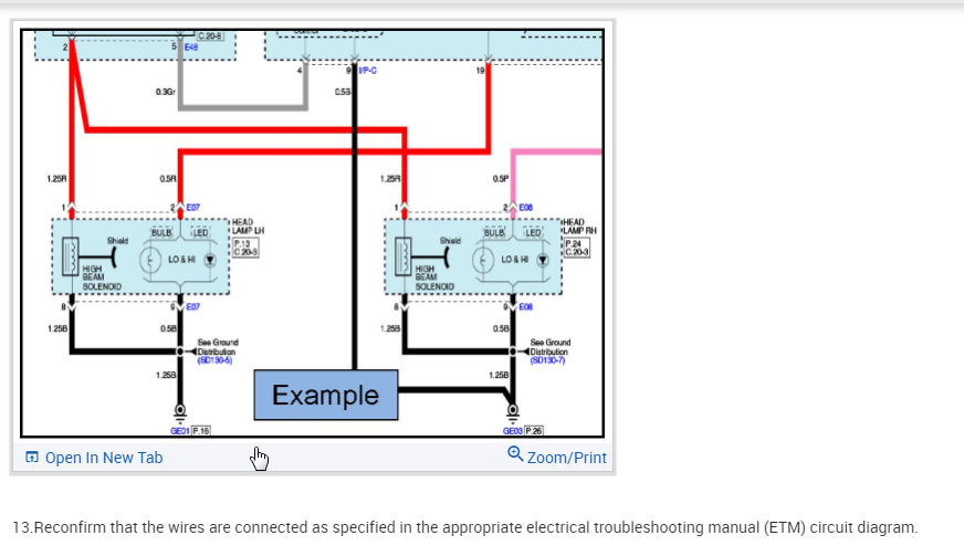

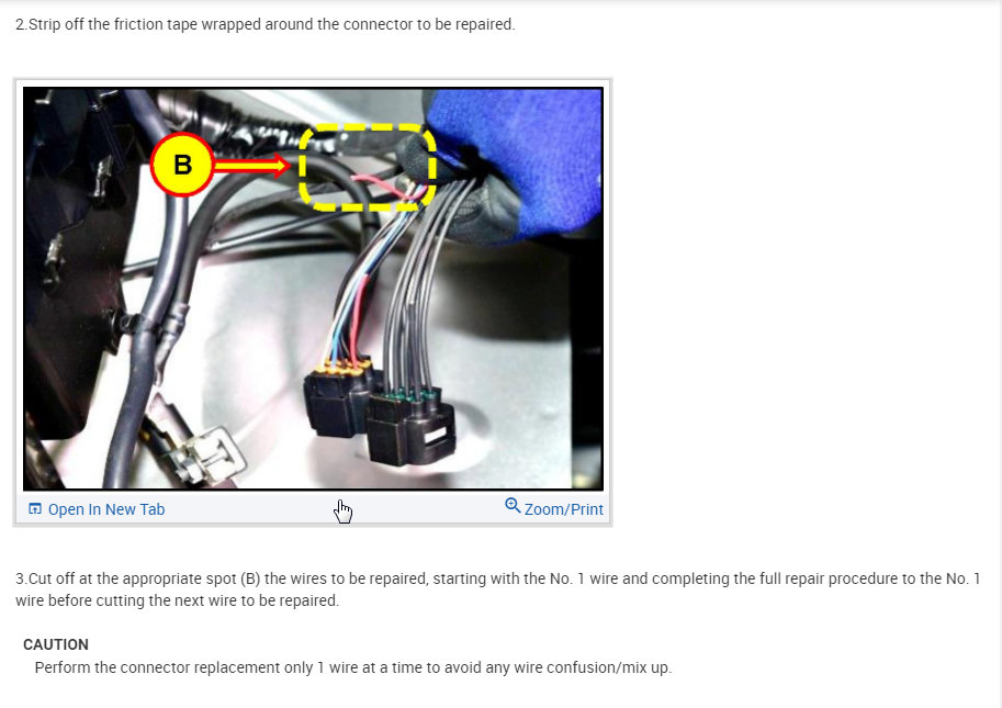

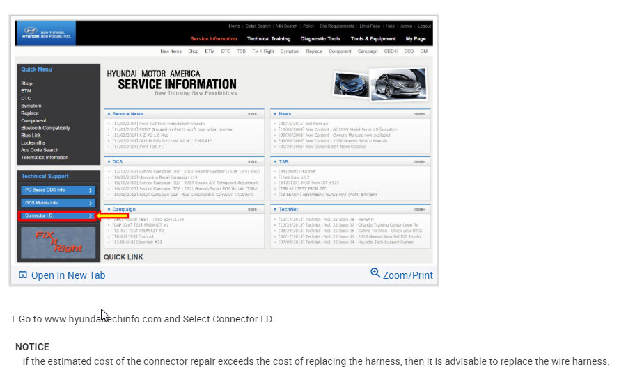

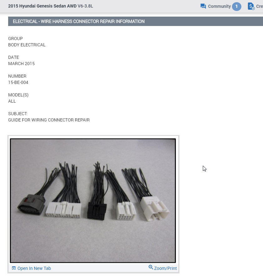

It is possible but I am not finding this exact harness that would require to remove the engine. However, this is the reason that the OEM came out with the TSB attached. They are stating that you can just replace the connectors rather than replacing the entire harnesses. Note the first part of the TSB.
I would suggest showing this to the garage and see if they can replace just the connector.
Let me know if you need more info.

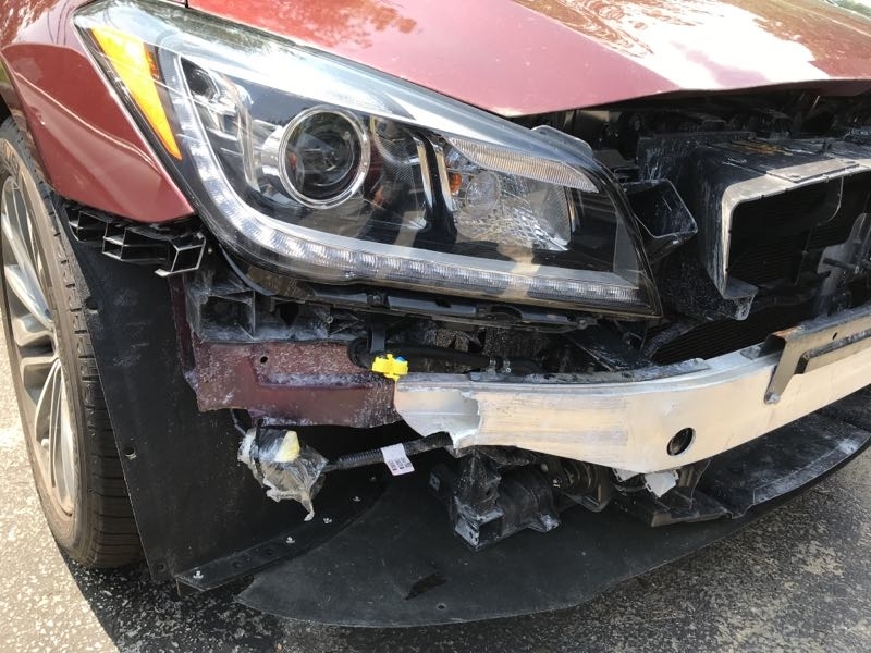

Thank you KaseKenny1, I'm asking because the first shop, who was paid by my insurance company for the replacement, just taped it up and of course it broke down several times. The latest shop told me they never replaced half of the parts they were paid to replace. now I face an $8,299.00 bill which I have to pay out of pocket.

These pictures were taken at the second shop after the first shop did the $13,595.00 repair.
