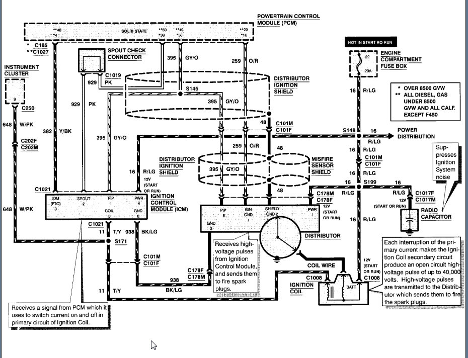

Have to rewire coil factory splice went bad 4 wires -2 wires at coil?
METALMAN74
  • 1996 FORD F-150
  • 5.8L
  • V8
  • 4WD
  • 76,000 MILES

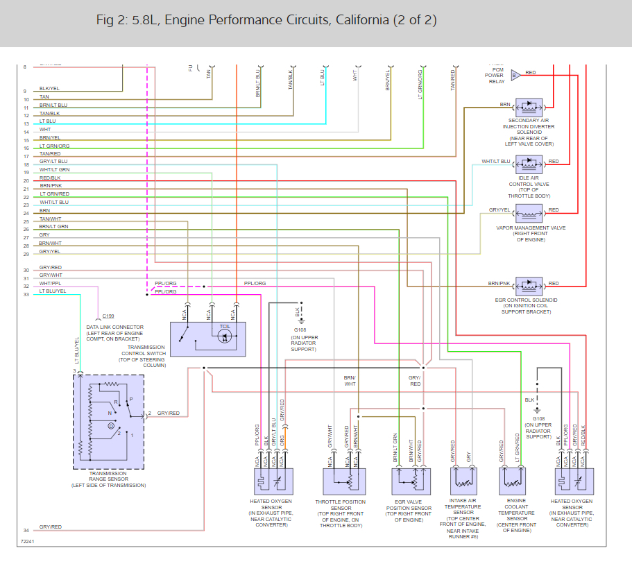

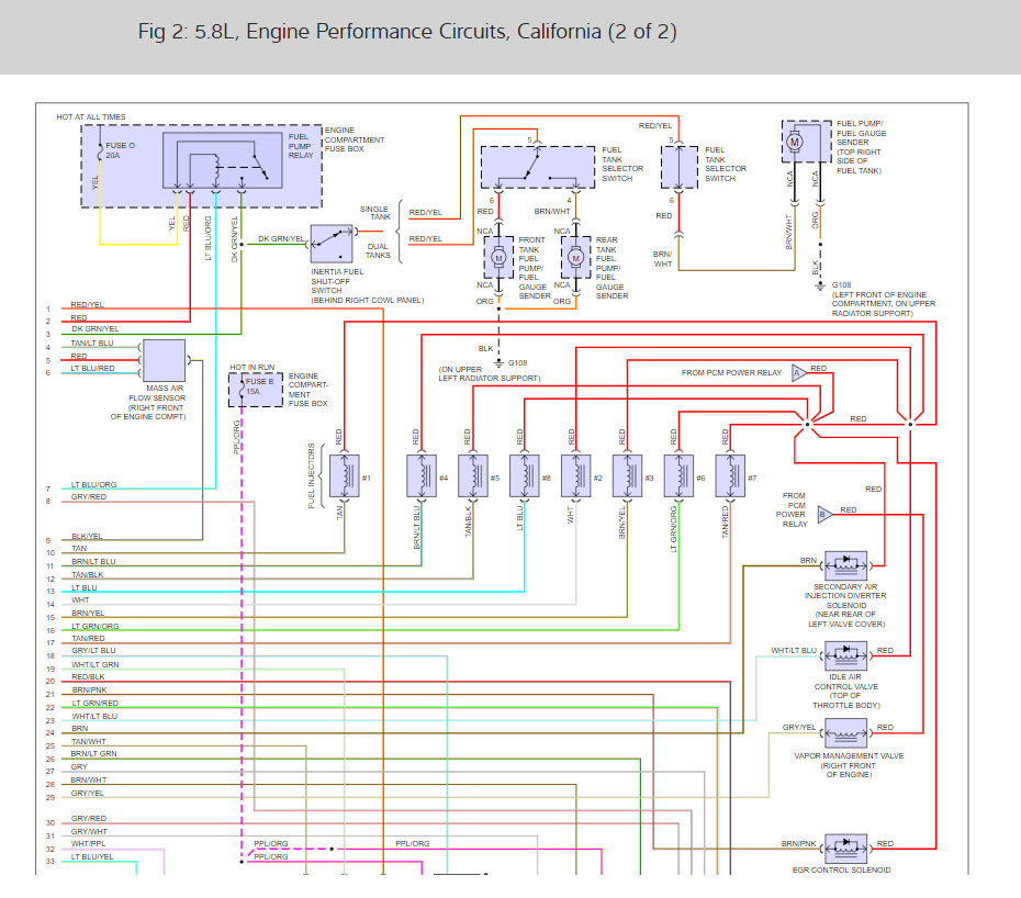

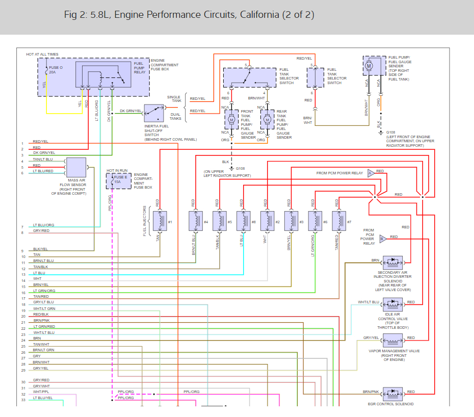

Have to rewire coil factory splice went bad 4 wires -2 wires at coil. 1(wire from distributor)1 from ignition module 1. Hot from ignition 1 from am radio.
Saturday, October 26th, 2019 AT 10:33 AM
3 Replies

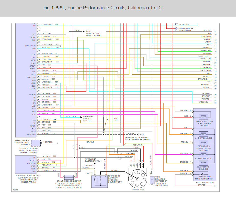

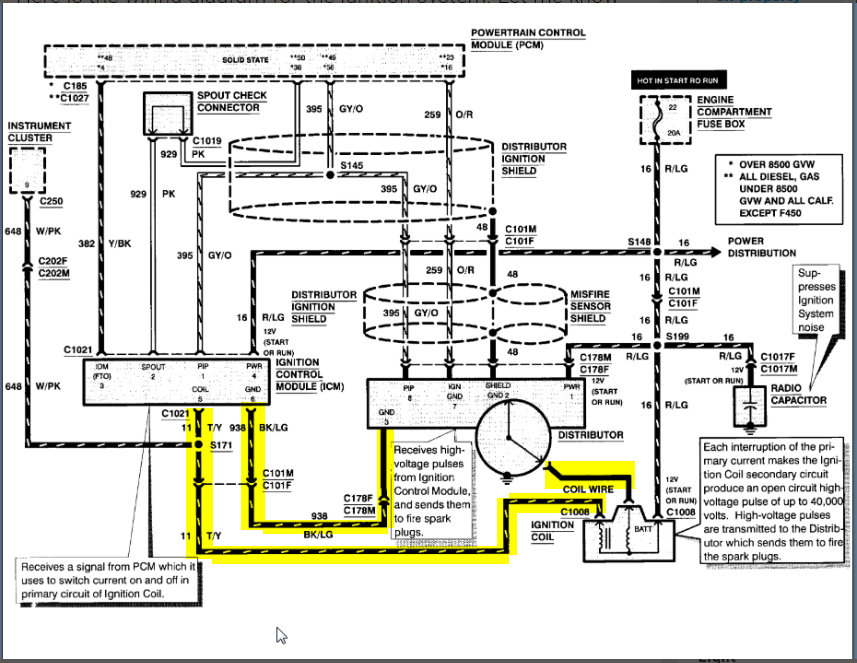

Here is the wiring diagram for the ignition system. Let me know if you need more information. Check out the diagrams (Below). Please let us know what happens.
Monday, February 15th, 2021 AT 9:54 AM
METALMAN74
Problem is I can't figure out what side wires go on. Think the distributor goes on negative of coil and module and key start go on positive.
I am not sure what you mean by negative side or positive side. I attached the wiring diagram that has the wiring colors.
If you need more help maybe get a picture of video of what you are dealing with and we can go from there. Thanks
