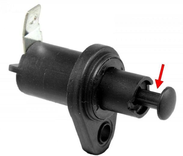

The door switch listed for your vehicle is this teardrop design. You can find tons of them in any salvage yard. They were used on '96 and newer Caravans too. They have an extremely low failure rate, but a lot of people replaced them for the "Door Ajar" light and the interior lights turning on when going around a corner. That was caused by the slight outward movement of the door.
These switches are one-time auto-adjusting, and often slamming the door caused them to over-adjust, then this problem would occur. The simple fix is to use a pick to pull out the plastic "nail". That is how it adjusts. You pull it out too far, then it will find its adjustment when you close the door.
I had a lot of these vehicles come into the dealership with this problem, but instead of selling the customer new switches, or simply pulling the nails out, my fix was to pull the nail all the way out, slide on three M5 lock washers, then put the nail back in. My nifty red arrow is pointing to where the washers go. The washers prevented the nail from over-adjusting in the future, so the customer never had that problem again. I always did both switches right away, and for that professional touch, the people in the parts department gave me a bottle of black touch-up paint to color the washers so they didn't stick out.
If one of those switches is missing, my suspicion is someone less-informed than you removed it to stop the chime and warning message.

I have one on the passenger side, rear passenger, and rear driver, but I don't know if they chime or turn on the interior lights. I know if I click the unlock button on the keyless remote the overhead dome lights and under dash lights come on. As I said before, I never tried to open the passenger side door to see if the lights came on because I never noticed the driver door jamb was missing. I happened to look after you mentioned it and saw the connector wire hanging where the jamb goes.
From what all I noticed on the other ones they are all factory, and have the jamb sticking out like it's supposed to. As I said, I'm going to buy one for the driver side and replace the other three and see what happens from there.
