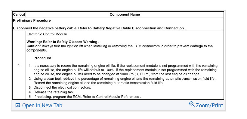

Hello, I have the car listed above that will not start sometimes and I'm getting a code u0100 ECM lost communication. I wanted to know what the issue could be. I also broke my fob key out of the fob but can still use it to turn the car on and start it when it decides to start, could this be the issue?

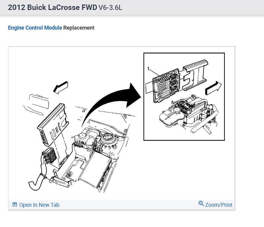

It sounds like the PCM went out or you have some fuses out. you can get a preprogrammed unit by searching Google or Ebay.
If the fuses are okay, I would replace the PCM.
Here is a guide to help and the instructions for your car in the images below:
https://www.2carpros.com/articles/how-to-replace-a-vehicles-main-engine-computer-pcm-ecm-ecu
The OBD-II trouble code U0100 stands for "Lost Communication with ECM/PCM."
