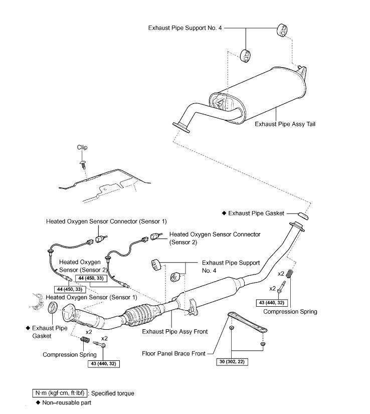

I am getting a check engine code of p0420 from my OBDII meter. I know this suggests a problem with the cat. To eliminate other possibilities i have changed both 02 sensors, cleaned the MAF, replaced spark plugs, and it is not yet in need of an oil change, i even hooked up a smoke machine to check for leaks i found one small leak and repaired it as well. After each repair i erased and reset the code meter. But before the car completes a full drive cycle the light comes on again! I am skeptical about the problem being the cat because i am not experiencing any of the other normal symptoms related to a bad cat listed. Ie. Sulfur smell, exhaust smoke, poor gas milage, low power, trouble starting, etc. Symptoms i am having which are probably unrelated are occasionally idling rough while in gear and at a stop, (shifting into neutral or park stops the rough idle) and occasionally having a high-speed vibration, if the light were not coming on i would not suspect any issues. I am trying to avoid replacing the cat but have run out of other possible things to remedy the check engine light and i am past due for my smog check to register the car! Please help!!

The catalytic converter is bad and needs to be replaced. Here is a generic guide to help you step by step with instructions in the diagrams below to show you how on your car:
https://www.2carpros.com/articles/catalytic-converter-replacement
Check out the images (below). Please let us know if you need anything else to get the problem fixed. An efficiency code will not affect the way the engine runs btw.
