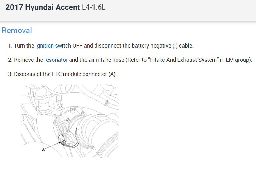

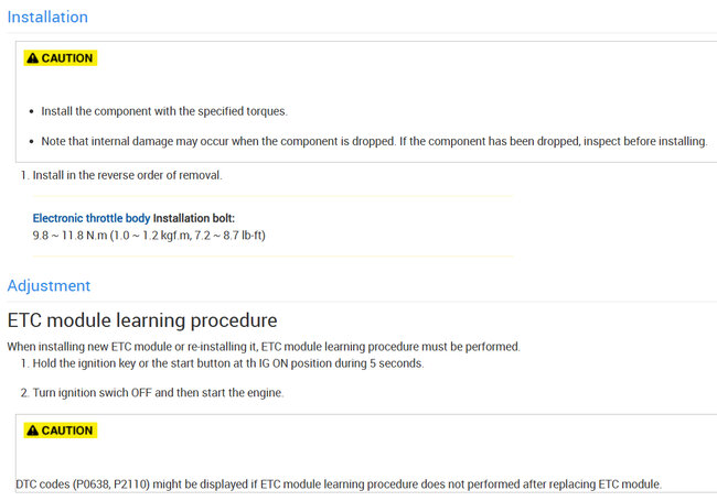

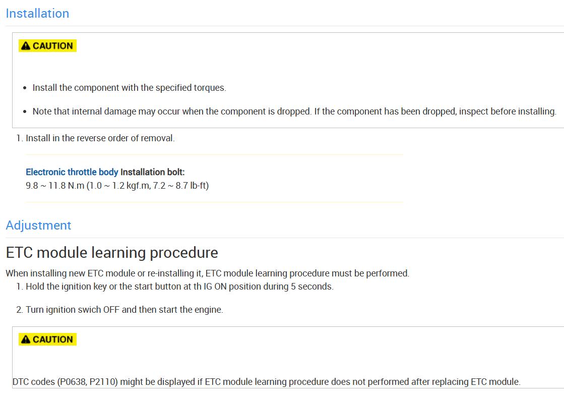

On my girlfriend ‘s vehicle I recently scanned it because the check engine light came on and it had the P0 300 302 and 304 codes as well as the P0420 codes. I have replaced the spark plugs, the coil packs both catalytic converters the upstream or bank one sensor 102 sensor as well as the crank position sensor. And I was cleaning the throttle plate on it and now it’s giving me a code P0123 on top of it it’s no longer giving me a stored code or pending code for the P0420. however, it is still running rough and it’s giving me a pending P0304 and 30302. once in a while, but almost always a code 304. just looking for some help on that and maybe how to get it to relearn the position of the throttle it says voltage high.

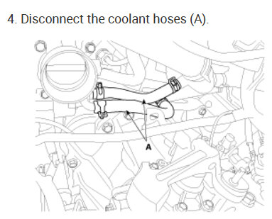

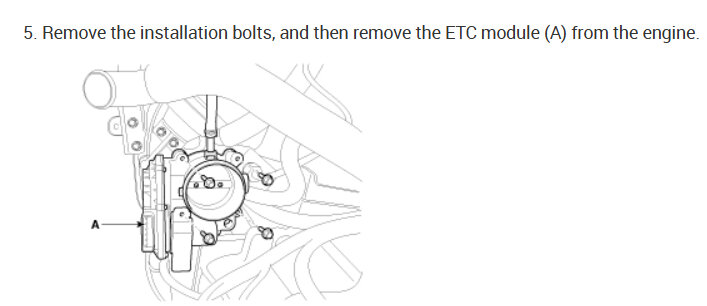

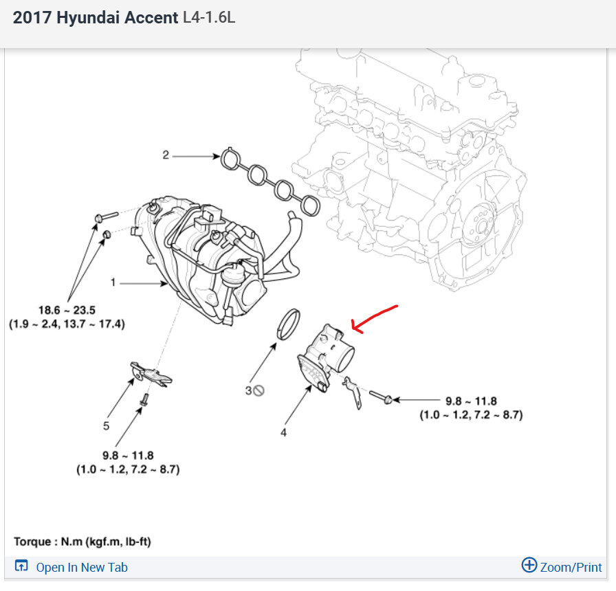

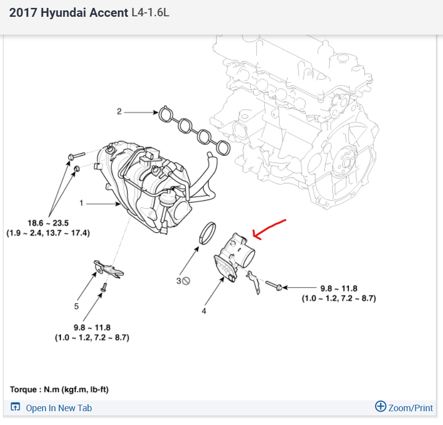

The first codes may cause the other codes BTW. The TPS sensor is inside of the throttle body.
Here is how to change it out in the images below.

Please clear the codes once the repairs are complete. Check out the images (below). Let us know how it goes.

Yes, the TPS affects mixture so if the cylinder is too lean it will misfire. If you want to be sure the engine is not having an issue first, let's do a compression test.
Please go over this guide and get back to us.
