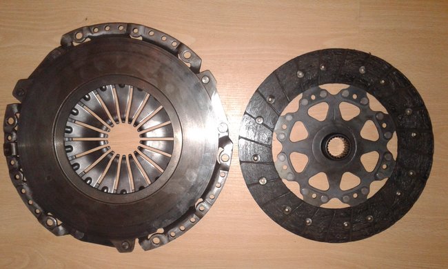

I just had some work done on my car I took off the clutch disc then put everything back together with some difficulty as I couldn't fit back the pressure plate easy like it should be used the car for a few days but I put I put the 1st ready to move soon as I hit the gas I heard a loud sound coming from the engine then I couldn't engage the clutch but the engine is still running. What could it be can anyone help me understand please?

It sounds like you have a pressure plate that is broken. Can you shoot a quick video and upload it here so I can hear the noise? That was we can be on the same page.

Okay, then the transmission needs to come out so we can see what happened it could be the lining of the clutch disc came off.

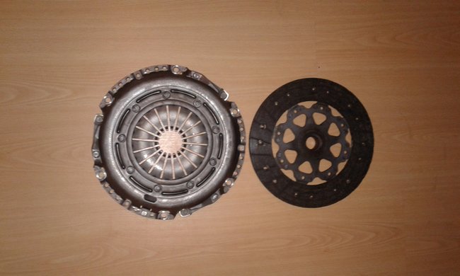

This is what the pressure plate looks like. It was not easy to take it off because its bend. The day I changed the flywheel and the clutch the guy who helped me used to rest the gearbox on the plate.

Yep, a bent flex plate will cause the clutch not to work. After you install the new flywheel and you are installing the transmission do not let the transmission "hang" once it is plugged into the clutch but not not quite bolted up yet.

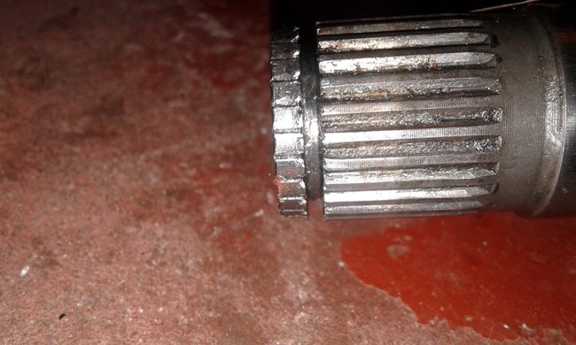

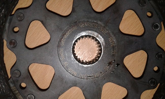

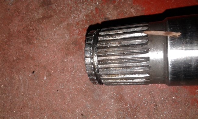

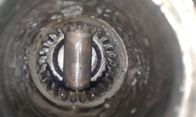

So after putting everything back together I noticed the driveshaft threads are worn out can this be actually the problem with my car.'

I took off the clip missing on the drive shaft end

Yep that is your problem it looks like it may have slipped out during operation causing the problem.
