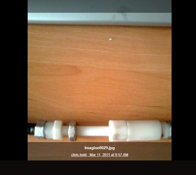

Good evening,
I attached a photo of the adjustment for you to view.
They are both auto adjust and manual adjust. If it is manual, check the picture I posted to see if you have this at the clutch pedal.
