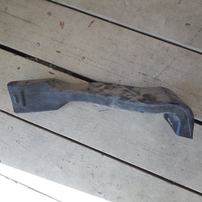

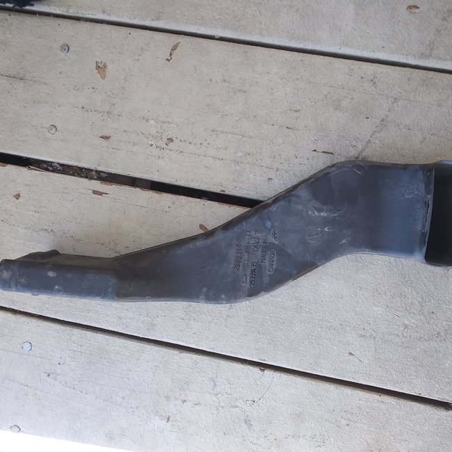

Ken, it is Gabrielle we are doing the oil change the guy found this part he said "floating" in the engine area, not attached. I took a picture of it. I have no idea what it belongs to, do you? Intake duct for?

Now, for the picture you attached. It was found in the engine compartment? Is it plastic and hollow? It's hard to tell for sure, but it appears to the the fresh air inlet tube that would attach to the air filter box under the hood.
Check the air filter box to see if something is missing where fresh air enters the box and let me know.

Hi there again. I took my car back to them this morning in the mechanic on duty there couldn't figure out how to attach that piece. L was asked to come back tomorrow so the mechanic that worked on my car can attach it.
The piece (air duct) attaches to the battery compartment and extends somewhere between the radiator and the headlight assembly. I do not know. Do you?

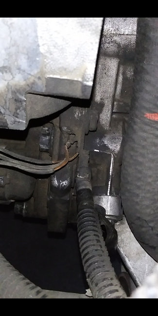

I'm going to send you a video. Tell me what you think?

I will watch for your video. However, am I looking at wiring with about 2 inches of insulation missing?

Yes you are correct. That was not like that before I have shop my car.

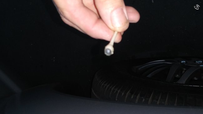

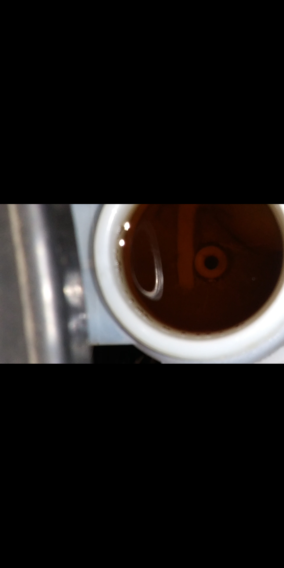

Joe in addition I attached pic of my clutch reservoir. The white line in dirt is where I took Q-tip across bottom.
