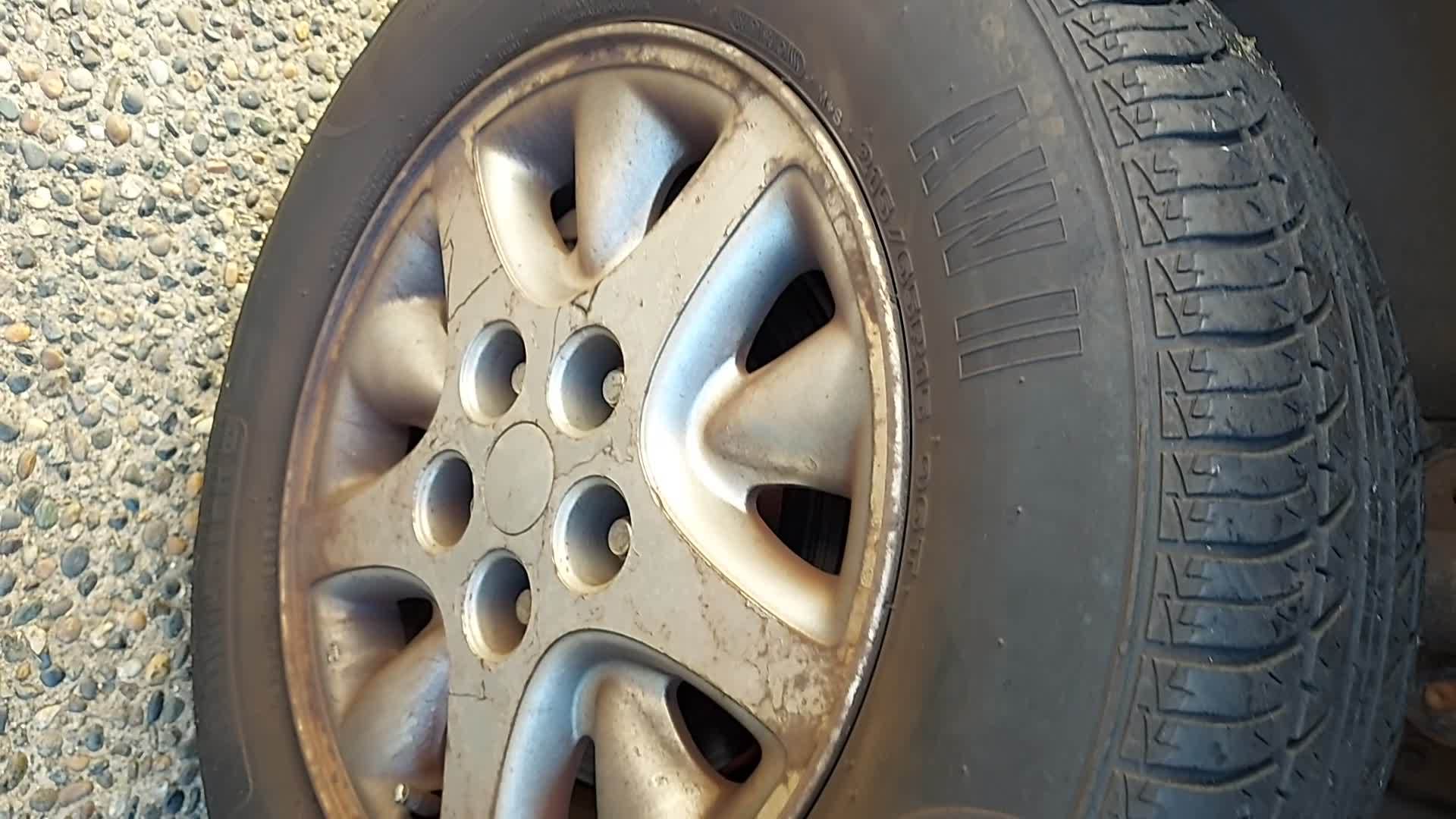

Lately, I observed that at times when I put the van's gear shifter into reverse, I hear a clunk sound, but not when the it is turning.
Suspecting that it might be due to a failing CV axle, I jacked up the van and checked the tires and have noticed that there's a wide free-play (about 4"-5") when manually moved in forward or reverse directions.
Can somebody please advise?

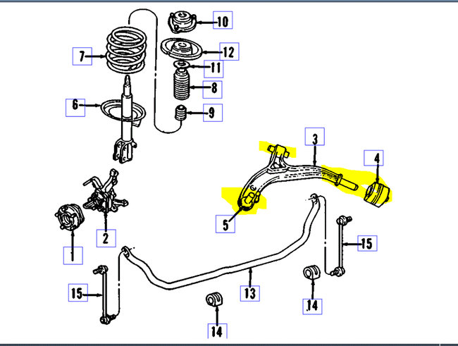

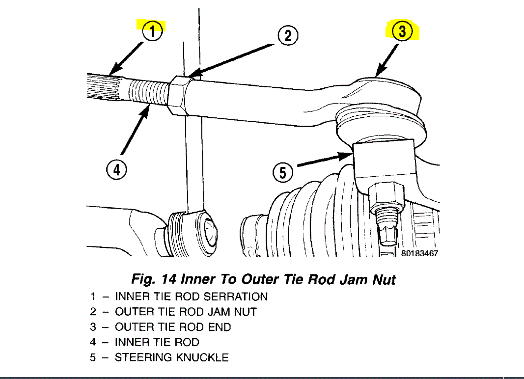

When you say moved from front to rear, do you mean the tire moves forward and backwards or are you shaking the tire when your hands are at 3 and 9 o'clock on the tire?
I'm asking because this is two very different issues. If you chafing the tire, it sounds like an issue with tie rods. If it moves forward and back, then it is a control arm issue.
I attached two pics below. The first one shows the control arm bushings that need checked and the second shows the inner and outer tie rods. Check these areas for play.
Also, if you could video what is happening and upload it for me to see, it would help. I wouldn't drive it until we determine what is happening and it's repaired.

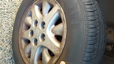

REDCRU777
  • 84 POSTS
Hello Tom and Joe,
Many thanks for your swift reply.
Attached is the video that will more accurately present the problem I'm talking about re the tire "freeplay".
You can also hear a "loose" metal sound as I move the tire forward/backward.
I hope this will help you determine the problem.
Thanks again.
Rey
Sunday, August 9th, 2020 AT 7:38 AM
  • 110,192 POSTS
That rolling back and forth is normal. The tire will turn. The noise I hear sounds like the play from the transmission (which is normal) is stopping it.
If you were to place your hands at 3 and 9 o'clock and wiggle back and forth, is there play? The same with your hands at 12 and 6 o'clock?

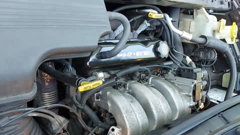

If there is no play, then put the car down. Open the hood and have a helper start the engine and shift from park to drive and then reverse. Does the engine tilt excessively?
-1
Sunday, August 9th, 2020 AT 9:58 PM
REDCRU777
  • 84 POSTS
Thanks for this info Joe.
The tires are okay, there's no wiggle.
Re engine, I didn't notice a severe tilting (please see attached video).
But this am, as I was slowly backing up on/off on an inclined parking, there were loud clunk sounds coming from the tires/CV area, as if a gear is jumping and sounds like it may give way anytime.

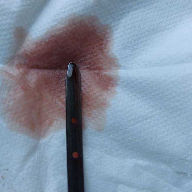

REDCRU777
  • 84 POSTS
Thanks for this input Tom.
The sound isn't consistent, there are times that it doesn't click, but it's more prominent when the van is going either from park or drive to reverse on an incline surface most specially if it's steep, maybe due to more pressure is exerted on the transmission to move the van.
Re transmission oil, I just had it changed less than a year ago (please see attached pic).
Fyi.
Tuesday, August 11th, 2020 AT 2:34 PM

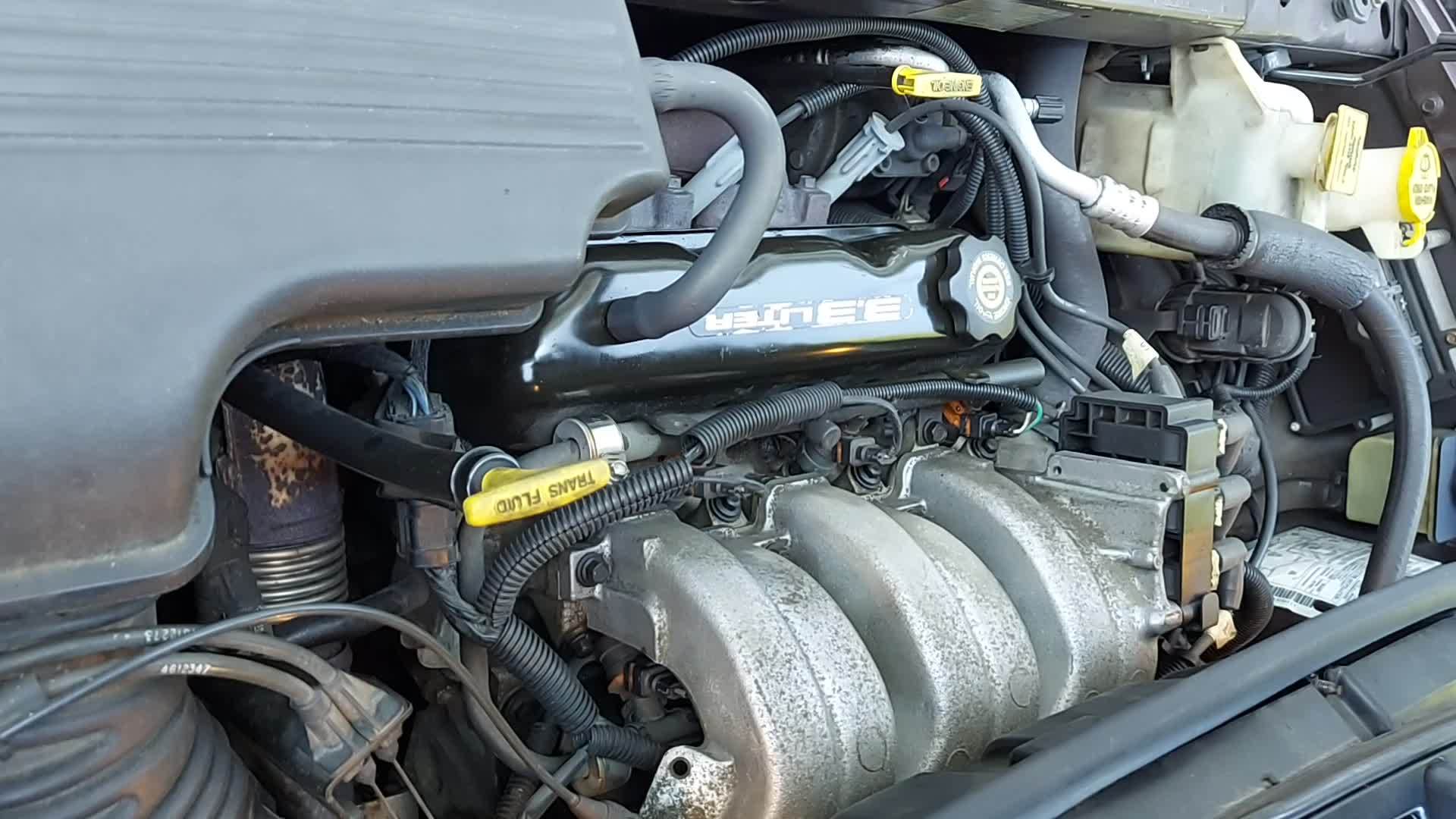

Hi Rey,
Well if your not talking about that clicking sound I hear and you actually getting a full scale knock or bang then its got to be one or more the motor and/or transmission mount. The amount the motor is moving at idle to me is more than it should. Most of the time when a mount goes bad it you can get your eyes on it. (sometimes they are buried pretty good behind things). will show ripped or torn rubber sometime you might see a powderized metal around the area from metal on metal chipping away it might even be rust colored. Get a good flash light and do a thorough visual inspection of all of them especially the one on the firewall side and on the radiator support. I bet its the one down by the muffler pipe underneath at the firewall.
This guide can help
You probably going to need a jack. Make sure you set the emergency brake and use jack stands before you get under the car. Set the jack stands where it going to catch the frame of the car fully.Do you have access to those things. If your not sure about where to put the jack stands and how and where to jack it up from do not get under the car. If you can, while your under there looking when the car is cold try to move the muffler pipe it may be hitting something when the engine is moving. If you have been running the car wait until it cools or don't touch the muffler pipe.
Let me know what you find.
Tom

  • 110,192 POSTS
The exhaust hitting is very possible. However, I don't think it's a motor mount issue simply based on your video. I would like to ask for Tom's input on this. Tom, do you feel it could be in the differential? I've seen issues with the differentials on these. However, it us not a click but rather a clunk.
Friday, August 14th, 2020 AT 12:41 PM
REDCRU777
  • 84 POSTS
Thanks for this message Joe.
Actually It's not the exhaust. The van runs smoothly, except for that clunk sound that happens at times when I'm backing up and is more prominent when backing up on a steep surface.
Fyi.
Rey
Friday, August 14th, 2020 AT 2:44 PM
  • 110,192 POSTS
Rey, I may have already asked, but is it possible for you to record it and upload the sound for us to hear? The motor didn't move much at all in the video; that's why I don't think it's a mount. If you pressed the throttle a slight bit when doing the same test, it may show something different.
