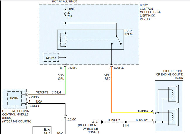

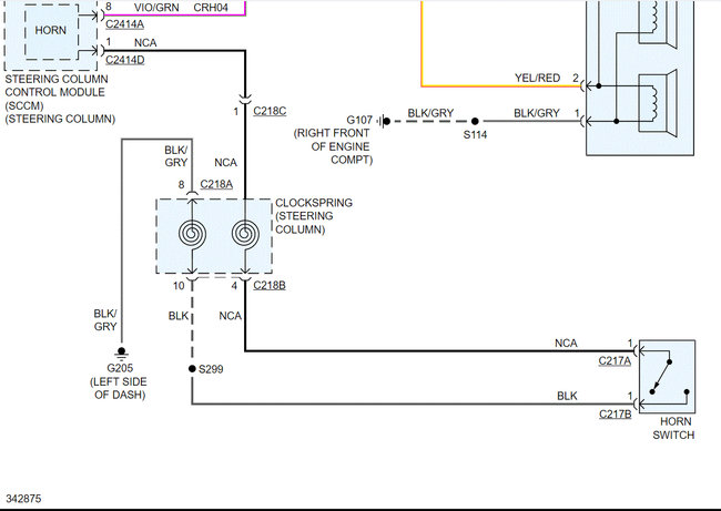

I'm having an issue with my horn not working. I've check the fuse and it's good. I even tested the horn by putting 12v to it and it works. I believe the clock spring is the issue but I need the wiring diagram and connector pinout to check it.

Chances are the clock spring is bad. It really isn't an uncommon problem.
If you look below, I attached the wiring schematic for the horn, which includes the clock spring info.
I had to cut the schematic in half to make them readable for you. However, I did overlap them so you can follow from one to the next.
