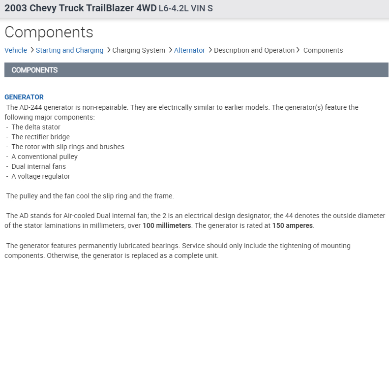

I was reading a post on this same noise and was wondering if this could be a drain on the battery? I just replaced my battery not 5 days ago and I had to get a jump last night. I made it the 1.7 miles home and it shut off in the driveway and would only do the clicking thing when the battery is drained. I just used another new battery and it cranked right up but then I noticed the clicking.

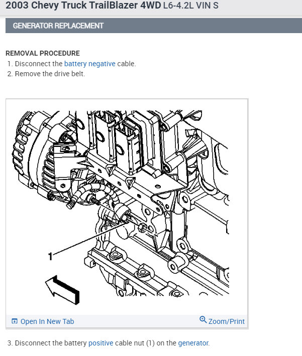

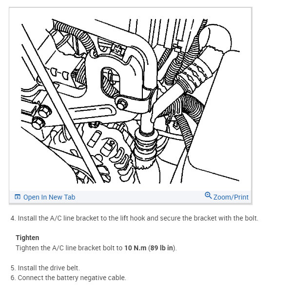

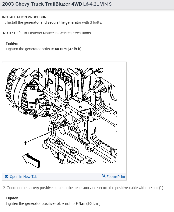

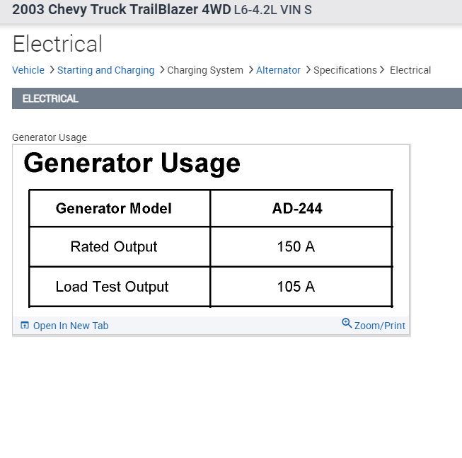

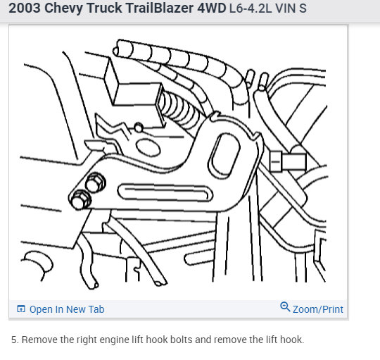

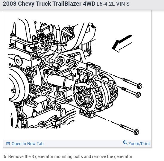

Was your battery light come on while driving?
It almost sounds like a bad alternator. When an alternator goes bad it will drain a good battery and will stall when the battery is depleted and as you come to a stop.
The clicking could the starter relay or the solenoid when you try to crank.
Testing the alternator could be a good step.
Here is a helpful video:
https://youtu.be/Z-p4dMJUpUw
The noise from the rear interior panel, if you can upload a video of the noise, it will be helpful.
