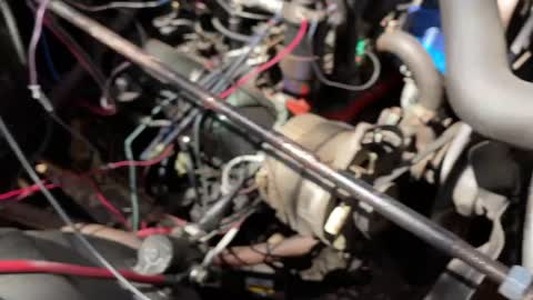

Hello, a couple months back I had several knowledgeable folks helping with my vehicle, 304. I have finally got it running and rebuilt the carburetor, (motor craft 2-barrel 2100). New points, rotor, and cap. It runs if I keep feeding it gas and eventually on its own for a little bit. While it is running it’s surging and missing. Slightly turning the cap does nothing. Unplugging the booster hose from the back of the carburetor revs the motor to a high idle no longer surging. Smoke fuel smell and smoke coming out of carburetor. And now a slapping not knocking doing from bottom of motor. I really need some help here. Thanks

No problem, can you please shoot a quick video with your phone so I can hear the noise in the engine? That way I can tell for sure what's going on. You can upload it here with your response. Also, if you unplug the booster and the engine runs better the booster is no good.

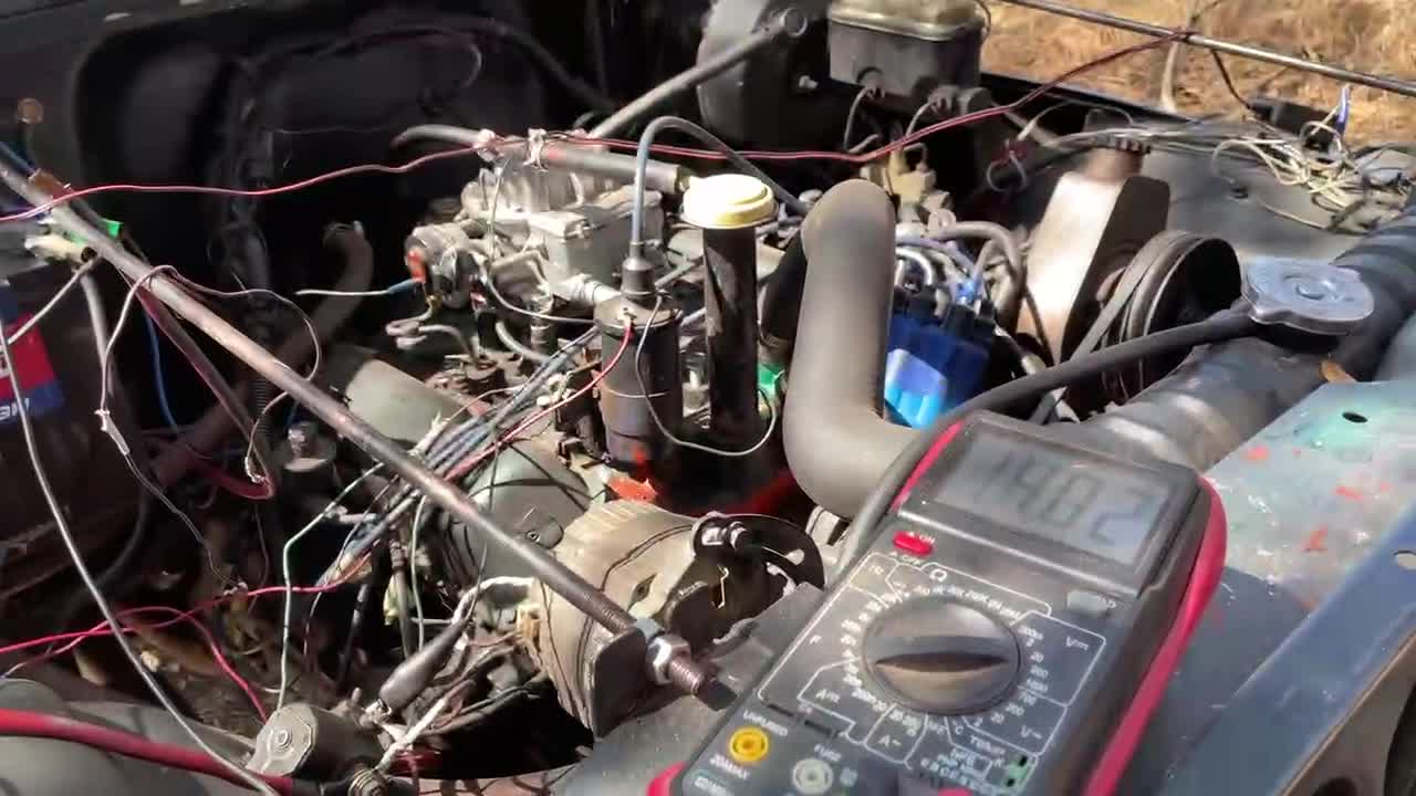

It looks like the battery is weak or the battery cables are bad, also make sure there is a good ground from the battery to the engine and then to the frame. Thanks for the video, it really helps us get to the problem.

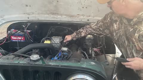

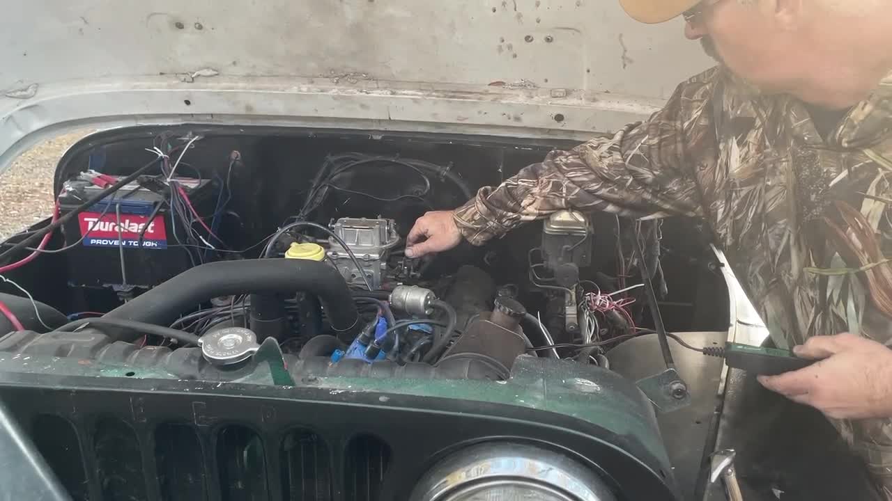

I got my cj7 back from the mechanic and wasn’t able to do anything with it besides suggest I get a new carb. I took the motorcraft 2100 off and found the two brass tubes on the venturi, I believe they are called dwell tubes. They are both cracked. Tried to solder and braze but no luck so I put chem resistant jb weld on just to see if it ran better. Here is a video from today.

The video was good, it looks like you have a vacuum leak or the power valve diaphragm that is bad in the bottom of the carburetor toward the front, if you remove the four screws from the cover and you see gas the valve is bad, this is a very common problem and a cheap fix. Check for vacuum leaks when cold only.
