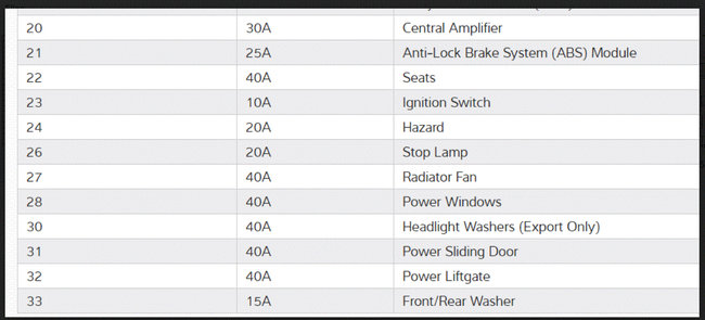

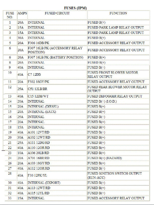

I have a fault for fuel recirculation high voltage. I have replaced the fuel cap and after research believe it to be the EGR valve now I need to check the fuses.
Tuesday, November 10th, 2009 AT 2:26 AM
  • 110,194 POSTS

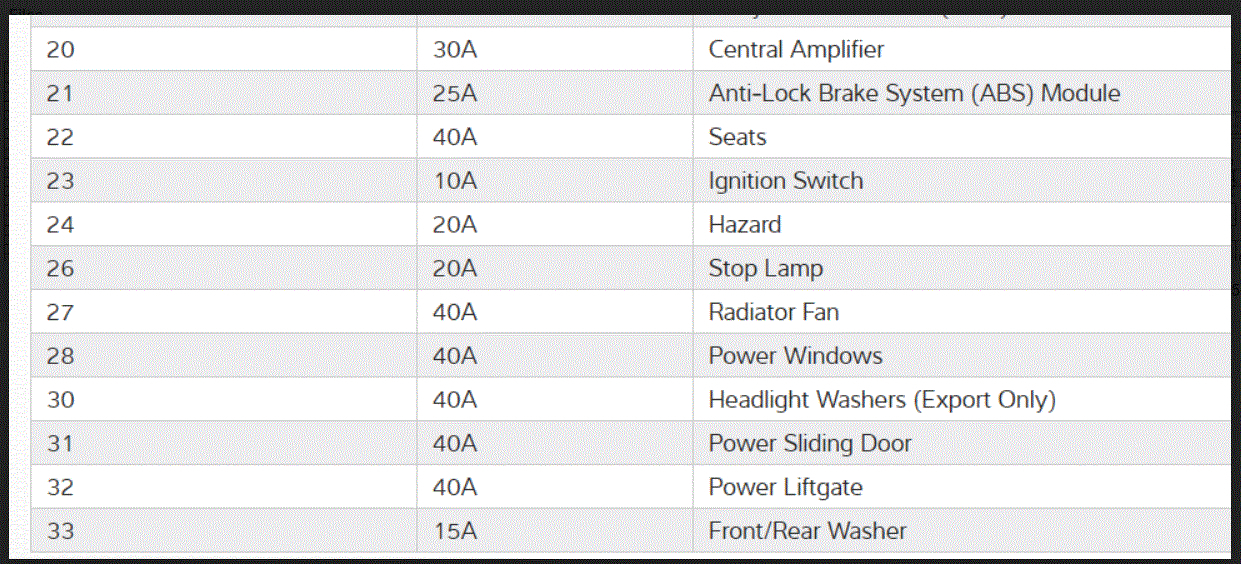

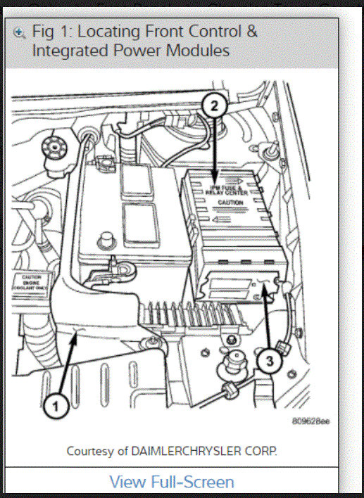

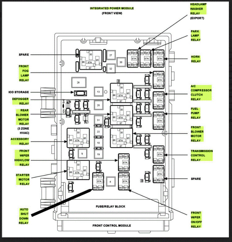

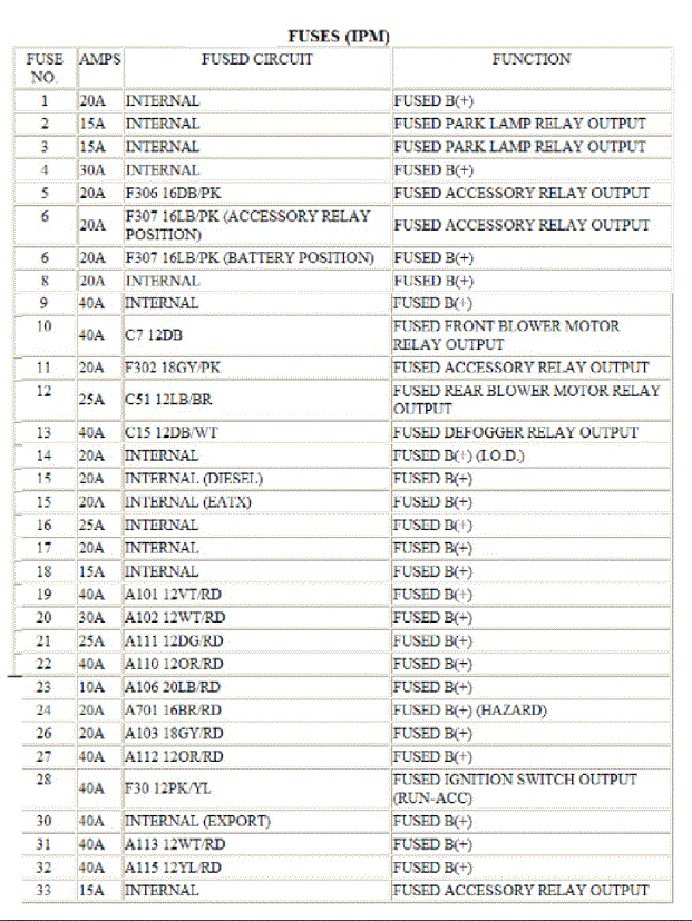

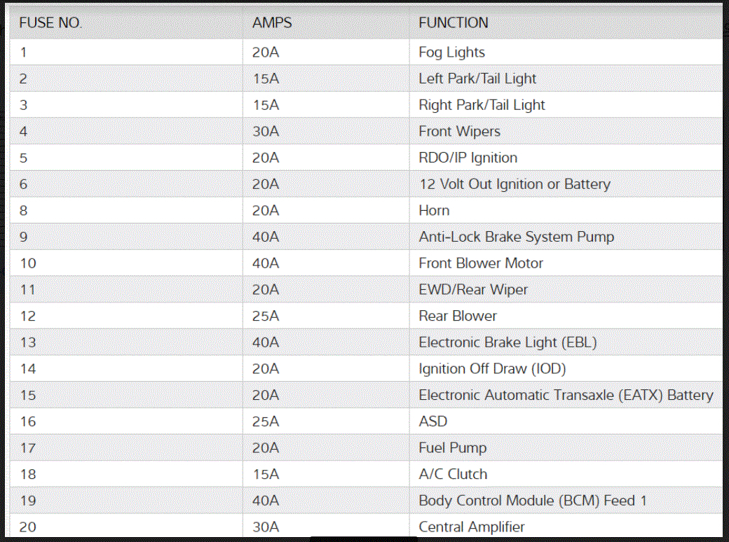

If you look at the attachments below, they provide the fuse box orientations and what each fuse is for.
In addition to just checking a fuse, make sure there is power to it. A fuse may be good and not be receiving power.
Here is a link that you may find helpful when testing:
I hope this helps. Let me know if you have additional questions.
