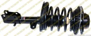

Replaced sway bar bushings and lower control arms. Still clunks when go over bad crack in road. Going to try sway bar links. Garage said struts were fine. Tie rod ends may be worn, as never changed, but dont think they would clunk like that? What think?

https://www.2carpros.com/forum/automotive_pictures/99387_getimage_1.jpg
for about $300 you can buy fully assembled set of front struts no need for tool (spring compressor)

If you are to go with the new fully assembled strut you would have a new strut, coil spring and strut mount and there would be no need for any special tools
set of two complete struts as shown in the picture (above ) is about $300

If replacing just the strut you will get just the strut in the box and any thing else would need to be ordered (should be available and no special order is needed )
if buying a fully assembled strut all should be together all you have to do is remove out the car and open the box, install
and should have it aligned after

Never did this before. I think I would buy the completely assembled strut and mount in hindsight. It was a pain assembling with the spring, even using the compressor. After installed on Van, found out there was a "special tool" not mentioned in instructions that came with the struts that I needed to secure the piston rod so I could properly tighten the upper mount nut. It still clunked, so I brought to a shop that had the tool and they charged me 2.8 hrs to take the struts back out and tightne the nuts properly. Easy money. I used antiseize on all bolts and it is all new stuff under there. But I will have a sweet ride at the end of this journy, at the cost of an entire new front end job.

Used a trick from Haynes manual - 13/16 sparkplug socket with a 10mm 1/4 drive socket inside to hold the strut piston rod while tightening the nut. Worked like a champ.
Bad news: I cracked the windshield trying to get off the wiper arm so I could get access after removing rain tray and wiper motor try assy.
This nut job took an hour once I had the right tools. Lots of screws to get the trays off.
