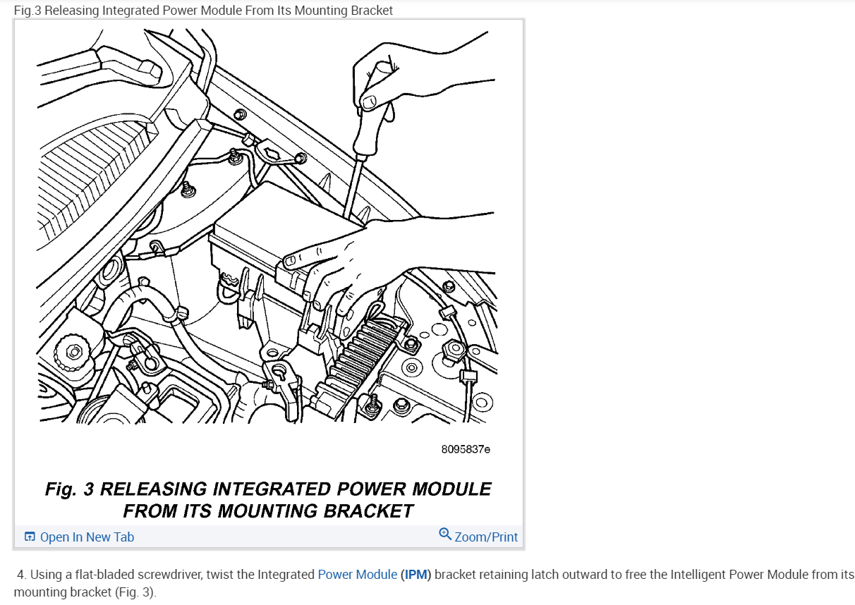

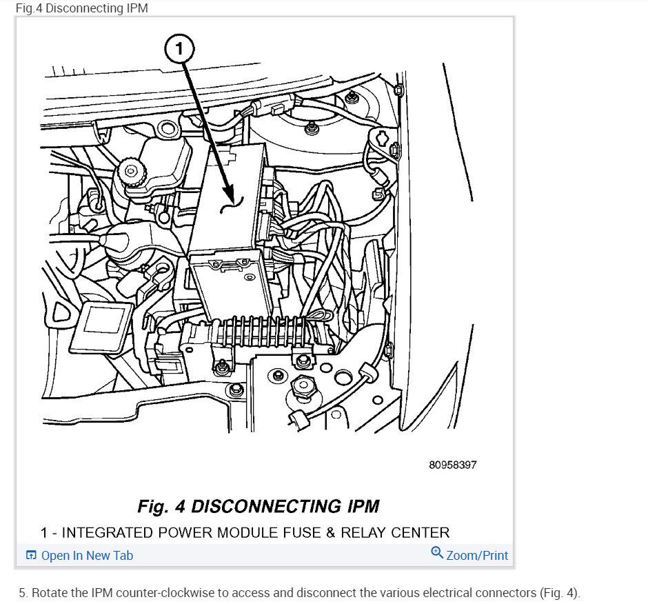

The car wont start when the key is turned. Lights dim, speedo and tach needles make a cycle from 0 to max all the lights are dim for several minutes but then recover to full brightness. Only happens when the key is turned in the ignition.
Saturday, March 20th, 2010 AT 5:37 AM
KEN L
  • MASTER CERTIFIED MECHANIC
  • 55,499 POSTS

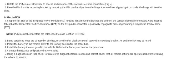

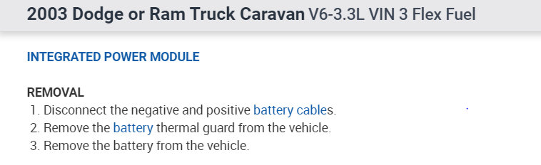

Yep, this happens when the TIPM goes out which is common but fear not it is easy to replace because it does not require any programming it is a plug and play thing. Check out the diagrams (Below). Please let us know if you need anything else to get the problem fixed.
