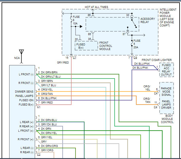

I am looking for a radio wiring diagram for my rear driver side tail light, which is causing a short to my instrument cluster every time I place my turn signals. My car was recently crashed in the rear and that light was replaced. After I opened the rear light and exposed the wiring there was a new but used wiring harness but 5 out of the 6 wires coming from the inside of the car were spliced together leaving 1 wire where no where to go and I am trying to find out which wire is what by their color codes. Can someone provide me with a diagram for my vehicle?

Here is the information you requested. Here is a tutorial for you to look at on how to test automotive wiring:

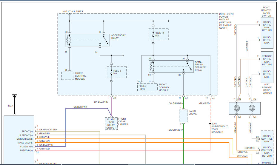

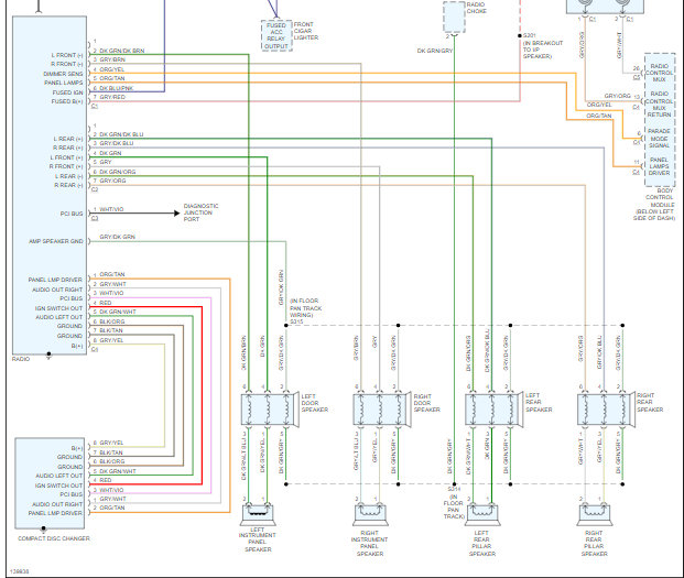

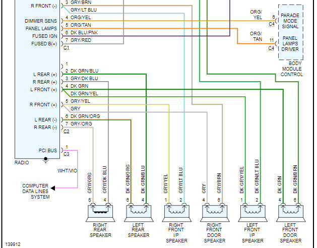

I've attached the audio system wiring diagrams below. Not sure which one of the 2 systems being either Base or Premium option are in your car so I've included both. I've cut the pictures in half so you can view larger. Hope this helps and thanks for using 2CarPros.
