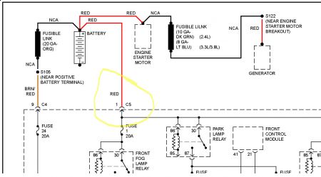

Okay let's back up a second.
There is no power at all. Turning the headlight switch on will not allow the lights to work for example.
The security light is on solid?
at all times?
IS the battery fully charged?
Use a volt meter (multimeter) to make sure it is.
Set the multi-meter to milliamps, what is the draw on the battery?
https://www.2carpros.com/forum/automotive_pictures/30961_11c_1.jpg

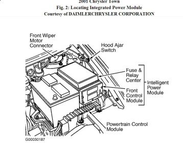

Check for power getting to the Intelligent power module.
In this componenent (ipm) you should check fuse #14, 15A. this is the iod fuse
https://www.2carpros.com/forum/automotive_pictures/30961_1c_2.jpg
