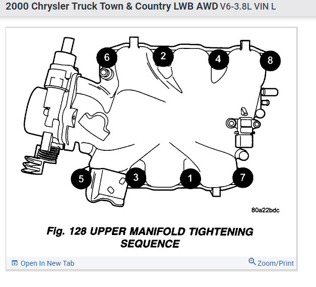

lower intake manifold torque sequence
2000 CHRYSLER TOWN AND COUNTRY
108,000 MILES • 6 CYL • FWD • AUTOMATIC
2STROKEKILLS4STROKE

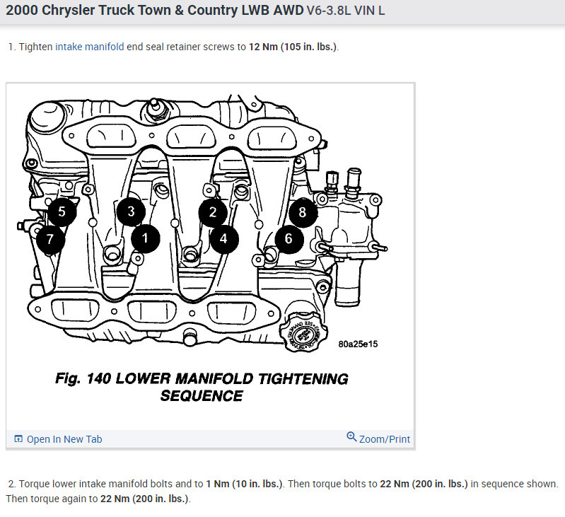

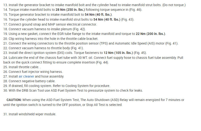

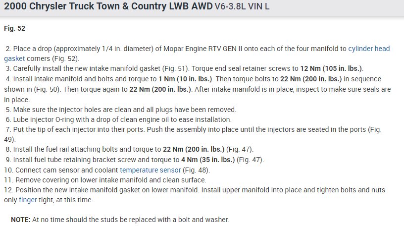

intake manifold torque specs. How do I change out the intake manifold gaskets?
Jan 17, 2009 at 12:14 PM
SQM
  • 6,383 POSTS

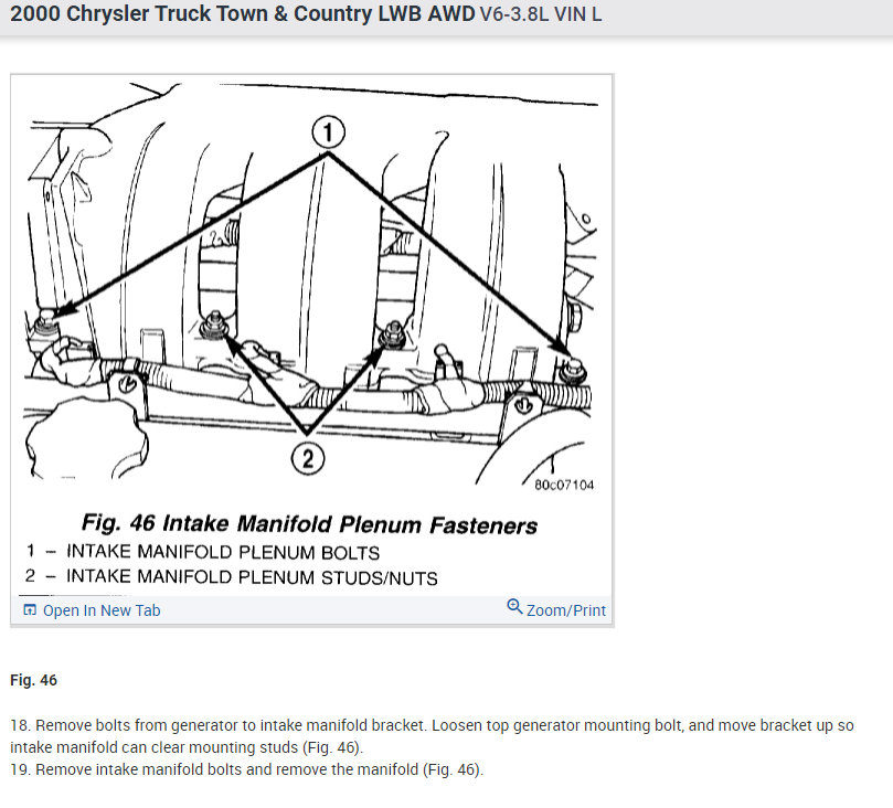

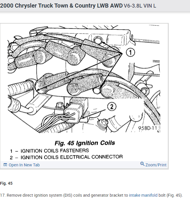

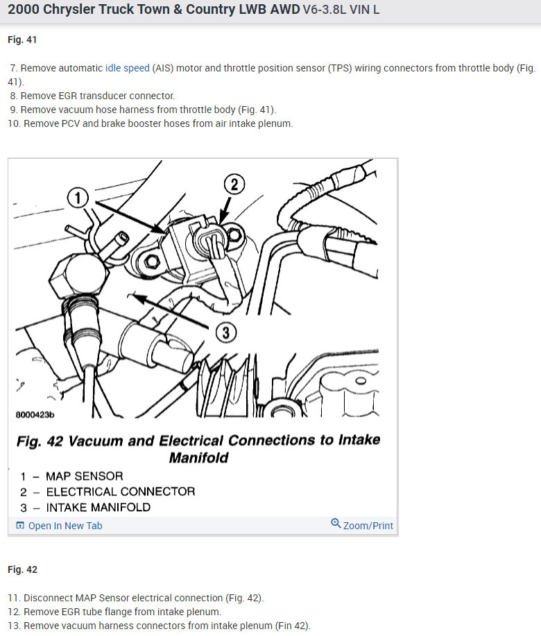

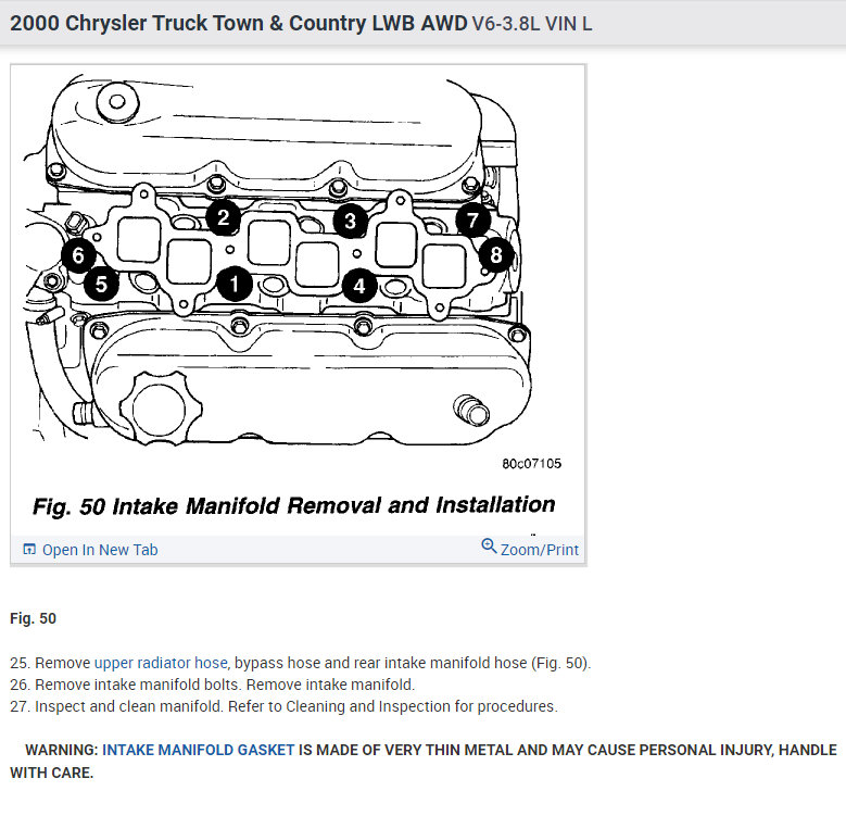

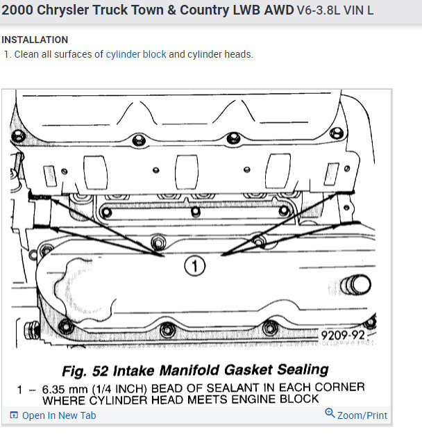

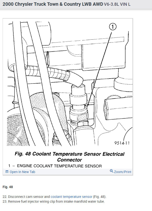

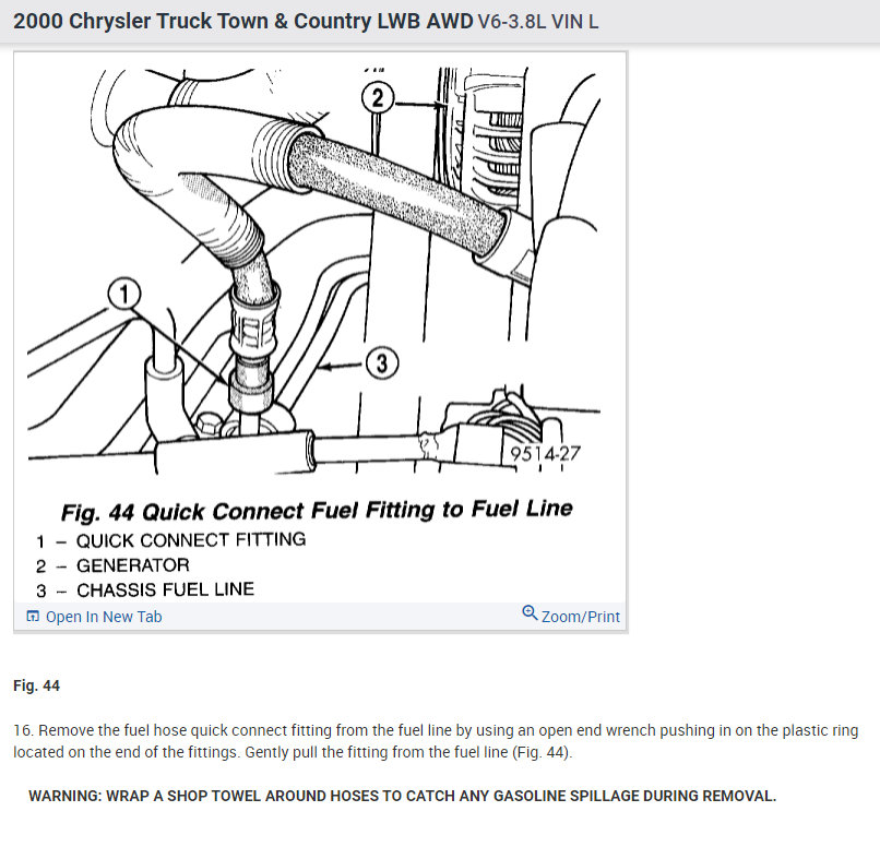

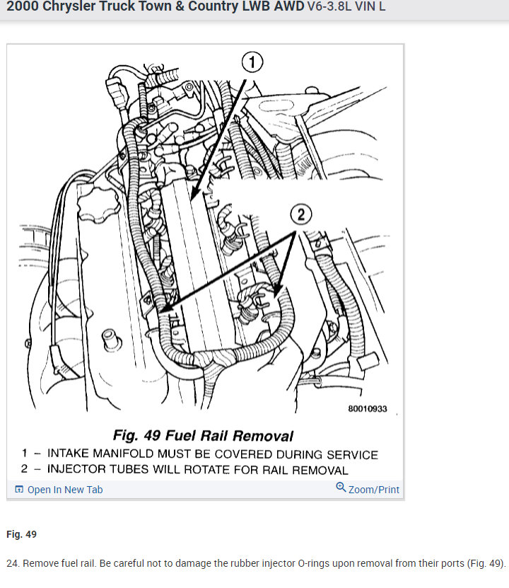

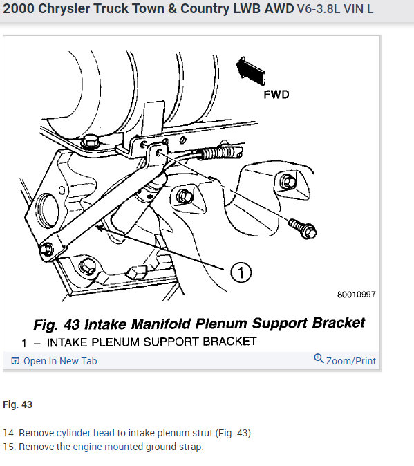

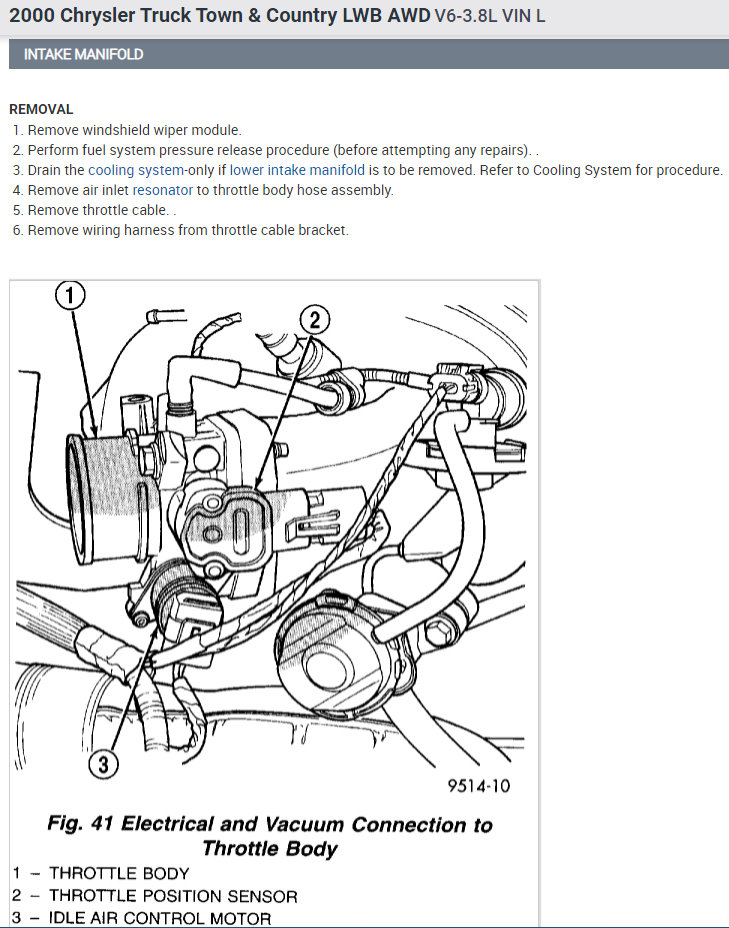

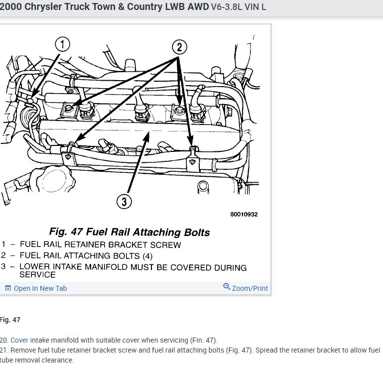

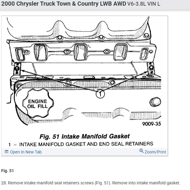

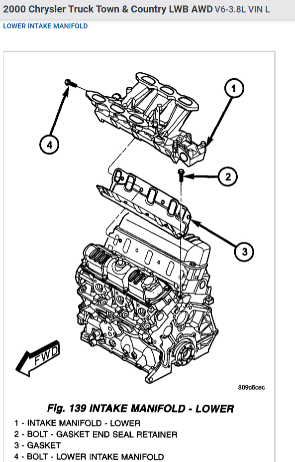

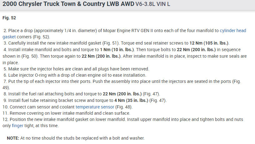

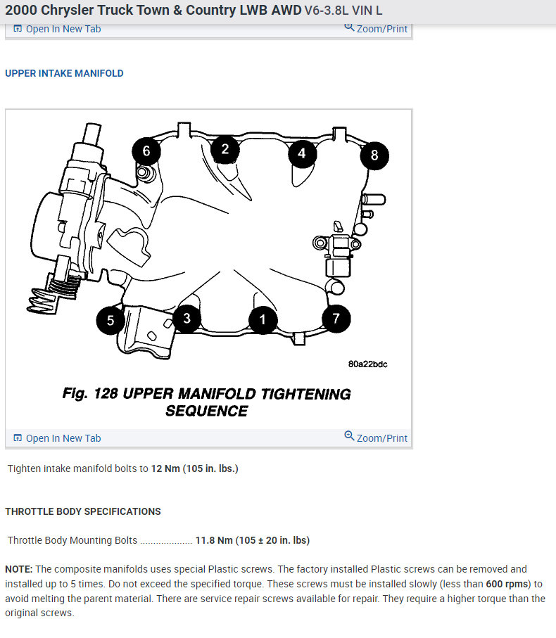

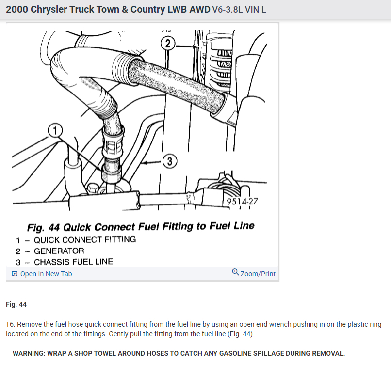

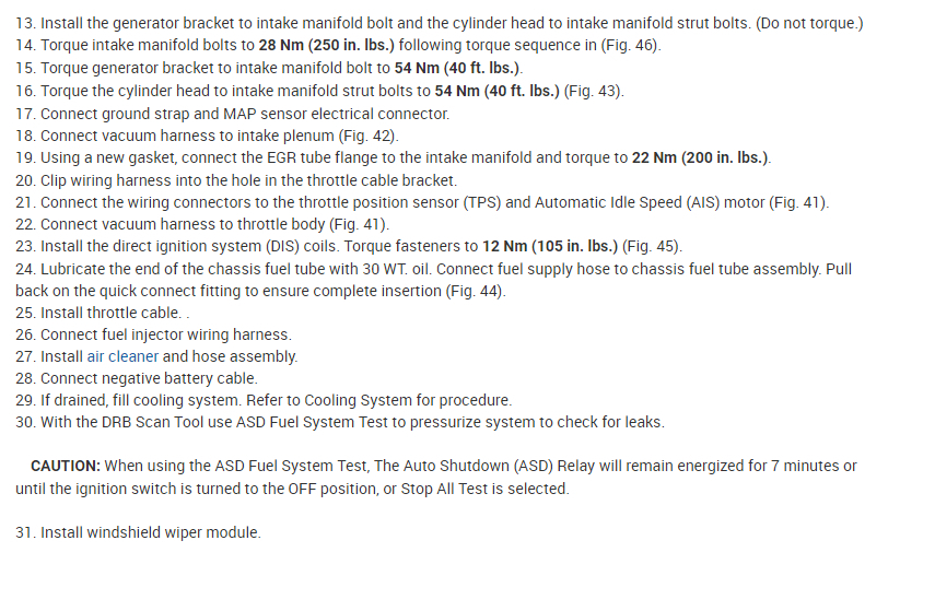

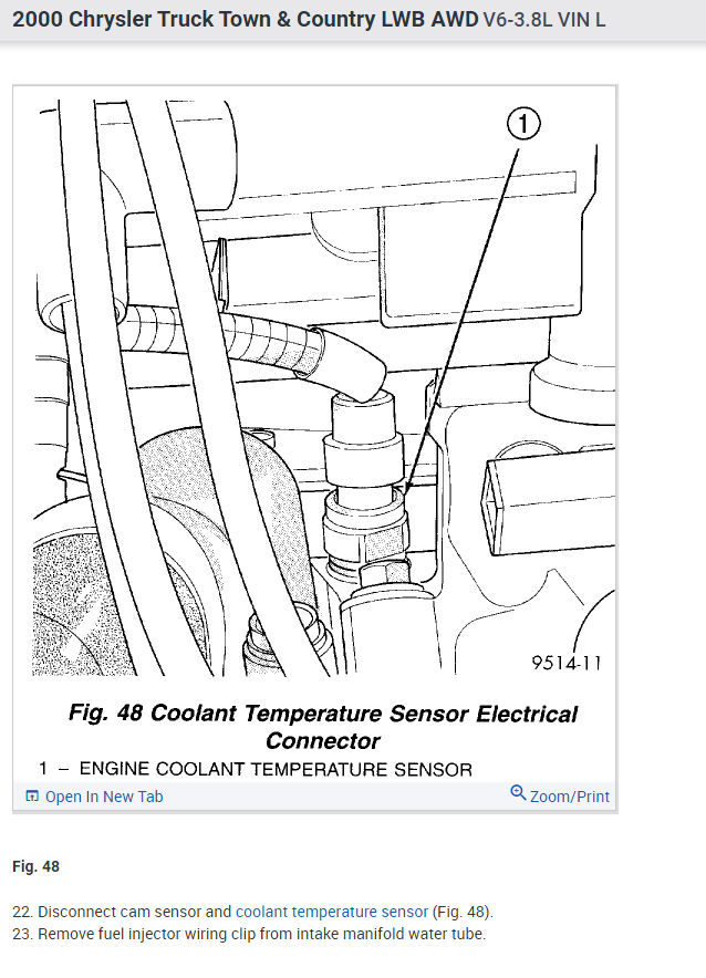

In order to access the intake manifold you will have to remove few items. You will have to remove the throttle body, the wiper arm/motor assembly and few other items.
As you know it is crucial to have the correct torque and torque sequence for a successful intake gasket replacement.
https://www.2carpros.com/articles/replace-intake-manifold-gasket
See below for the complete intake manifold replacement procedure, including the torque specifications and sequence.
