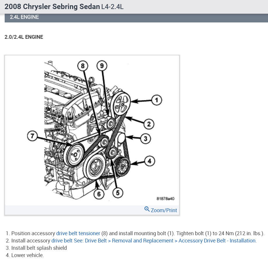

i need a drive belt routing diagram for a 2008 chrysler sebring 2.4 L engine

Here is a guide to help you change the belt out with a diagrams to show you how the belt routing goes.
Cheers
