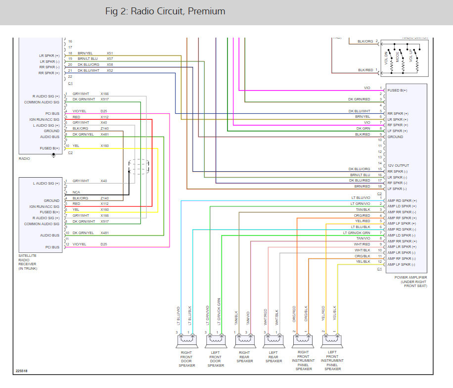

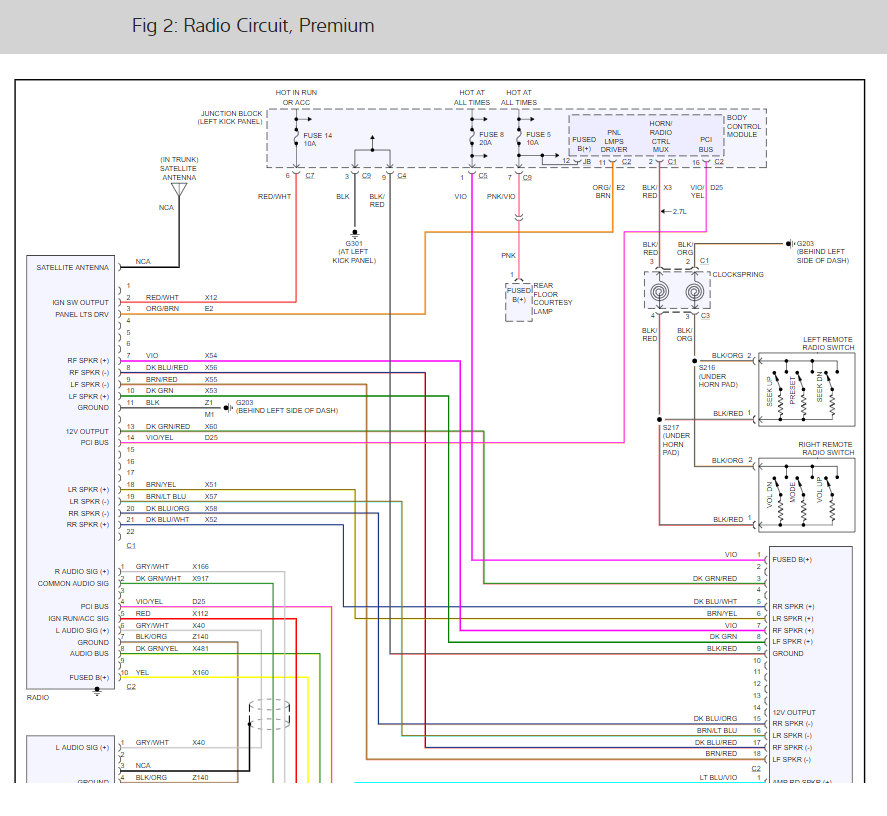

Radio wiring diagram
JOE4KING
  • 2006 CHRYSLER SEBRING
It started out intermittently but has got increasingly bad. The lights for my dash, mostly the odometer and gear indicator lights, flicker. Sometimes they just flicker a little but when they flicker alot then my stereo shuts off and comes back on. This gets worse if I hit the accelerator. Doesnt seem to matter the weather( thought maybe moisture or something) or the road conditions (does not do it more frequently on bumpy than on smooth as thought maybe exposed wire or something) I need the radio wiring diagrams so I can install a new unit.
Monday, April 27th, 2009 AT 8:42 AM
6 Replies
CARADIODOC
  • 34,485 POSTS
Next time it acts up, try wiggling the ignition switch. There have been a lot of problems with burned contacts and overheated terminals with a melted connector. Here is the radio wiring diagrams as you requested. Check out the diagrams (Below). Please let us know if you need anything else to get the problem fixed.

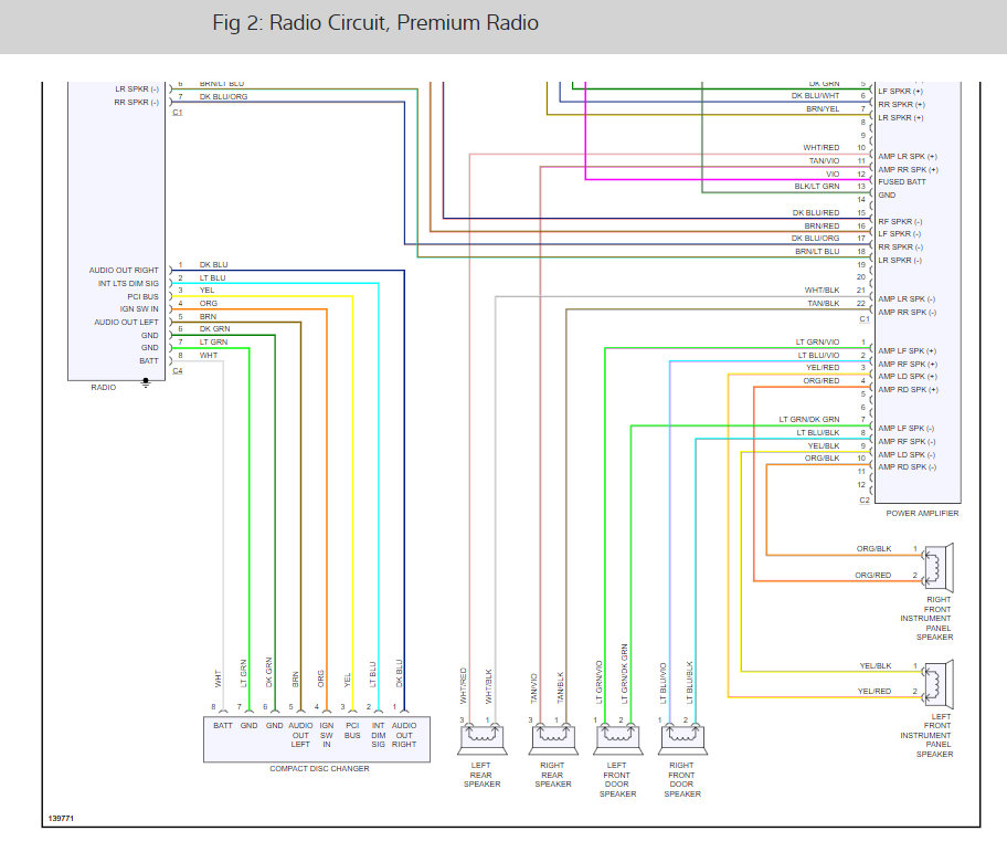

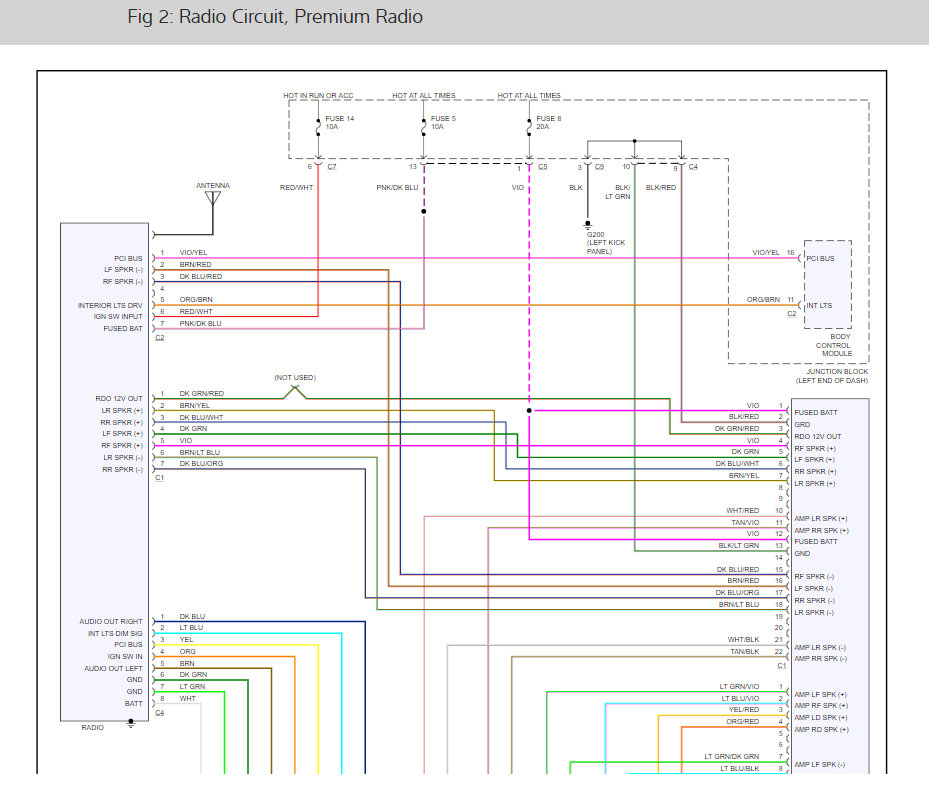

I am trying to hook up my new Pioneer deh 2500ui to my chrysler 2001 sebring sedan but cant get power to it. I went back to make sure all the wires are connected right but then I realized that the online schematics has color for wires I don't have in my original car wiring. For example, The main power cord in the Schematic is supposed to be Orange/Black while mine is really Orange/Brown. I also do not have a Green/White and I have a Red/White which isn't on there at all. Any help please!
Wednesday, October 23rd, 2019 AT 5:39 PM (Merged)
HMAC300
  • 48,601 POSTS
You do know they make adapters for aftermarket radios that just plug and play and are available for around $20 but eh single arrow which is red and white wire is hot with ignition switch and double arrow is hot all the time.
This guide can help with the radio wiring diagrams below.
