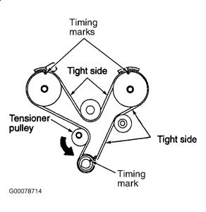

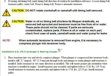

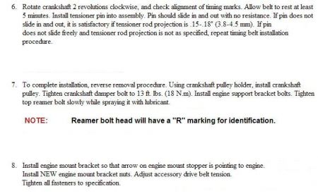

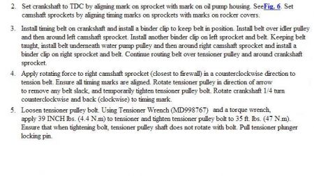

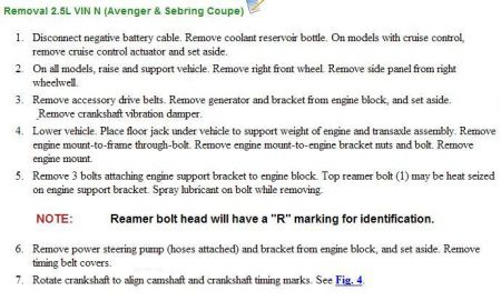

My daughter's 2000 Chrysler Sebring has a broken timing belt. How is it changed? Is it a difficult task? Does the motor have to be pulled? The dealeership wants upwards of $600 to fix it and neither she nor I have jobs right now. Trying to save a buck.
updated 7-27-09
The Sebring is a Coupe.

https://www.2carpros.com/forum/automotive_pictures/261618_Noname_736.jpg
FIG. 4
https://www.2carpros.com/forum/automotive_pictures/261618_4_12.jpg
https://www.2carpros.com/forum/automotive_pictures/261618_Noname2_191.jpg
https://www.2carpros.com/forum/automotive_pictures/261618_Noname3_66.jpg
FIG. 6
https://www.2carpros.com/forum/automotive_pictures/261618_6_2.jpg
https://www.2carpros.com/forum/automotive_pictures/261618_Noname4_39.jpg
