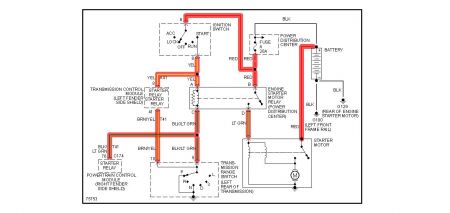

My 1996 Chrysler LHS will not start or even attempt to rollover, already changed electrical module in steering column and changed starter/solenoid. Still will not attempt to rollover, there are no dtc codes stored in the computer and wiring seems to be in good working condition-still getting dash lights and trac cont lights flicker when key is turned, does anyone have any ideas about what to do next?

The car is not turning over at all, I have now tried the ignition module in the steering column, starter/solenoid, starter relay, checked for voltage at the alerternator and checked for voltage at every other wire coming off of the battery, is there a sensor somewhere in the starting circuit that I am missing?

Check and test the park and neutral switch and ignition switch

I have the haynes manual but cannot find the actual position sensor, the manual says that it is on the powertrain control module but the people at haynes say that its on the tranny, but I cannot locate a single part on the transmission that is like the part I got (neutral safety switch is what kragen has the name as), can you shed any light on this for me? Thanks.

Inspect and test the transmission range switch located left rear of transmission
https://www.2carpros.com/forum/automotive_pictures/12900_trs_3.jpg
