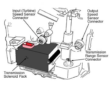

wondering my RPMS do not shift no more.
they go up but never return down while driving
what could be wrong, and how do I fix it?

And you have check engine light on !?!?!?
possible tranny solenoid pack
need to check for codes
need manual CHECK IT @

thank you for your reply, No engine light is on,
its like driving a standard, and keeping it in 1st gear.
There is no delay putting the van in drive or going backwards

Most common
is the tranny solenoid pack
I would have it scanned for TCM codes
