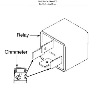

Symptoms indicates it is related to the fuel pump so we can forgo the others for now. We need to get the fue pressure up first.
CHECKING FUEL PUMP
1.Turn ignition off. Disconnect fuel pump relay. For fuel pump relay location, See Fig. 51. Using scan tool in voltmeter mode, check voltage on fuel pump relay connector fused ignition switch output circuit. See
Fig. 35. If voltage is more than 10 volts, go to next step. If voltage is 10 volts or less, repair open fused ignition switch output circuit.
2.Install a substitute relay. Attempt to start engine. If engine does not start, go to next step. If engine started, replace fuel pump relay.
3.Reinstall original fuel pump relay. Disconnect fuel pump harness connector, Inside Trunk On Left Side, Near Base Of Shock Tower. Turn ignition on. Using scan tool, actuate ASD fuel system. Using scan tool in voltmeter mode, check voltage of fuel pump relay output circuit at fuel pump connector (harness side). If voltage is more than 10 volts, go to next step. If voltage is 10 volts or less, repair open fuel pump relay output circuit.
4.Turn ignition off. Using scan tool in ohmmeter mode, check resistance of fuel pump ground circuit at fuel pump connector (harness side) Black/Light Green wire. If resistance is less than 5 ohms, replace fuel pump. If resistance is 5 ohms or more, repair open fuel pump ground circuit.
https://www.2carpros.com/forum/automotive_pictures/192750_FuelPumpRelay96CirrusFig35_1.jpg
https://www.2carpros.com/forum/automotive_pictures/192750_FuelPumpRelay96CirrusFig51_1.jpg

Checked all of that. The last step was the one step that went wrong. At the wire harness the ground was between 6 and 7. We are not sure how to fix this.

If the ground circuit has 6 or 7 ohms, that means the grounding point is either loose or contaminated. Check the grounding point at center of deck lid opening, I am not sure where that is.

Regarding the ground, use another wire and splice it to the ground wire and find a sutable grounding point to test if it works.

Yes, seems the fuel pump is the cause of the no start. Get the fuel pump ground circuit secured and retest.
