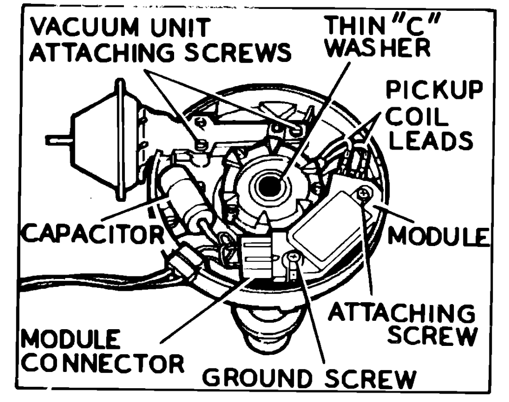

1. Disconnect wiring harness connector at side of distributor cap and remove distributor cap.
2. Remove rotor and disconnect wires from module terminals.
3. Remove two mounting screws and remove module, Fig. 13. Two types of H.E.I. wiring harness are used, Fig. 14. The second type is a wiring harness, connector and capacitor which is serviced as an assembly.
4. Reverse procedure to install. Prior to installation, coat bottom of new module with dielectric grease (furnished with new module) to aid in heat transfer into distributor housing. Failure to apply grease will cause excessive heat at module and premature module failure.

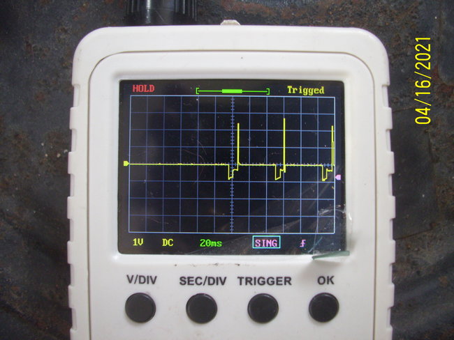

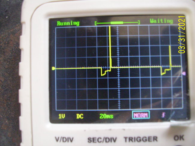

Thank you, you may be correct, however I would question that the module or the pick-up are bad if I'm getting signal (blinking trouble light) to the coil primary (as well as 12V DC)? Before I go to extremes like removing the module and or the pick-up, I have ordered a mini-oscilloscope , I'm thinking of actually looking at the module output waveform to verify if the module/pick-up are outputting properly?

Btw, the module was the problem (even though it appeared to have signal to the coil, would flash the test light, and even run a hand held tachometer.) Replaced it and got full HEI spark. You can see old (failed) module output during cranking in the first pic, vs new module output during cranking in the 2nd pic. Thanks
