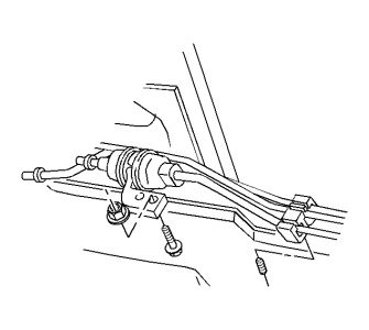

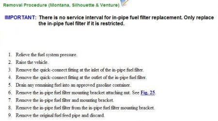

1999 Chevy Venture 149000 miles
Could someone give me step by step dummies guide directions of how to change a fuel filter in a 1999 Chevy Venture? THANK YOU!
Thursday, June 11th, 2009 AT 10:04 PM
BLUELIGHTNIN6
MECHANIC
16,542 POSTS
Thursday, June 11th, 2009 AT 11:42 PM
