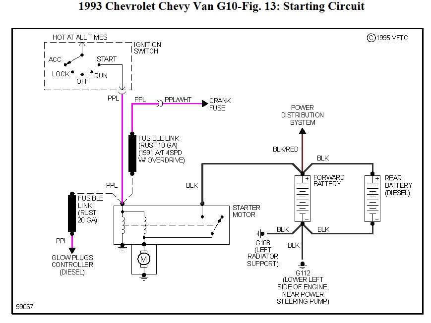

Ok here's the problem ive been having first I have a 1993 chevy g20 van few months ago I tried starting it all I could hear is a click from the starter so I bought new starter and replaced it then heard the same click so I thought maybe it was the battery so I replaced that too but same click no start, no crank so I was thinking something in the cables between the starter and the battery but I could not see any broken or cut wires could there be a cut or broken wire in the cable? What about a fusable link? Also my van has an old alarm system that the way it is wired in order to sart my van I have to turn the key hit the butten on the remote that enagages the alarm an activates the locks then I can turn the key all the way then it starts so maybe the alarm is keeping it from starting not sure. Ideas?

Check for voltage to the little wire on the starter motor when it start position.
Start there

If the engine isnt froze up, check for good voltage at the starter, with key in the crank position. Have a helper turn the key. Any testing at the starter, make sure the tranny is in park or neutral and the parking brake is set.
If all that checks out, have the starter tested. Some of the national brand autostores will test the starter for you, if you take it off and take it to them.
If you have an aftermarket security system hooked into the starter circuit, I cant trouble shoot that, my wiring diagram is factory wiring.

I did a battery alternator an starter bench test they checked put good also used a voltameter drop test everything looks good but there is a live circuit somewhere that is damning my battery how can I test my battery an starter cables to see if there is a open circuit somewhere draining my power? Also, what about my alarm you think it could be causing an issue where the engine can't crank over?

Once again, lets start with seeing if there is power going to the solenoid in the start position.

Ok well I had my brother in law test the starter with the voltameter while I turned the key an tried to crank it he says it's out putting 10 volts an I just hear a click like the starter is trying to kick out not sure what the next step is. Ideas?

Voltage is low but should engage the starter solenoid.
Is the battery 10 volts too when trying to crank? You should have 12 volts there
