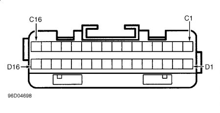

Just wondering what could be the prob with my 4x4 when I push the button it dont do nothing when it is in gear or park but when I put it in neteral it will only go in 4lo will not go in 4hi need help?

Ok so do you have a digital multi meter so we can run some test? I will look up the test procedures adn walk you through them. I do need to know 1500 or?
Thursday, January 28th, 2010 AT 10:21 AM
RRAETHKE
  • 5 POSTS
Yep its a 1500 yes I have a meter
Thursday, January 28th, 2010 AT 2:48 PM
RACEFAN966
  • 5,029 POSTS

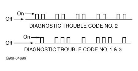

OK first locate the TCCM (transfer case control module) then unplug it and check for any corrosion. If it looks good then I need you to reconnect it and check for voltage at Term C4 with key on engine off see first pic below. The TCCM is under the dash attached to the steering column support bracket. I would also like you to check for codes that the tccm may have stored. To do this make a jumper wire to put between the Orange wire (term 13) and ground. Now turn key on engine off and count the lights on the 4x4 switch. Once key is on in about 3 seconds it will blink codes and if there is more then 1 code it will have a 3 second delay between codes. Once all codes are read it will restart at the first code. See second pic below for how to count the light blinks for the codes ok. Now once all codes are retrieved I would like you to turn key off and clear the codes. To do this after key is off remove the T-Case fuse from the fuse box for at least 3 minutes. Then reinstall the fuse and turn the key on and off 5 times. Let me know what you find.
