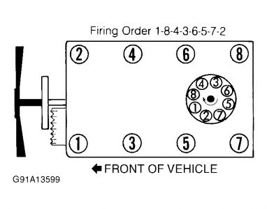

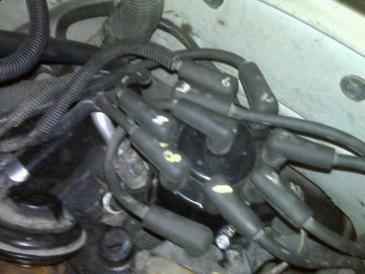

How does the spark plugs go on the disributor in what order on my 1992 it goes 123456 counterclockwise

5.0L , 5.7L and 7.4L engines are as below..

I tried that but nothing

Dist. Could be dead. Not getting spark at all?
