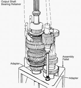

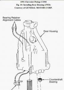

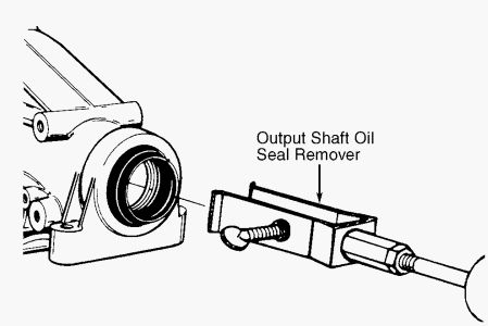

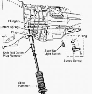

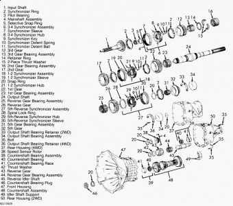

I was told I need some "special tools" to disassmble my nv3500 5 speed transmission. What are the tools I will need.
Sunday, March 14th, 2010 AT 9:12 AM
MERLIN2021
MECHANIC
17,250 POSTS
Snap ring pliers, a slide hammer, and a seal remover.
and 1. Mount Holding Fixtures (J-36824, J-8763-02 and J-36824) onto transmission. Remove back-up light switch and vehicle speed sensor assembly (if equipped). Page 1 of 1 3/14/2010 ...
