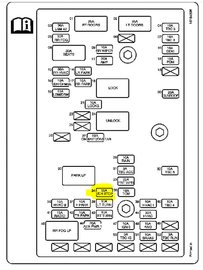

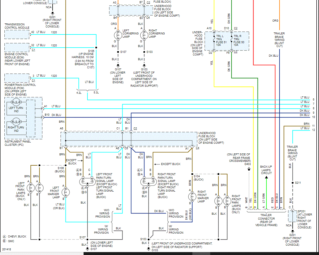

My brake lights don't work. The third brake light works. Checked fuses bulbs and looked at wires. Is it the brake light switch? If so how do I change it.

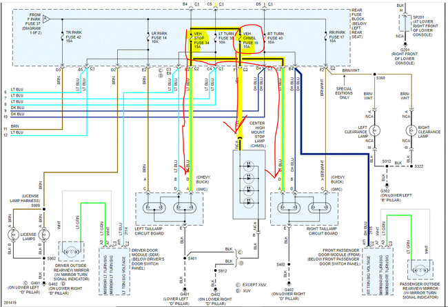

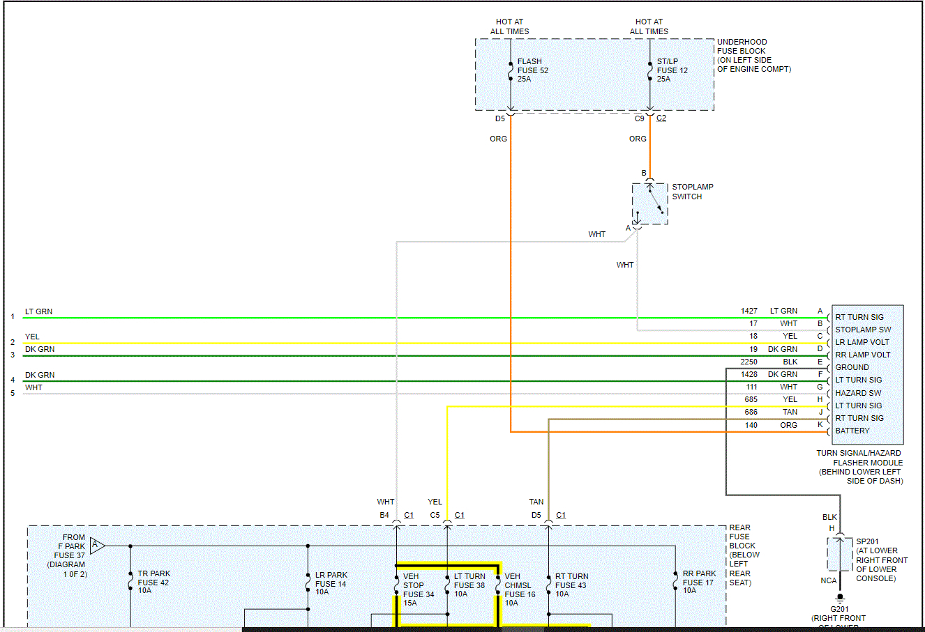

If the third, high mount stop lamp (CHMSL) is working, the brake light switch isn't the problem. If it was, the CHMSL wouldn't work as well.

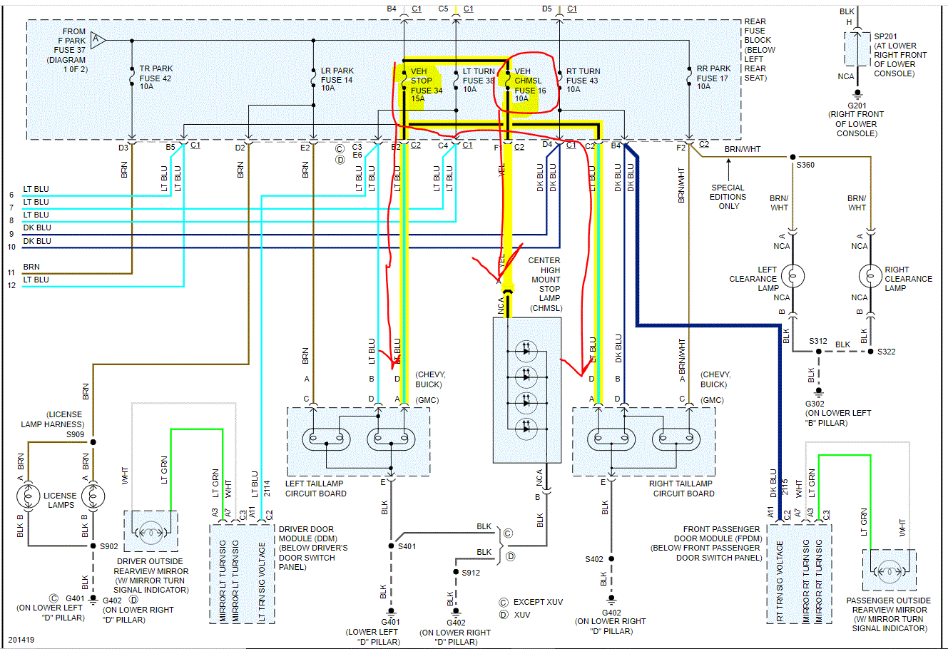

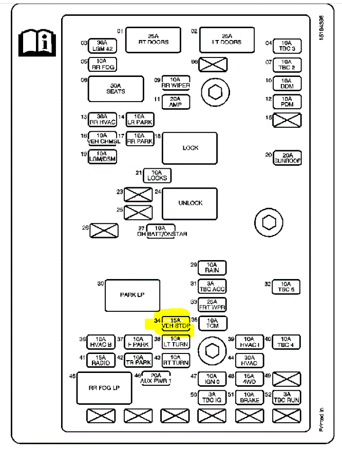

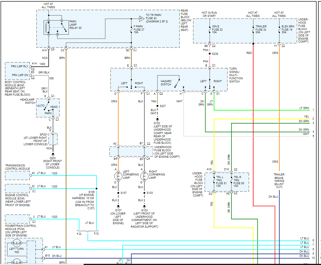

If you look below, I attached the wiring schematic for the exterior lighting. I highlighted two fuses and pointed to where power is distributed. Note: After the switch, there is one fuse for the rear brake lights and a different fuse for the CHMSL. I suspect the fuse for the rear lights is bad.
The last pic is the clearest one related to the brake lights. Note I highlighted two fuses, one of which is circled in red. The circled one is for the CHMSL. It is good. The other one is where I suspect the problem to be. So, I need you to check that fuse.
When checking a fuse, it is important to not only inspect the fuse, but also to confirm there is power available to the fuse. Here is a link you may find helpful for doing this:
These fuses are located in the rear fuse box, below the left rear seat. Pic 5 below shows the fuse box, and I highlighted the fuse in question.

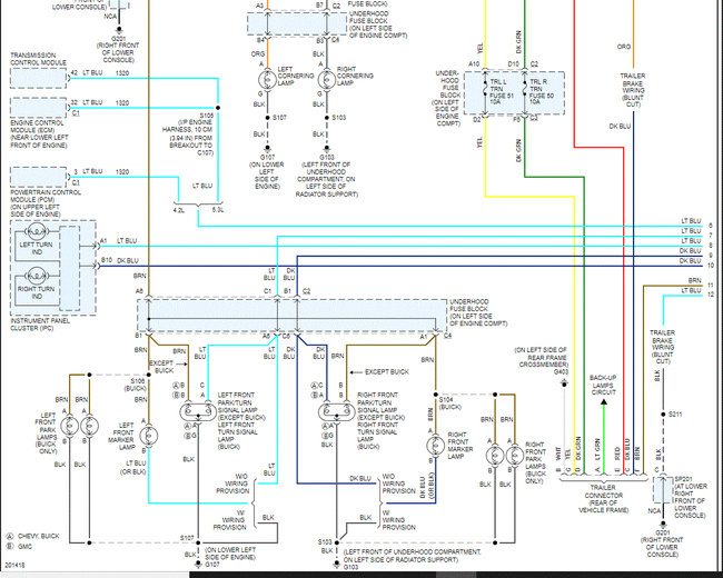

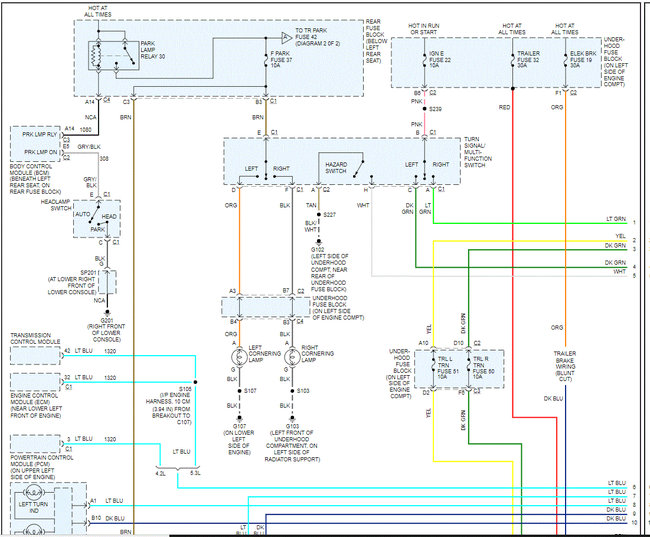

See pics below. Note: I had to cut the wiring schematic pages in half to make them readable for you. I did overlap them so you can follow from one to the next.
