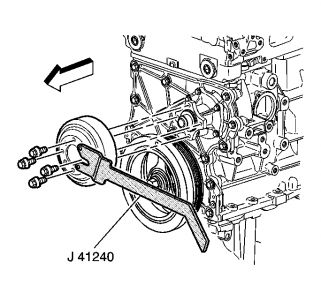

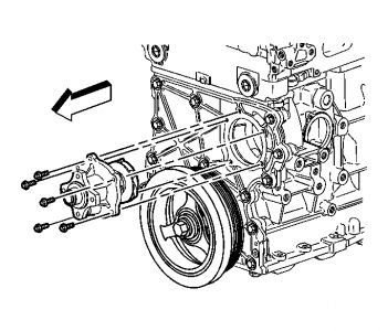

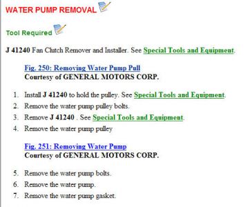

Please give me a free site that has information on how to replace my water pump and fan cluth on my 2004 Trailblazer. You site does not include that repair or replacement instructions.

Sorry had early call...
Here is the info.....
https://www.2carpros.com/forum/automotive_pictures/188069_04trailblrwaterpumpremuv_1.jpg
https://www.2carpros.com/forum/automotive_pictures/188069_04trailblzrwaterpumppulley_1.jpg
https://www.2carpros.com/forum/automotive_pictures/188069_04trailblzrwaterpumpremuv_1.jpg
Let me know if you need anything else...
