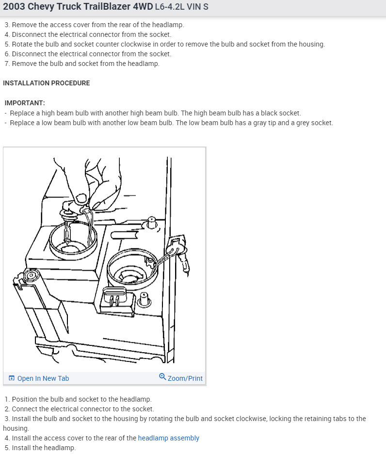

I would like to know I can replace a low beam on the drivers side

How do I replace a low beam on a 2003 trailblazer chevy drivers side

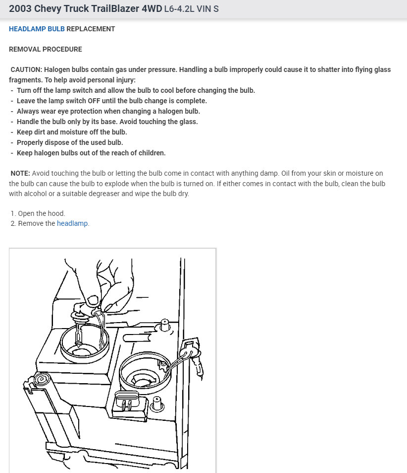

See attached for the headlight bulb replacement procedure.
Here is a helpful guide and best practices for replacing headlight bulbs:
https://www.2carpros.com/articles/how-to-replace-a-headlight-bulb
Let me know if you have any questions.
