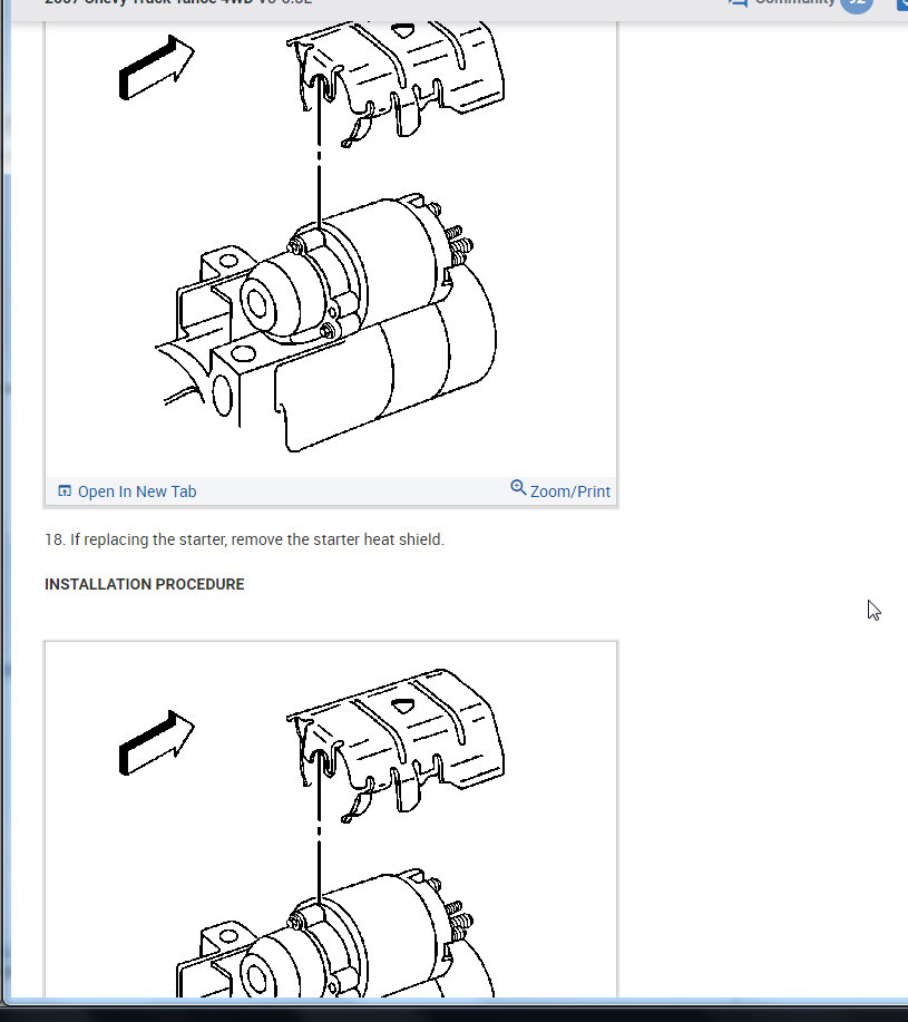

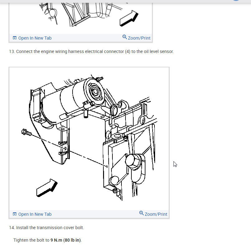

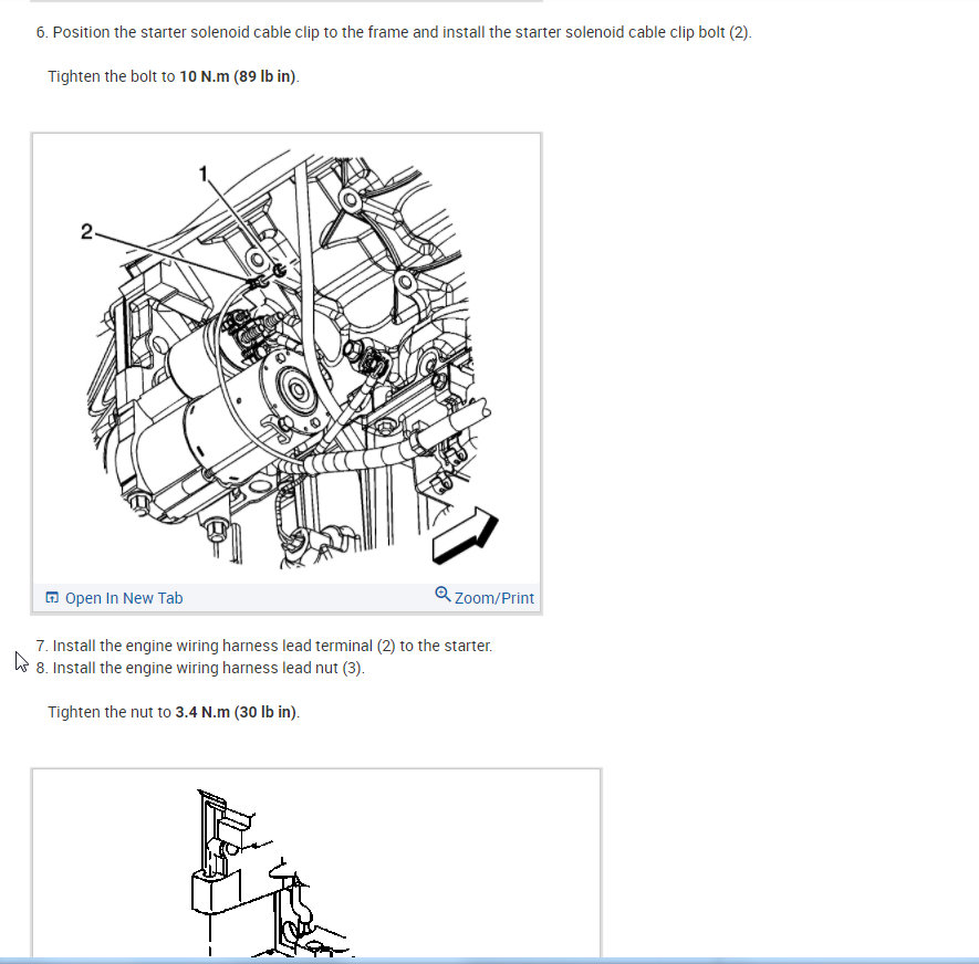

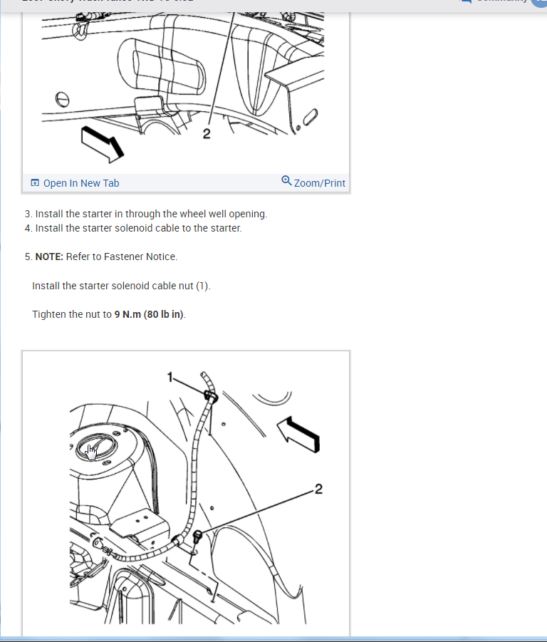

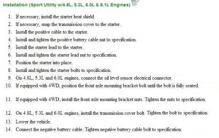

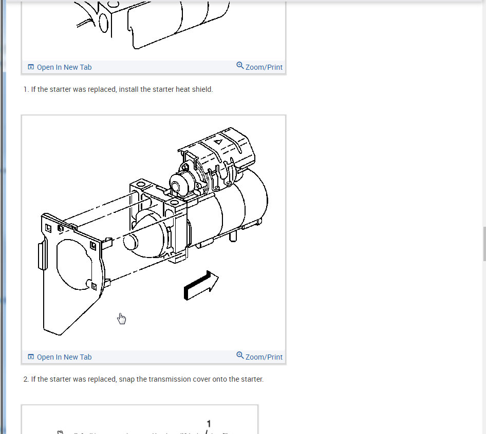

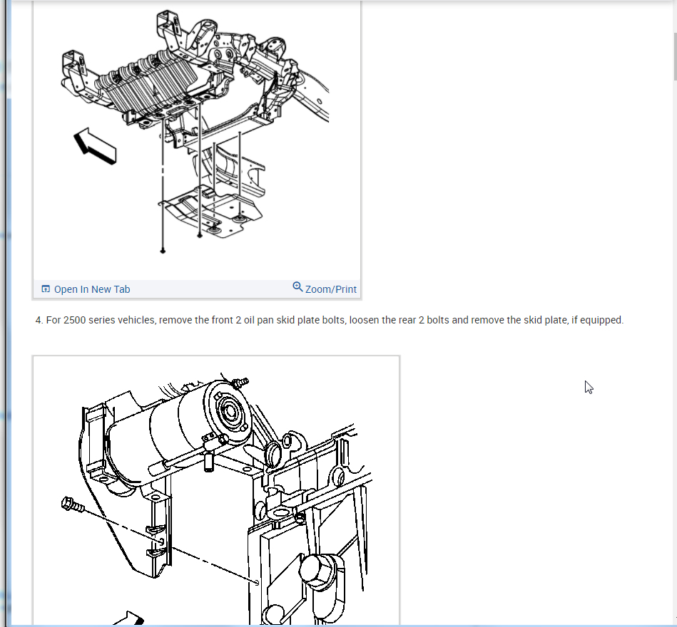

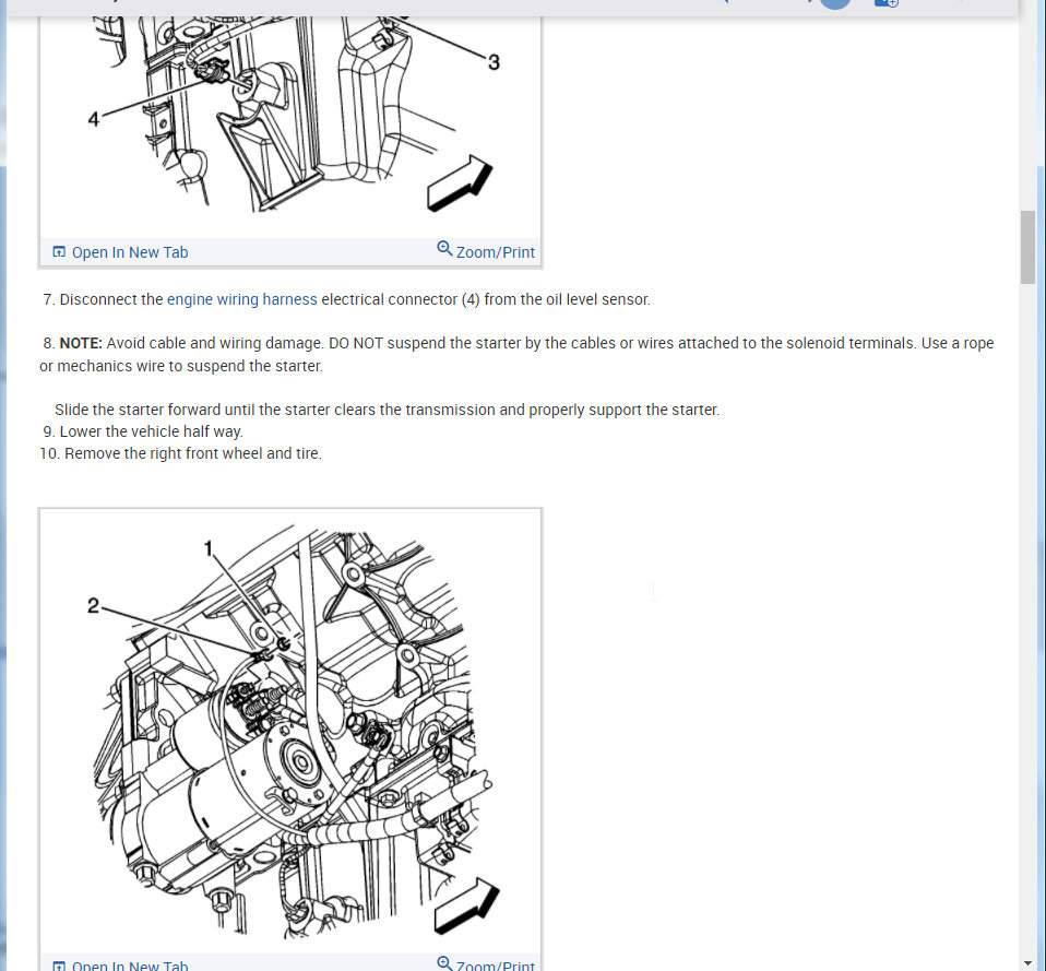

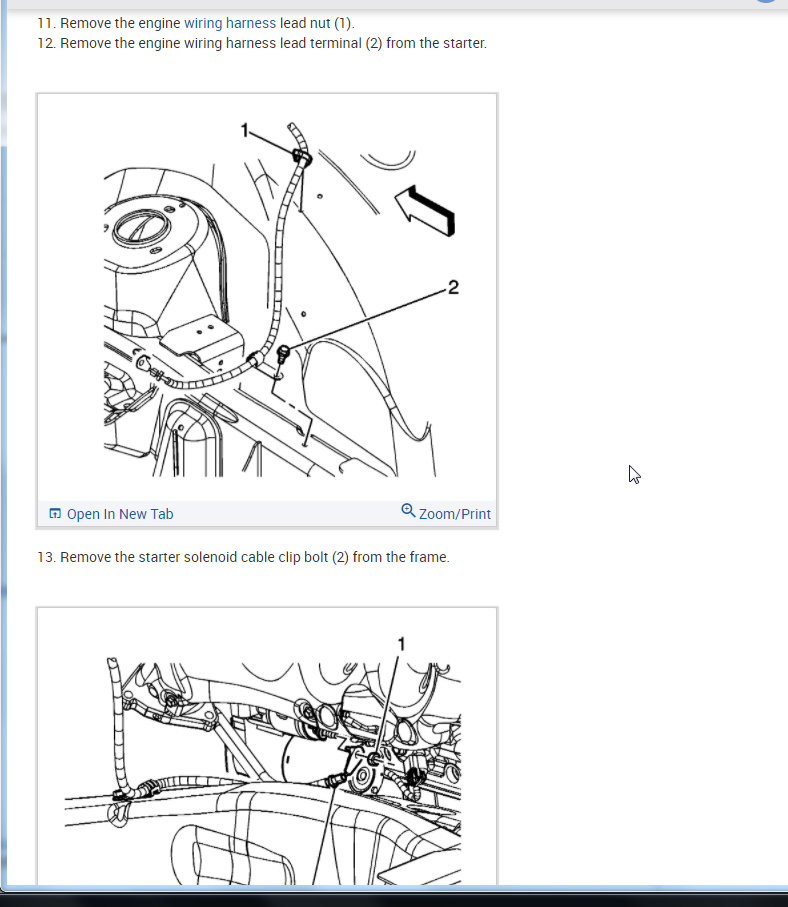

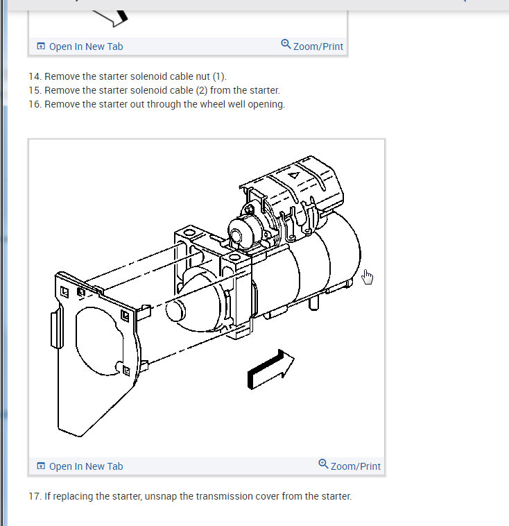

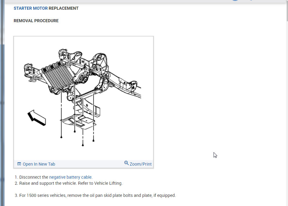

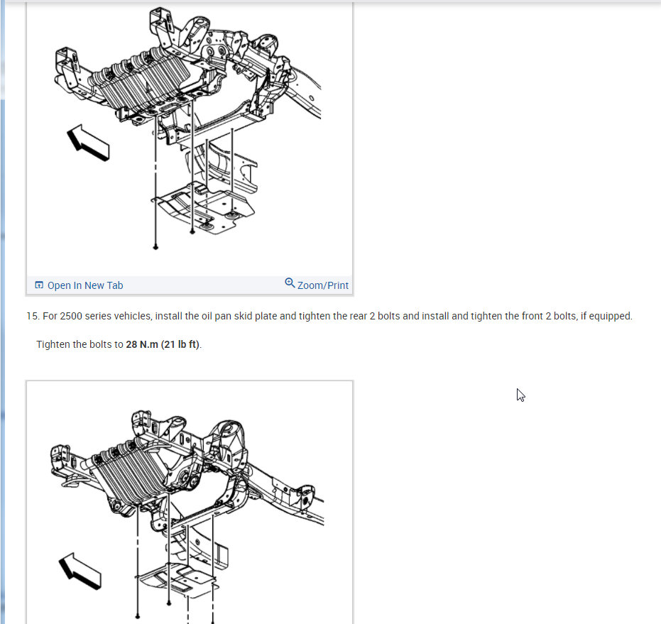

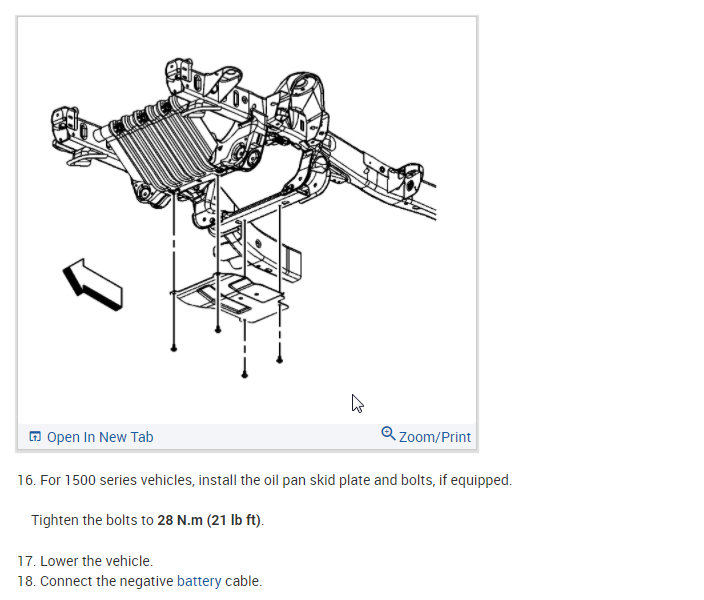

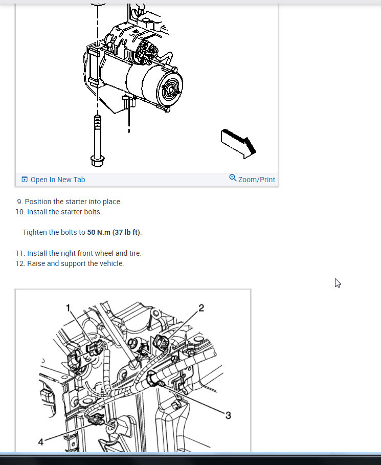

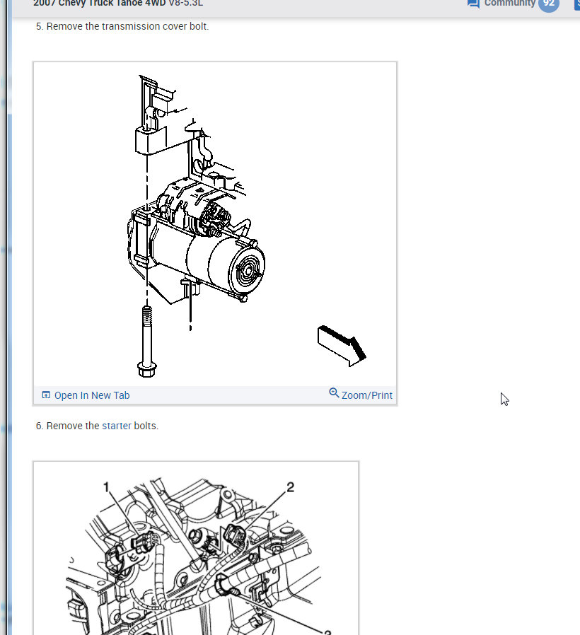

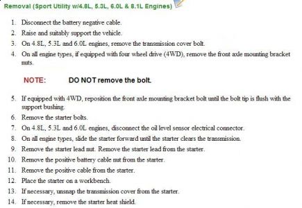

Trying to remove the starter on 2003 tahoe. It will not pull out due to what looks like a small bracket bolted to the oil pan/bell housing. Can't ge tto the two side bolts on the bracket to remove. What is the proper way around this?
Jun 28, 2021 at 7:05 PM (Merged)
BLUELIGHTNIN6
  • 16,542 POSTS
Here are the proper replacement procedures..
https://images.2carpros.com/forum/automotive_pictures/261618_Noname_657.jpg
https://images.2carpros.com/forum/automotive_pictures/261618_Noname2_167.jpg
