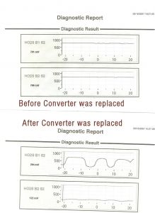

107,000 miles 5.8 liter. Have several issues that may or may not be related. SES light (p0420 code) has been going on and off but the vehicle was running fine. Recently, I noticed a rough idle when A/C compressor comes on. Then today I heard a strange sound when I accererated from a stop. Sounded like a rush of air from under the hood, maybe from passenger side, lasted about one second. Happened four times in one trip to the store.

SERVICE WRITER
  • 9,123 POSTS
Hold on to you hat. Er should I say cat. It should be a 5.7 motor. You need to get the OS sensors wave patterns looked at. You probably need a CAt. Or Cataylitic converter. Heres the bad news, they are not only together, but are part of the front pipe. A shops' cost is around $390. Check for exhaust leaks in front of the cats. And hope you find one as that will throw the o2 sensors a little loopey.
Sunday, July 28th, 2019 AT 6:05 PM (Merged)
SERVICE WRITER
  • 9,123 POSTS
https://www.2carpros.com/forum/automotive_pictures/30961_o2_waves_3.jpg
The upper pic shows the front o2 sensor being flat lined (bad) and the rear o2 flat-lined (good)
after the replacement,
The front has a sin wave pattern-(good)
