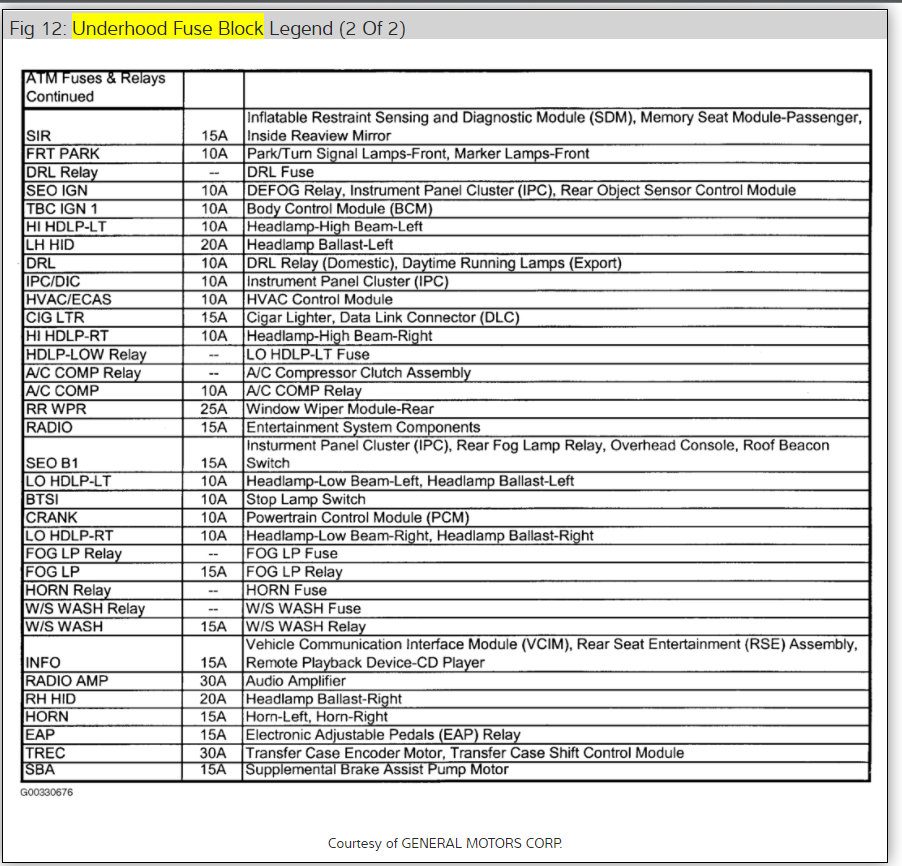

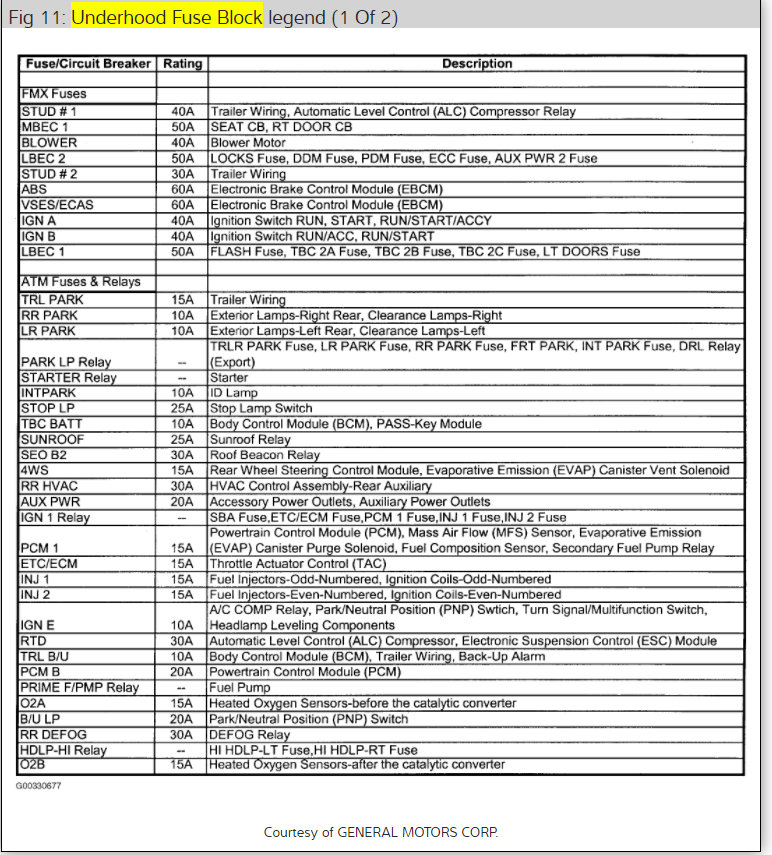

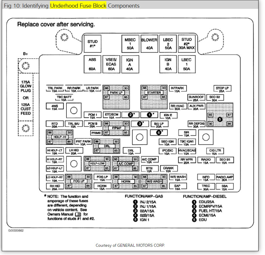

Check the aux power 2 fuse here is a guide to help you test for power and the location of the fuse.
