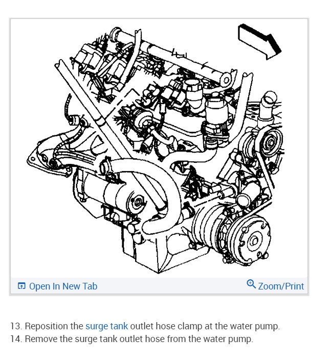

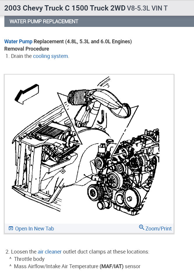

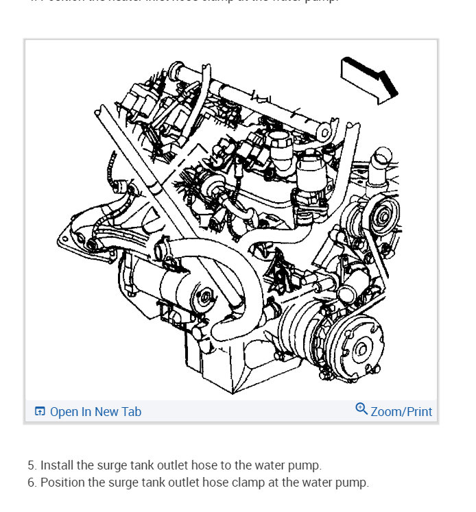

My Tahoe seems to have a leak and the liquid seems to be radiator fluid (it's red and it's not tranny fluid). The leak seems to be comming from the bottom front right corner of the engine (almost near the water pump, right below the water pump), it seems to be leaking from one of the screws. I'm guessing the gasket in that area is bad. However I cannot pin point exactly what that part of the engine is. It would be very helpful if I can find a diagram of 2006 Chevy Tahoe. If anyone can help I would appriciate it. I can also provide pictures if necessary.

Hello

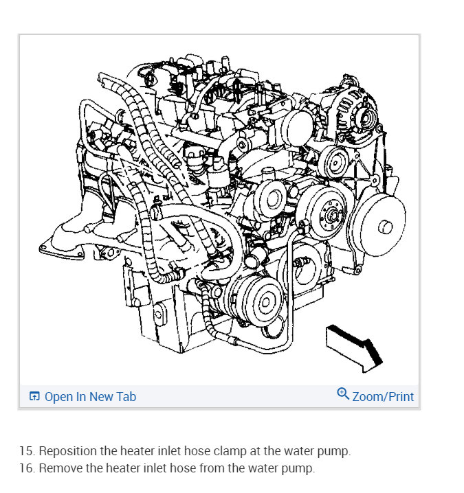

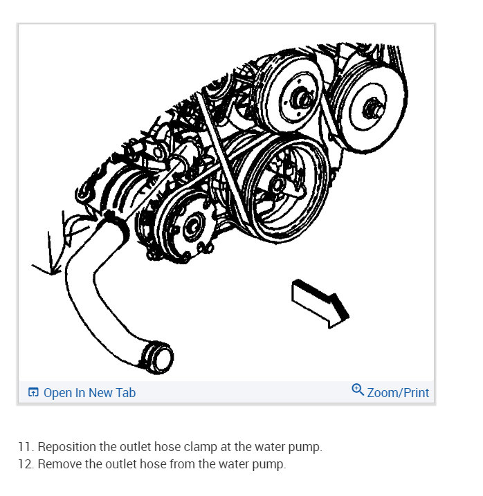

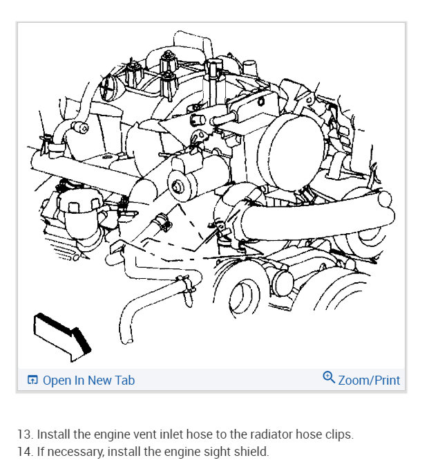

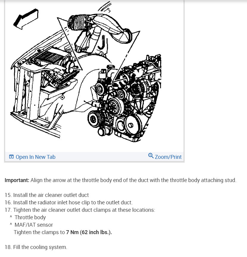

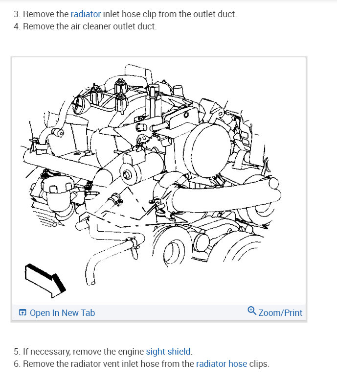

Here is a guide to help walk you through the steps with instructions in the diagrams below to show yo how on your car.
https://www.2carpros.com/articles/water-pump-replacement

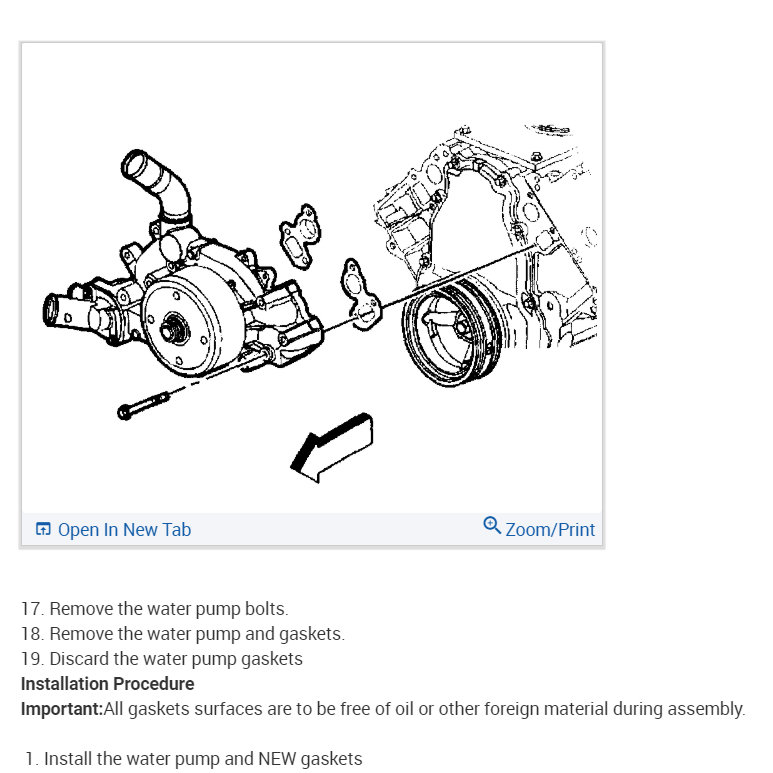

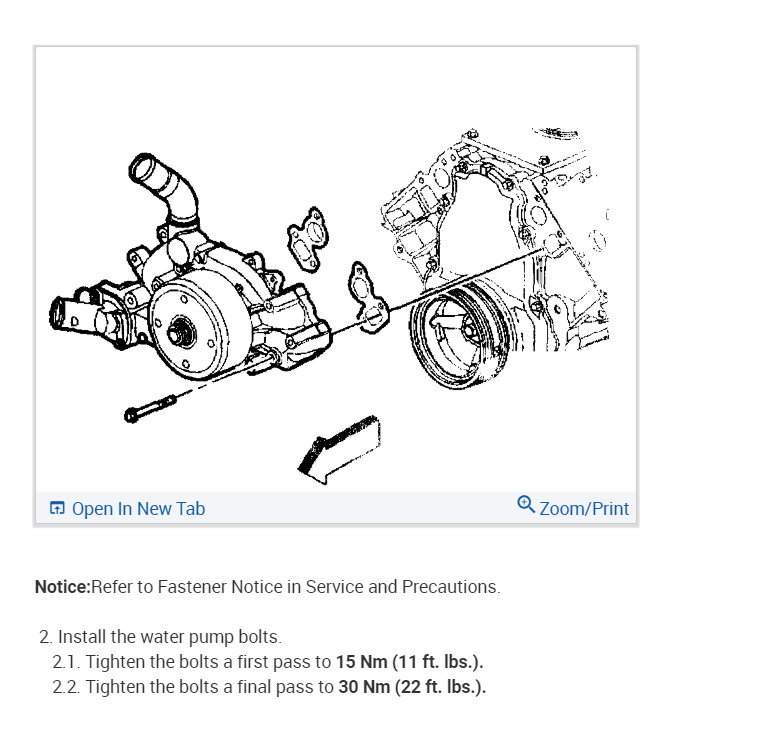

I just noticed my Tahoe is leaking water from what it seems to be the water pump, and the reason I'm saying "it seems" is because it is running down from where the pump is, but I couldn't positively say that it is from the pump because I can't see clearly if that's where is coming from. I know for sure is not leaking from any of the hoses or the thermostat housing. I started to disassemble all the components around to get a better view of the origin of this leak when I ran into the fan clutch, since it screws onto the pump, I couldn't loosen it because the water pump pulley keeps turning freely even with the belts on, so I was wondering if there is a special tool to hold the pulley or how it's supposed to be taken off. The pulley has four small holes around the pulley but it's such a tight spot that it is almost impossible to stick something in there to hold it while trying to take it off.

The pump is most likely leaking from the gaskets where it bolts to the engine. There are two special tools to remove the clutch, but you don't have to remove it to change the gaskets.

how do i diagnose a waterpump going bad or waterpump gasket gone bad? there is a leak comeing from bottom of pump and a "chirping noise" that sounds also like a bad belt. also it would be helpful if you could give me a time estimate on changing out water pump and/or gasket. and how hard is this job? THANKS ALOT

Hi:
There is a round hole under the pump that is most likely leaking. Check for the leak there. If leaking, the pump's bearing is bad causing the seal to leak. This is what happens on almost all waterpumps when they go bad, and yes they could make a churping sound.
As far as labor, it should take no more than two hours.
I hope this helps. Let me know if you have any other questions.

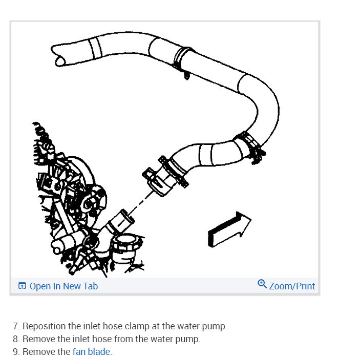

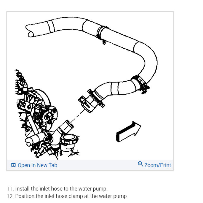

I was told by a dealer that my bypass hose on my waterpump was leaking and needs replaced. I need help on how to replace it. Do I need to take any parts off my Tahoe? Where is the hose located?
May 24, 2020 at 10:29 AM (Merged)
PEAR69
  • CAR REPAIR CONTRIBUTOR
  • 1,482 POSTS
First, if you are doing this yourself, you must locate the hose yourself. The by-pass hose the short hose located on the pump itself. Once you find it then you can determine what parts you must take off. Depending on your level of mechanical inclination and what tools you have this job is pretty easy. If you remove the fan and serpentine belt it will make the job easier.
While you have the serpentine belt removed, check it for cracks and missing grooves. If you find any, now is the time to replace it. Also, spin the serpentine belt adjuster and idler pulley by hand. Check for any worn bearings or grinding sounds from these pulleys. If any replace them.
Remember to drain the radiator coolant a little bit when replacing the bypass hose. This will reduce the amount of fluid that will spill when you remove the hose... Let me know how you make out.......
