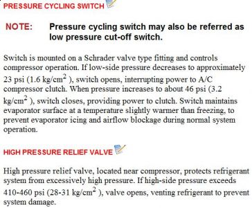

Clutch cycles on & off even with air cond. Button in off position. Seems odd. Stopped by disconnecting switch on accumulator but would like an explanation before adding more gas to system.
thanks. My sons car.

https://www.2carpros.com/forum/automotive_pictures/55316_99tahoeac_1.jpg
Before you add more refrigerant, you may want to make sure that the system is intact, meaning no leak.
