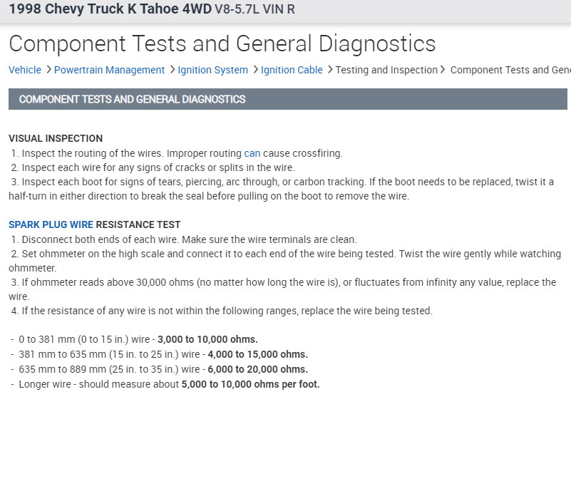

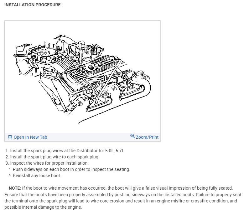

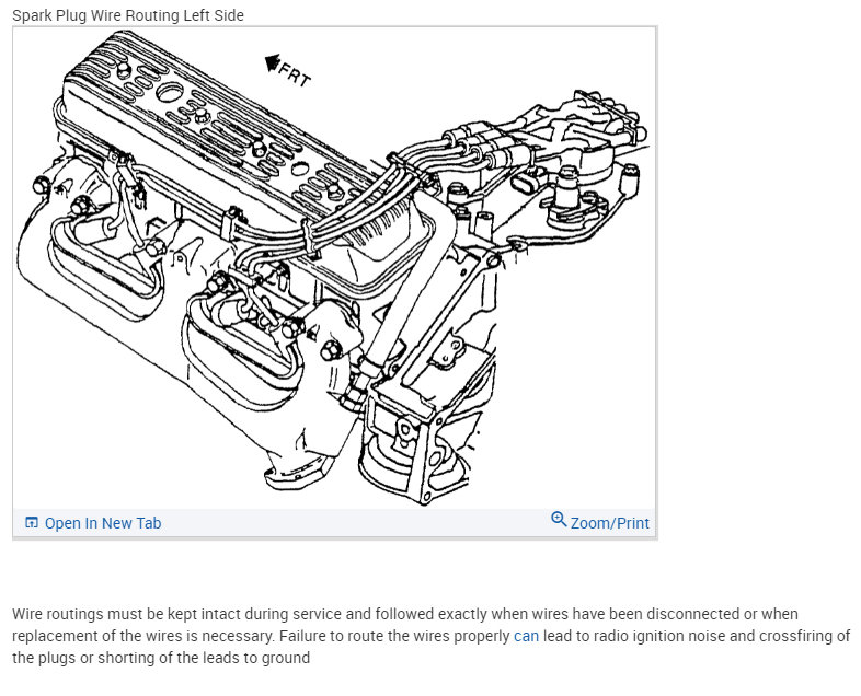

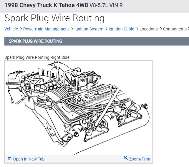

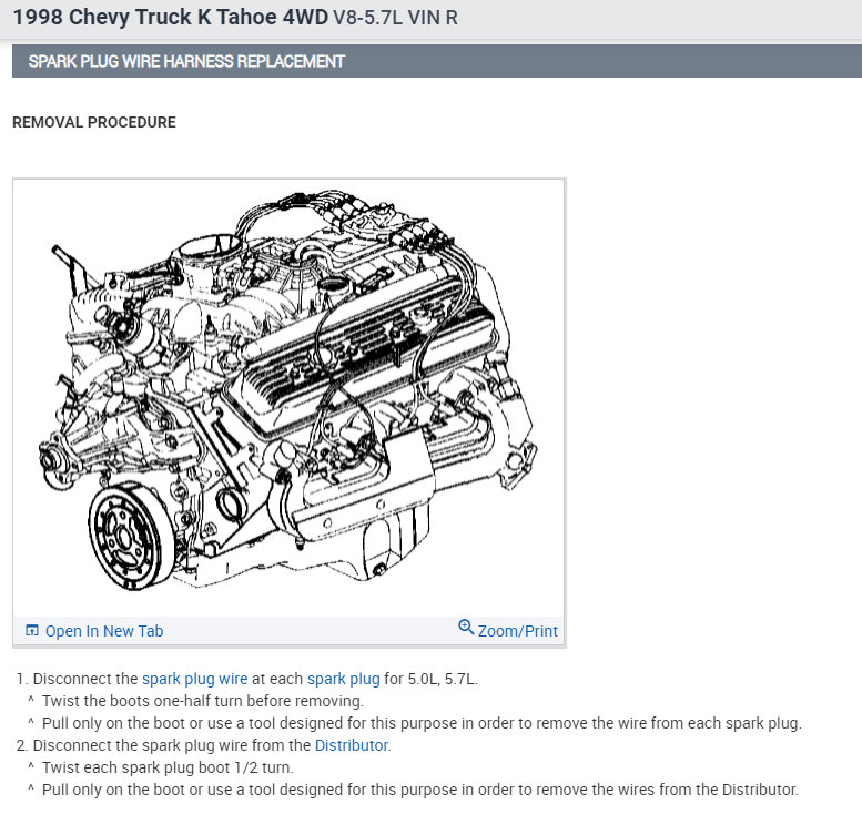

When replacing the spark plug wires, it is a good idea to do one at a time, this will help you keep track of each wires location and prevent incorrect plug in to the distributor cap.
Using a spark plug wire tool can help with the process.
I have attached the diagrams for the wires below also included the testing procedures for them.
