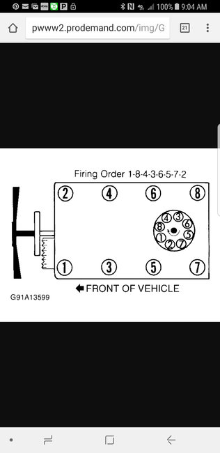

I need a diagram of the install of plug wires for a 97 tahoe

You need the firing order this is for the 5.7L and 7.5L Check out the diagrams (Below). Please let us know if you need anything else to get the problem fixed.

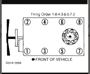

Putting it all back together with only one problem, my son helped me. He pulled plug wires off distributor cap without marking them. They still attached onto spark plugs. Could you show me a diagram of how they go back. Please and thank you

I posted a diagram of the cylinders and where the go on the distributor.

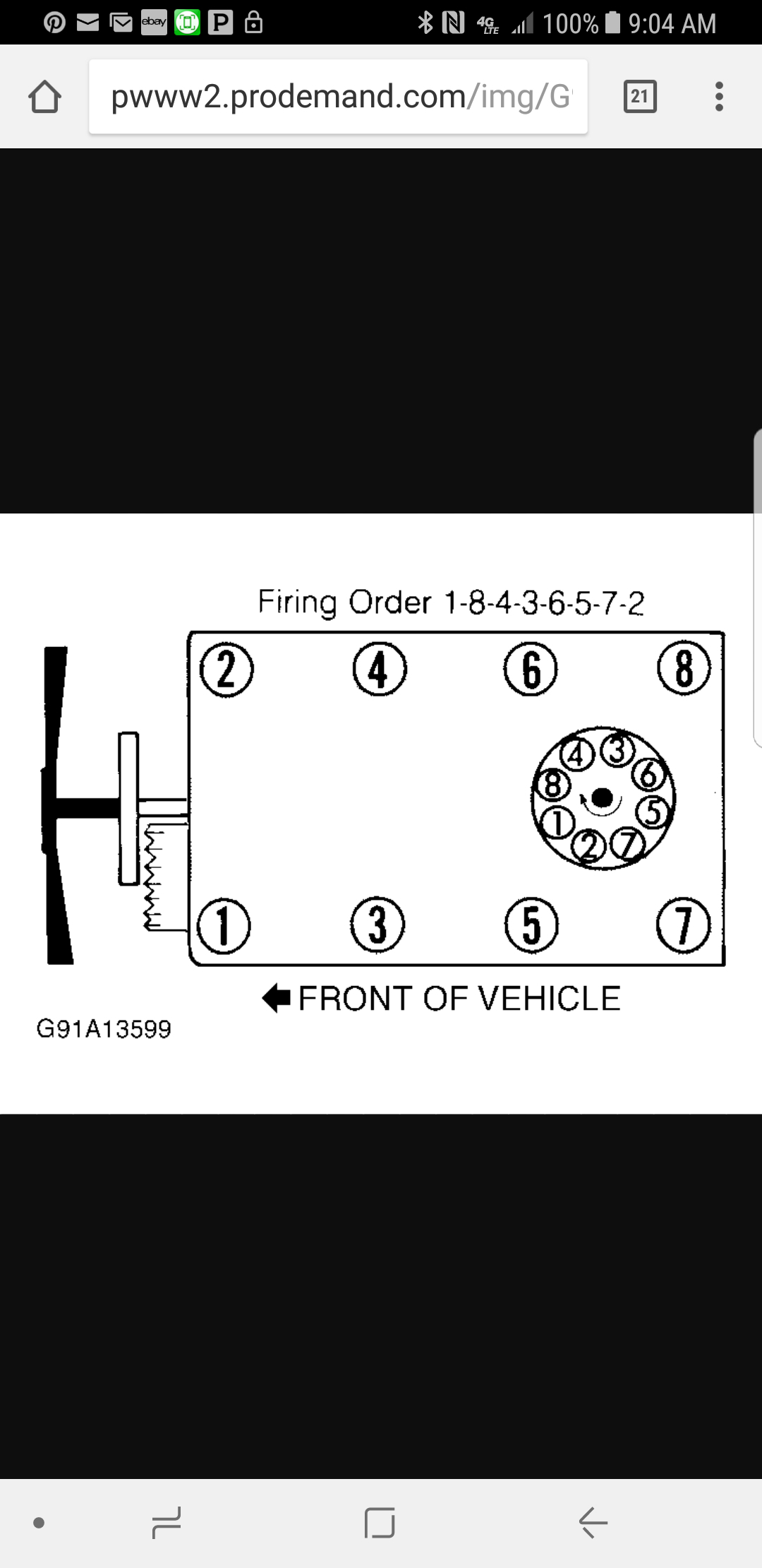

The passenger side cylinder bank, from front to back, the cylinders are numbered 2468.
The distributor cap, passenger side, front to back, 8246.
The firing order is 18436572, the rotor turns clockwise. This is for a 5.7L engine.

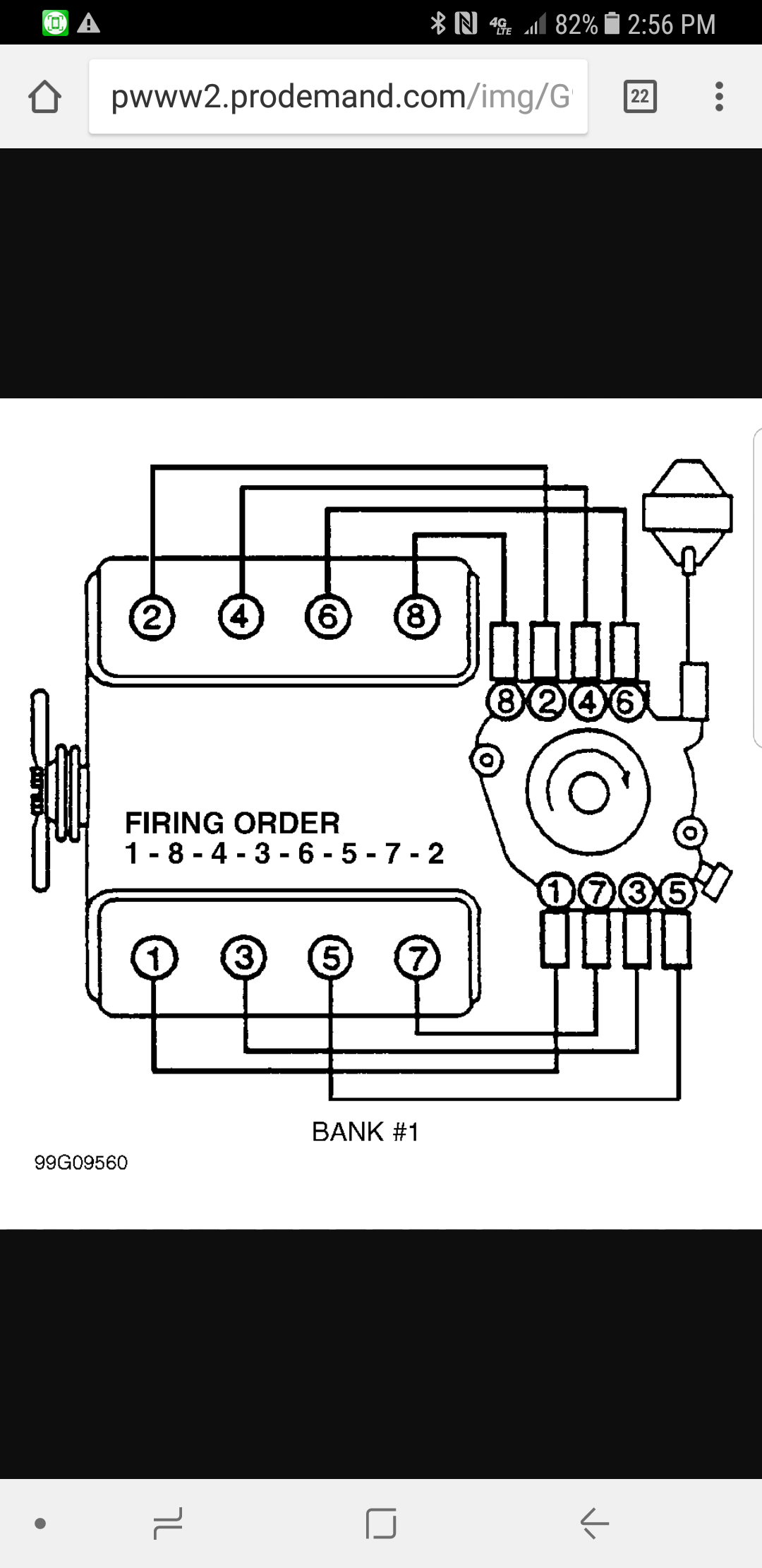

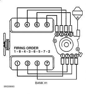

I've seen two different 'standard' diagrams for the spark plug-to- distributor wiring layout at the distributor cap.
One seems logical, and follows firing order, the other doesn't seem to match up, unless the rotor skips when it conducts. I'm confused, and need to know which diagram is right.
+1
Thursday, February 18th, 2021 AT 5:23 PM (Merged)
DANNY L
  • 5,648 POSTS
Hello, I'm Danny.
The second picture you attached is correct (below). Hope this helps and thanks for using 2CarPros.
