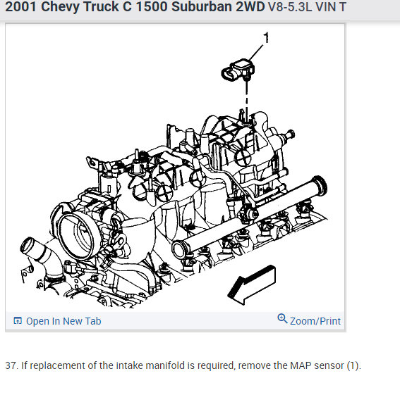

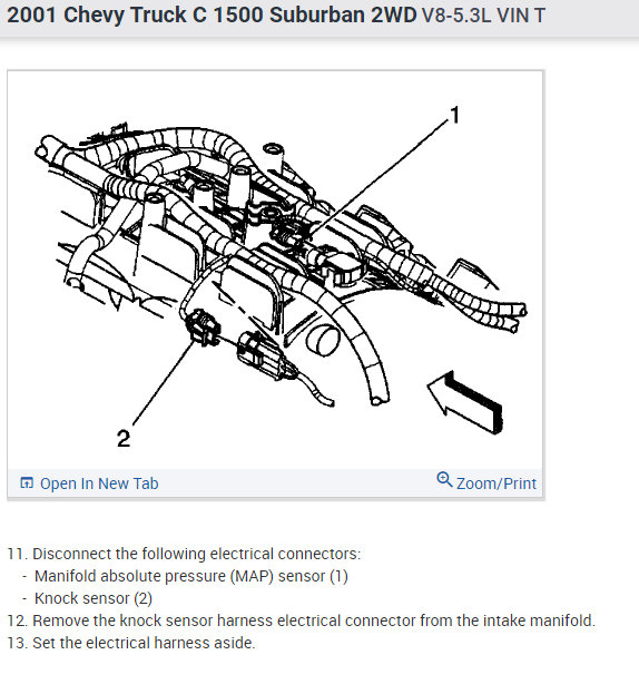

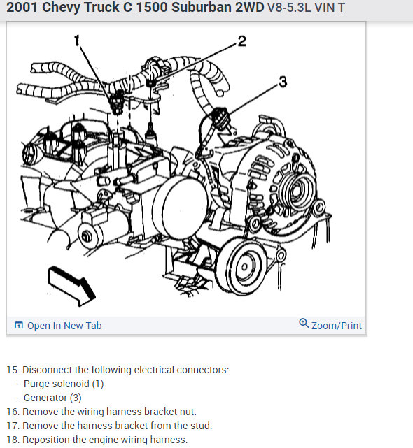

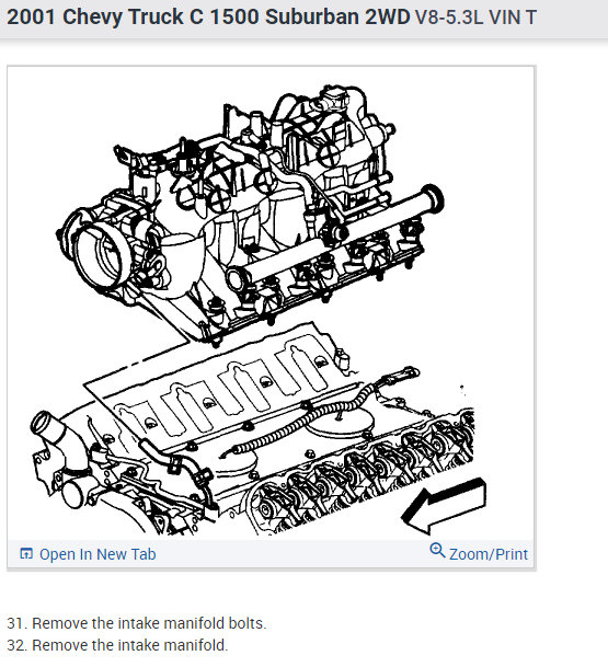

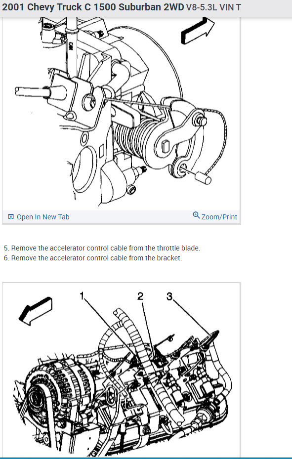

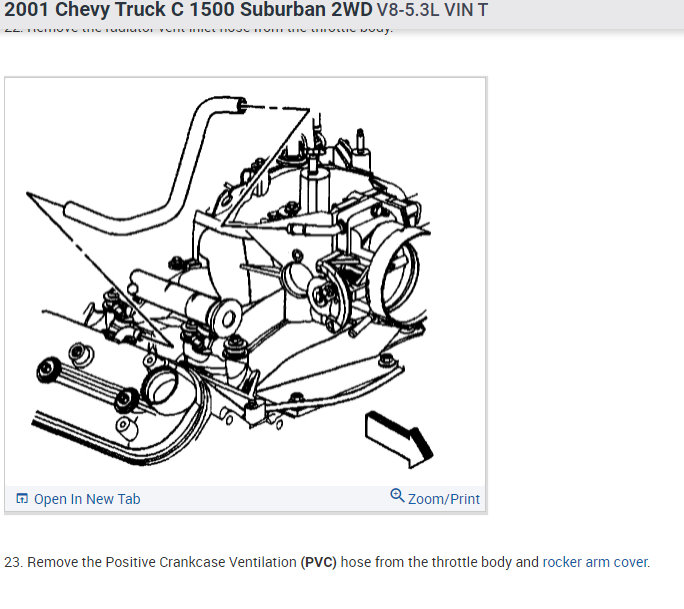

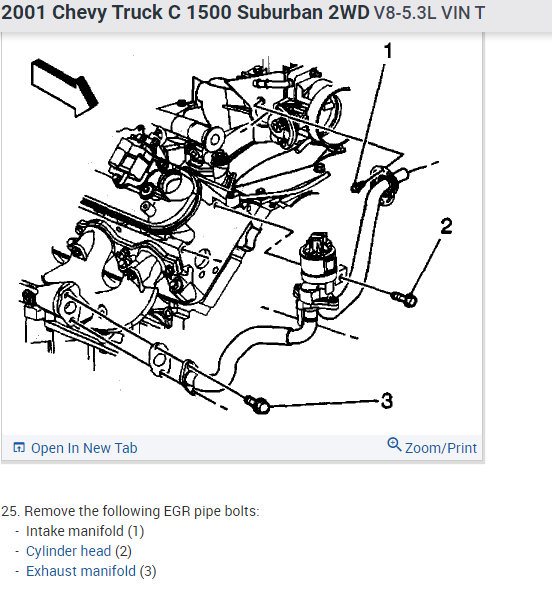

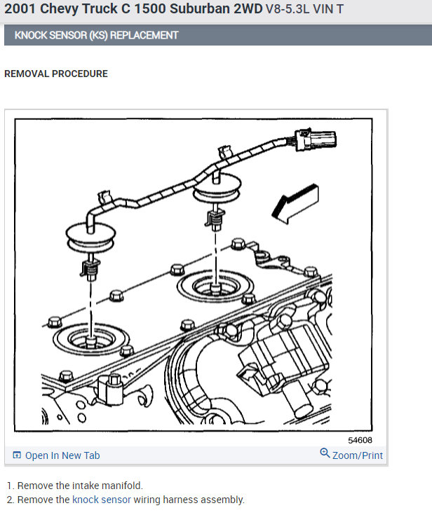

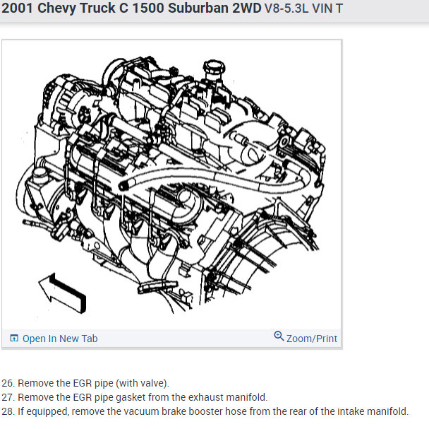

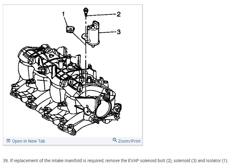

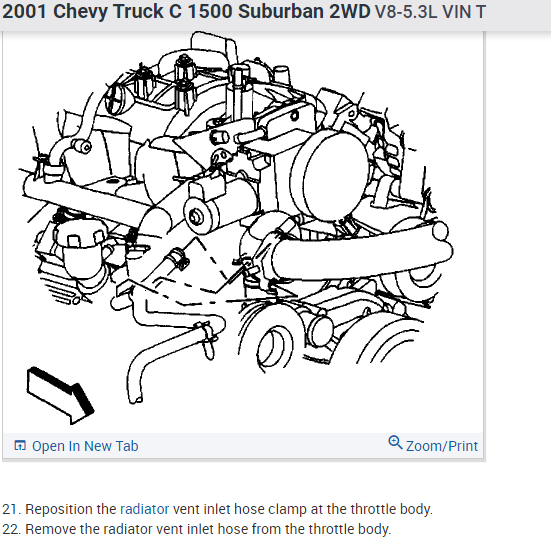

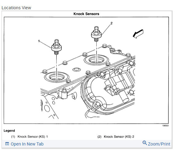

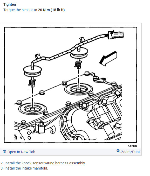

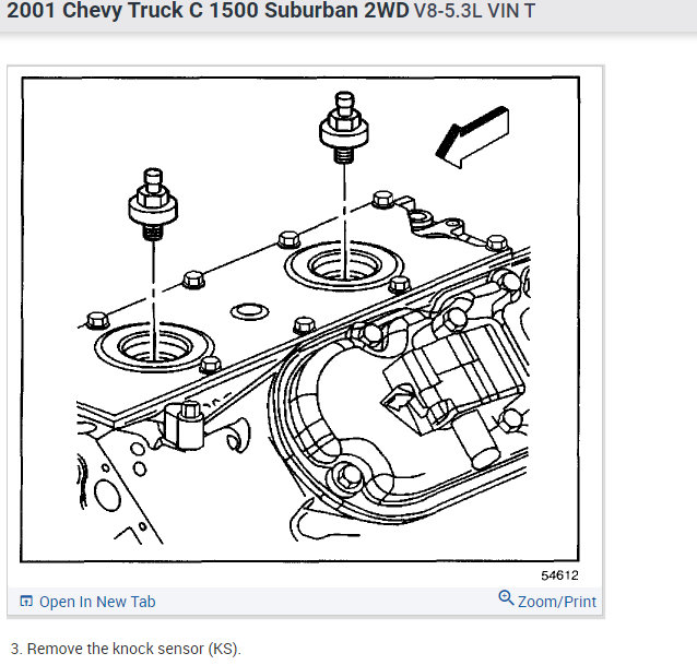

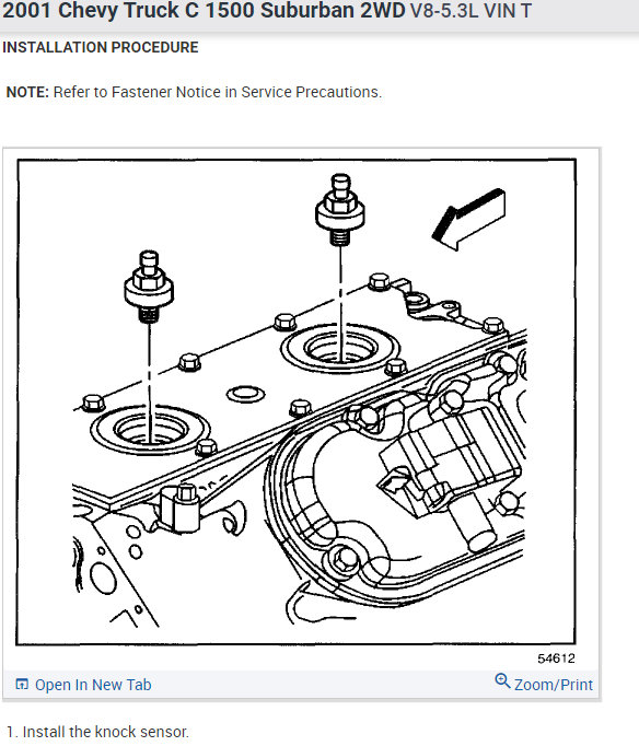

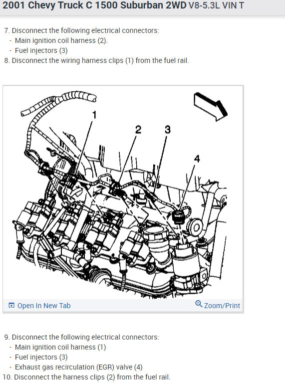

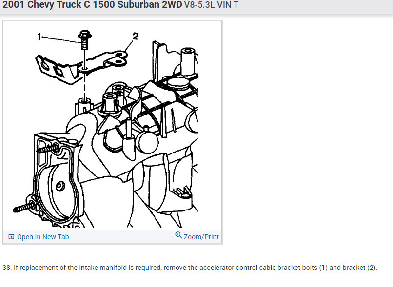

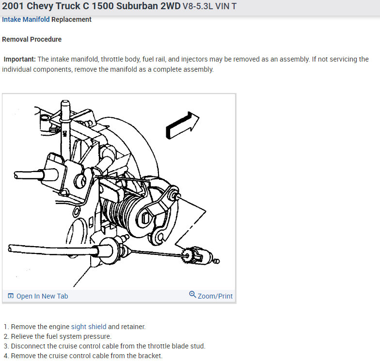

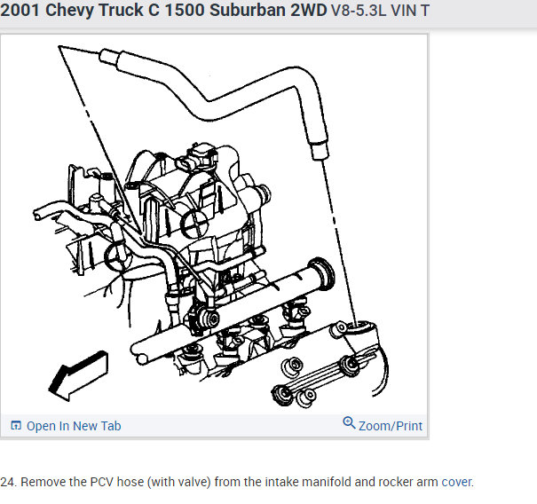

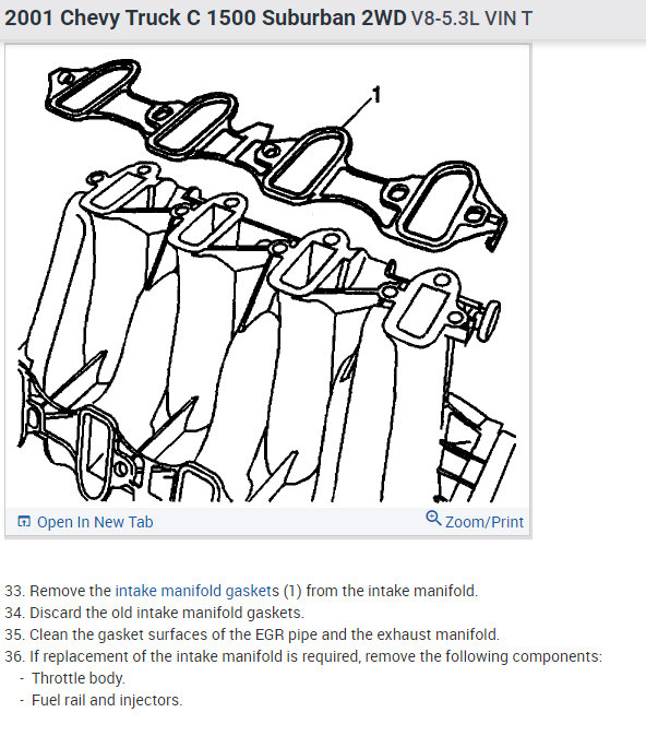

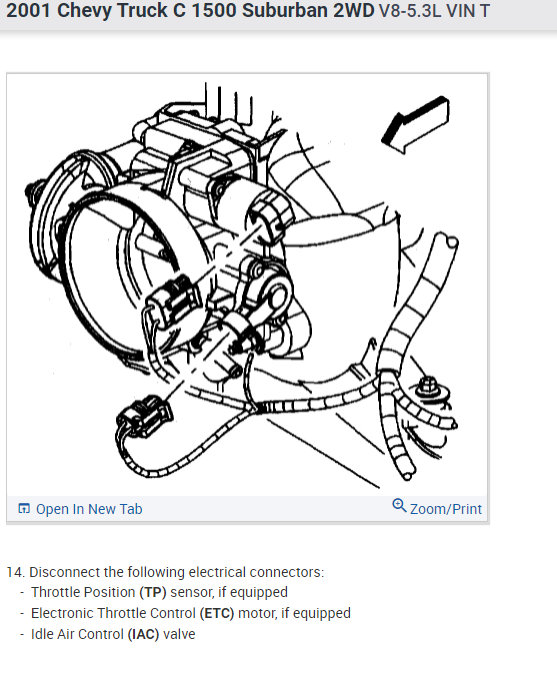

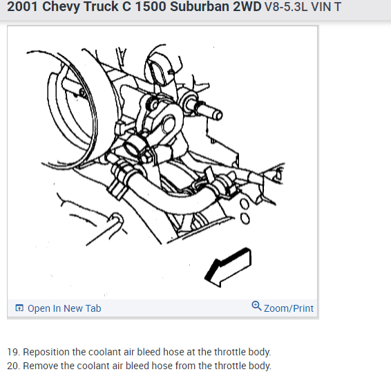

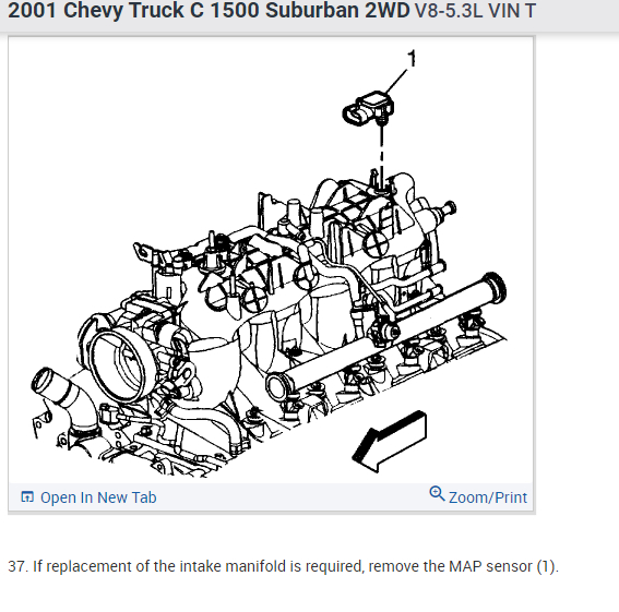

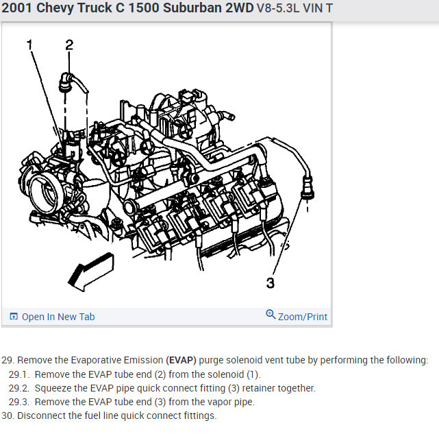

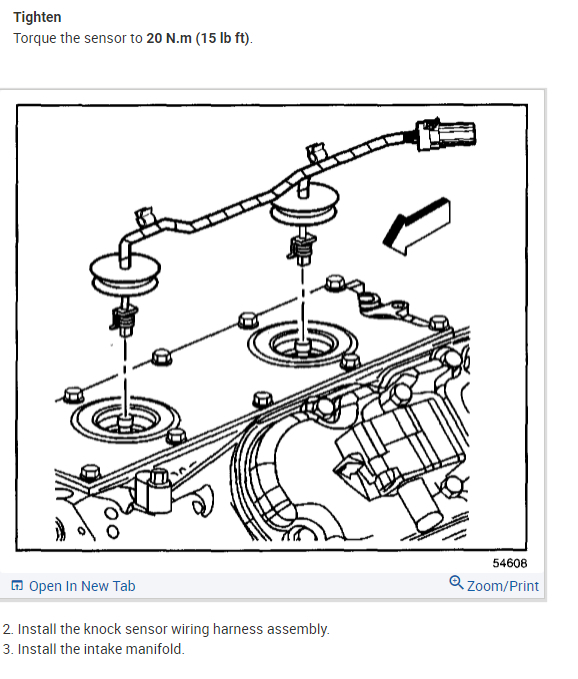

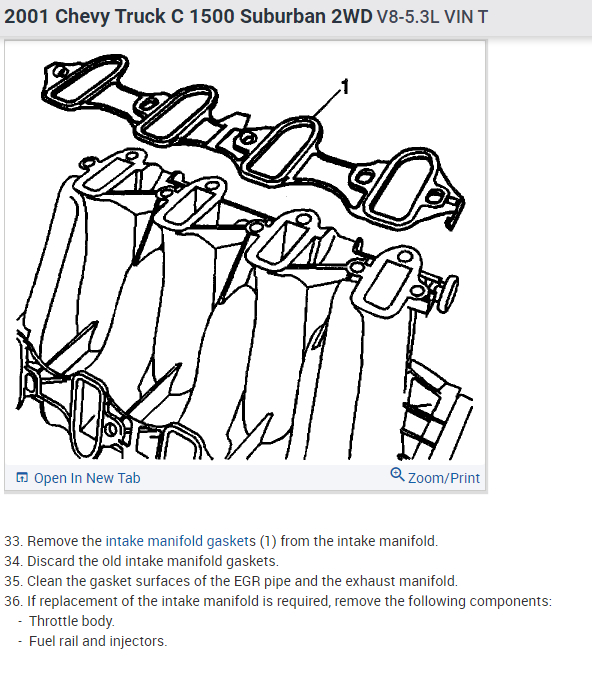

Where is the knock sensor located and how do I replace it?
Thursday, August 5th, 2010 AT 12:08 PM
SQM
MECHANIC
6,383 POSTS
The knock sensor is located under the intake manifold of your Suburban.
Here is a video of the replacement of the knock sensor:
https://youtu.be/9kcLNY13ryE
I have also attached replacement procedure.
