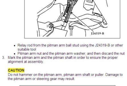

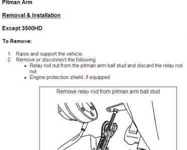

How do I remove the pitman arm with out removing steering box, or cut frame apart!

Welcome to the forum, my info showed this procedure. You may need to use a puller? A pickle fork might work??
