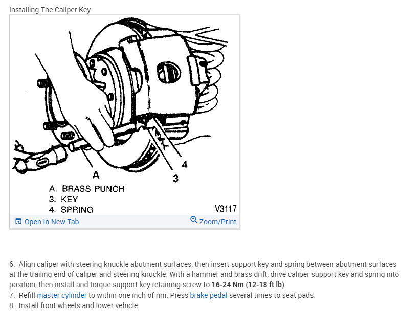

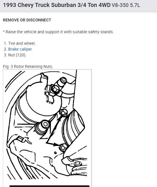

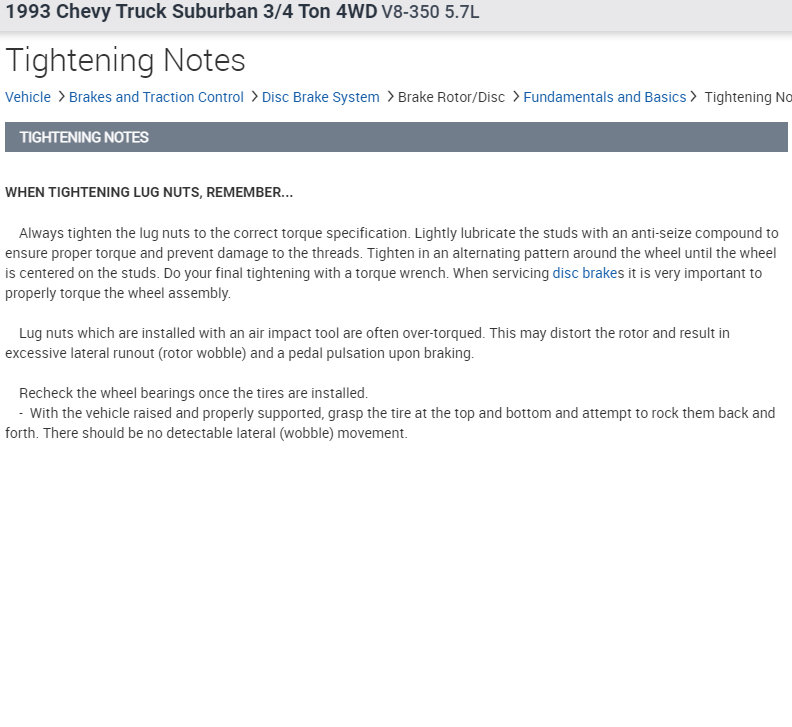

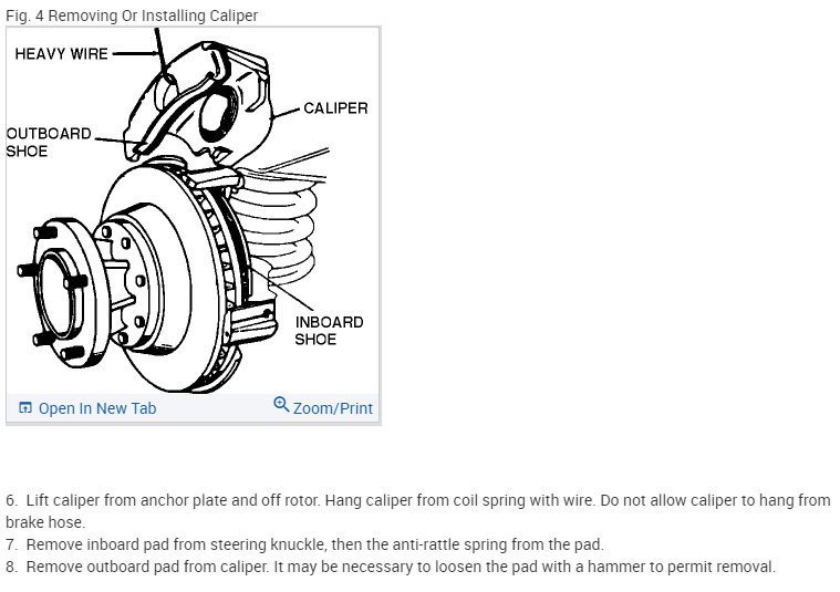

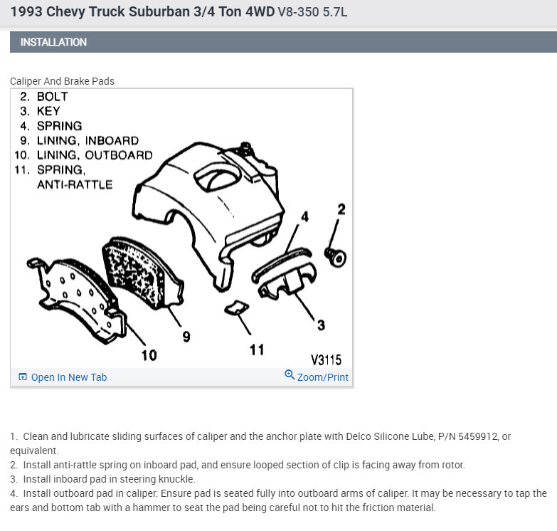

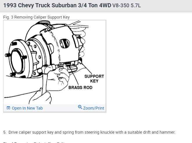

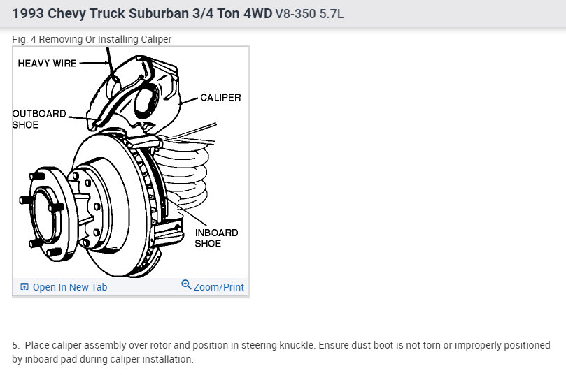

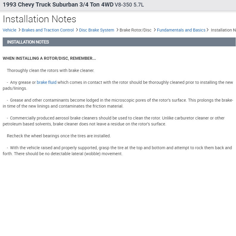

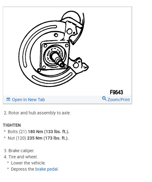

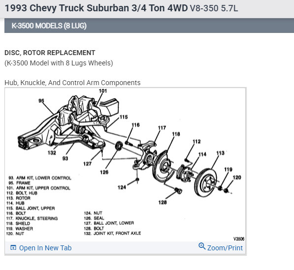

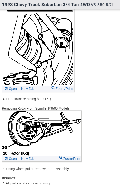

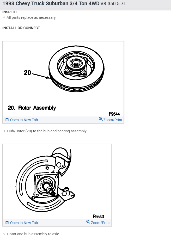

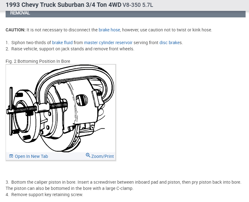

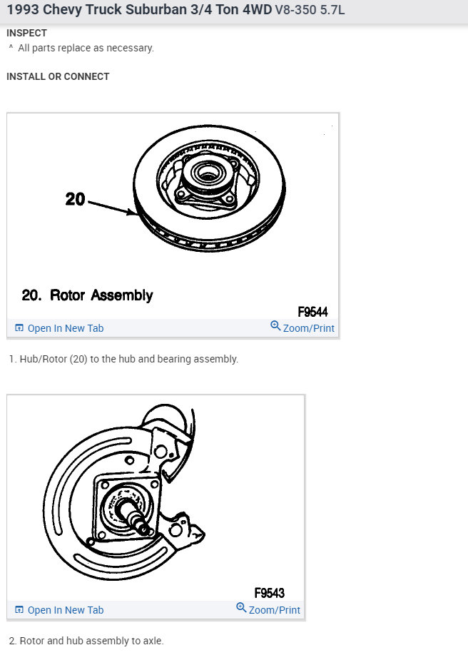

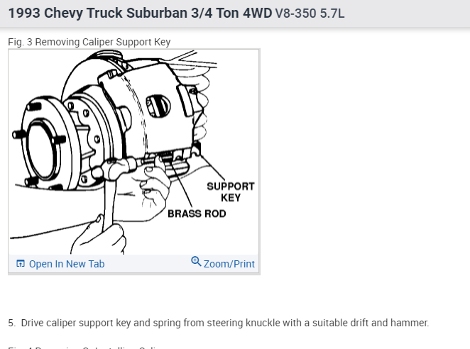

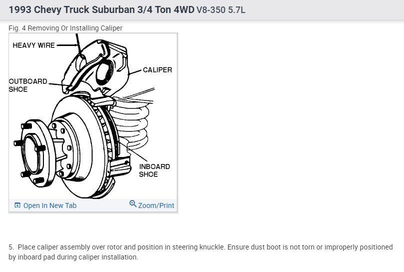

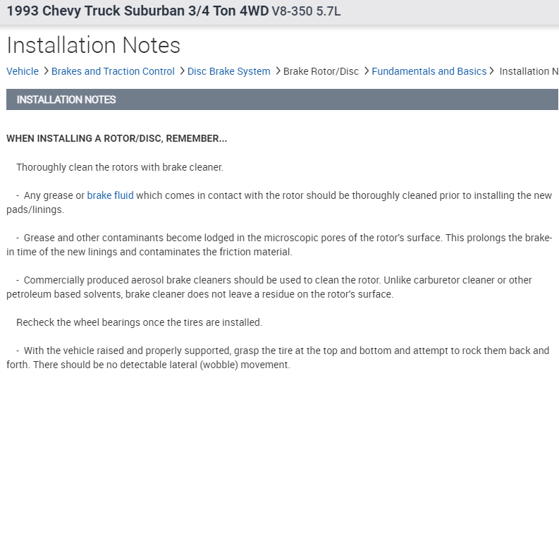

Having trouble removing front rotor from bearing hub. This is a 2500 heavy duty suburban. Any help will be greatly appreciated.
thanks,
js
Friday, September 25th, 2009 AT 8:11 PM
SQM
MECHANIC
6,383 POSTS
After all the bolts removed, you will need to use a wheel puller to remove the brake rotor from the hub.
I have attached the replacement procedure below.
