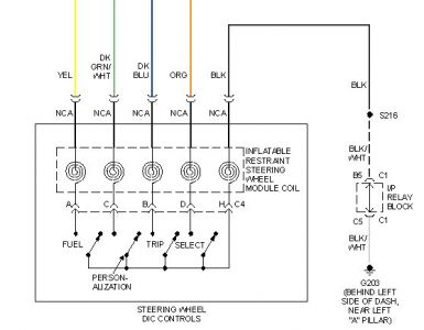

The MAF should be put in that is correct. If it isn't determining the right air flow it very well can create a drivability problem.
Regardless I still think there is a wiring problem of some sort. I'm not the greatest electrical guy by any stretch, but I "think" that that gauge going down is a ground problem, maybe a chafed wire for example. Look at the diagrams I sent to you. Turning headlights on should shut down the truck unless something is being electrically interfered with as I see it.
I certainly didn't mean taking it to the dealer. There are very good independent shops out there and would be glad to help direct you to one in your area if you get to that point. Say it cost $300 to diagnosis, better than scrapping the project.
You'll need a code reader, no special tricks. I don't know that you'll have codes, but would expect something. I'll look at the dash cluster diagram and see if anything in common is there.
http://www.2carpros.com/forum/automotive_pictures/30961_Image5_1.jpg
http://www.2carpros.com/forum/automotive_pictures/30961_Image6_1.jpg
Sunday, July 8th, 2007 AT 6:32 AM

Did you the the diagrams in your email?
Send me an email, so I know-got a few more that may help.
Sunday, July 8th, 2007 AT 8:16 AM
ALWAYSTRUCKIN
  • 12 POSTS
Yes, Paul, I got the diagram. Thank you. I am going to print it off and look at it today. I am waiting for my bestfriend to get back from church so we can get at it. He has more experience than me at this.

Hello Paul,
It took me a minute to study the schematics. I am learning as I go. This task looks very daunting. Okay, this is what I know, maybe you can lend some advise. The truck frame is not hot, it is grounded (good news). But the ground wire under the radiator on the left is also ground, without being connected to the frame. When I use a tester pen, I connect it to the red battery terminal and touched the ground wire, it lit up. (Note: When I have been driving the truck, the ground wire has not been attached to the frame.)
To try to see what side of the truck to start with, I cut the right side ground wire to see if both black wire were still reading negative, they did when I touched them. (Note: Before I cut the wire, the right side lights were acting up and/or wouldn't work. After I cut the wires, the lights on both sides came on normally. I cant explain this.)
So I do not know where to begin, left or right. I will begin on the left side though, tracing the ground wire backwards, because that was the side hit during the original accident. I tried to go up under the truck to see if any of the cords anywhere were noticeably pinched or crushed, but nothing stood out. Working left to right. I began just unwrapping and rewrapping the cords beginning on the left side of the truck. I called it due to darkness and the home run derby.
QUESTION #1: Is there anything I can get to read the cords that I can touch the wires and it leads me to the one that is touching he ground wire it is wrapped with.
QUESTION #2: How would you begin knowing the above. Do you think my approach is logical?
QUESTION #3: Why do you think the ground wire that connects to the frame is negative without being connected to the frame? It is suppose to be hot. Correct?
QUESTION #4: Do you agree the problem has to be somewhere in the headlight connections because when I turn the lights on the power to the truck cuts out. Then when I turn them back off, the power picks back up in the truck.
Any advise you can provide would be appreciated. Thank you

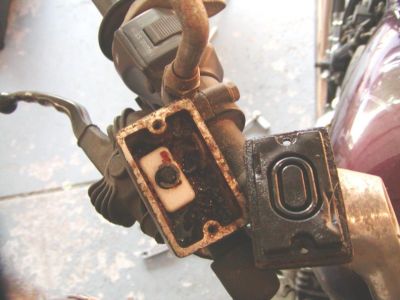

I think using a digital volt meter is the best way to go about this. The battery should be hooked up. I think we should focus on finding how much power is getting to the switch and how much leaves the switch. As the voltage comes from the battery (12.6), it will lose a little as it goes along. every connector will eat up .1 v roughly the lights will eat up a major portion of the voltage or other components on the circuit. after the componet is a ground and the left over voltage returns back to the negative terminal of the battery through the body grounds.
Nice bike BTW, Kawasaki? I just bought an 82 yamaha maxim 1100. I hope to get it going by fall. :shock:
http://www.2carpros.com/forum/automotive_pictures/30961_MCsm_2.jpg
The blackish sludge is what was brake fluid. :cry:
