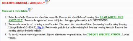

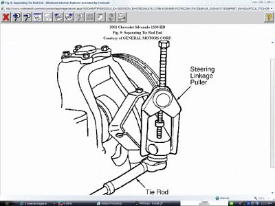

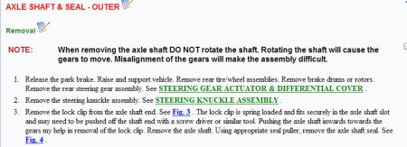

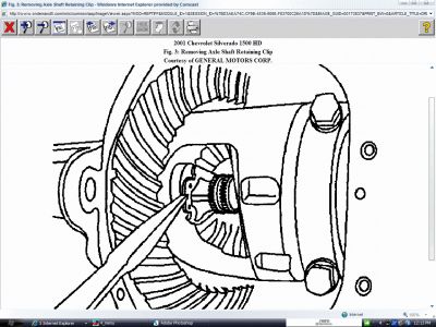

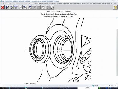

How do I change the rear wheel bearing on a 2001 silverado 2500 HD
Monday, January 28th, 2008 AT 11:10 AM
MERLIN2021
MECHANIC
17,250 POSTS
Raise the rear and support on stands, remove the rear end cover, have a drain bucket under it. Then follow these steps...
