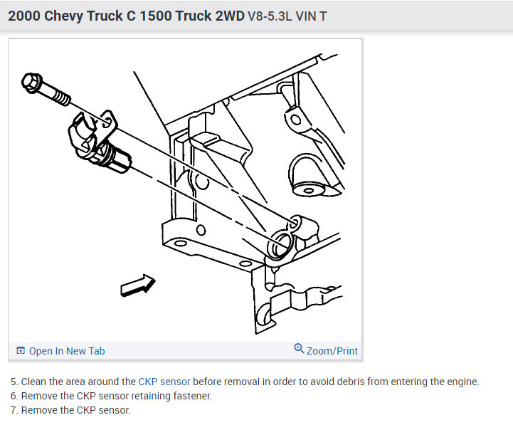

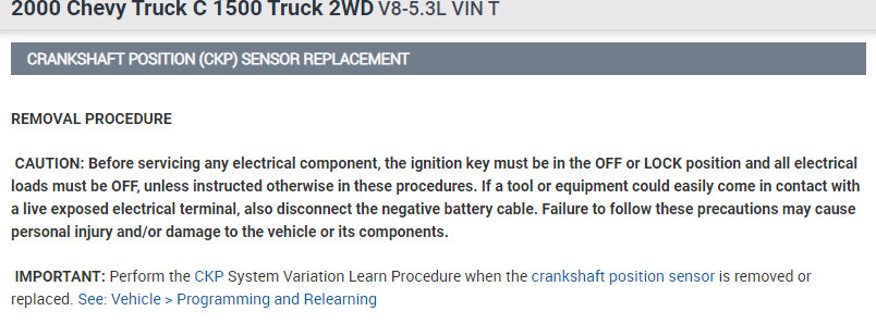

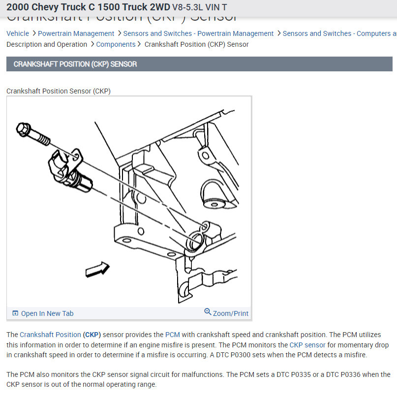

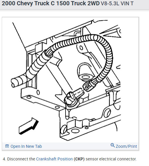

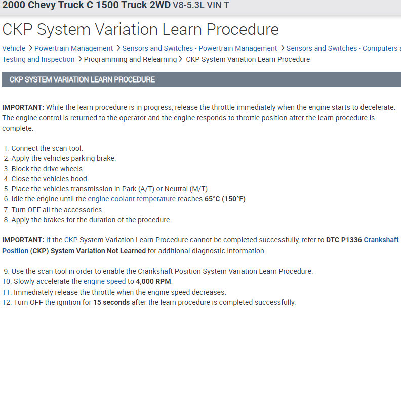

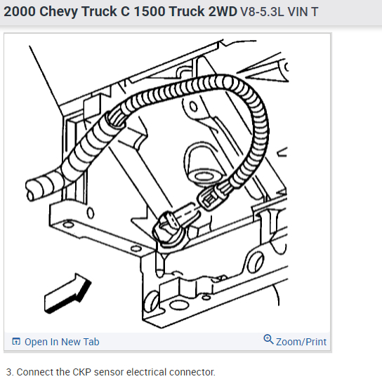

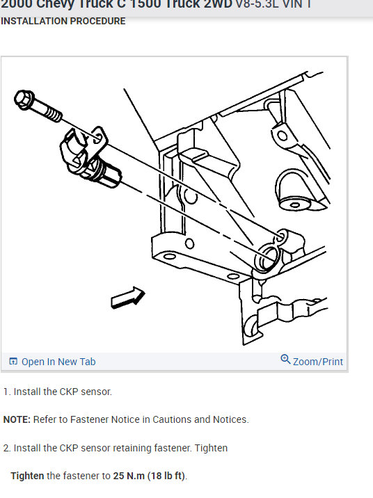

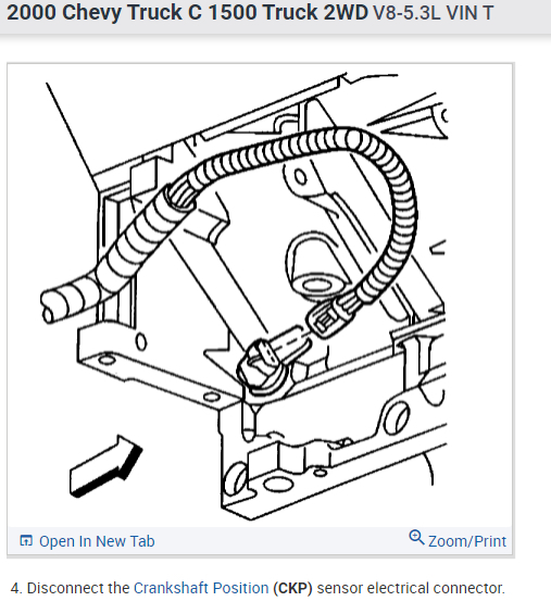

It sounds like you might have a faulty crank positing sensor.
When a crank sensor goes bad it will impact how the engine start.
Typically you will have starting issue due to engine temperature, especially when hot the engine can stall or not start after shutting off.
When a crank sensor fails it may or may not trigger the check engine light.

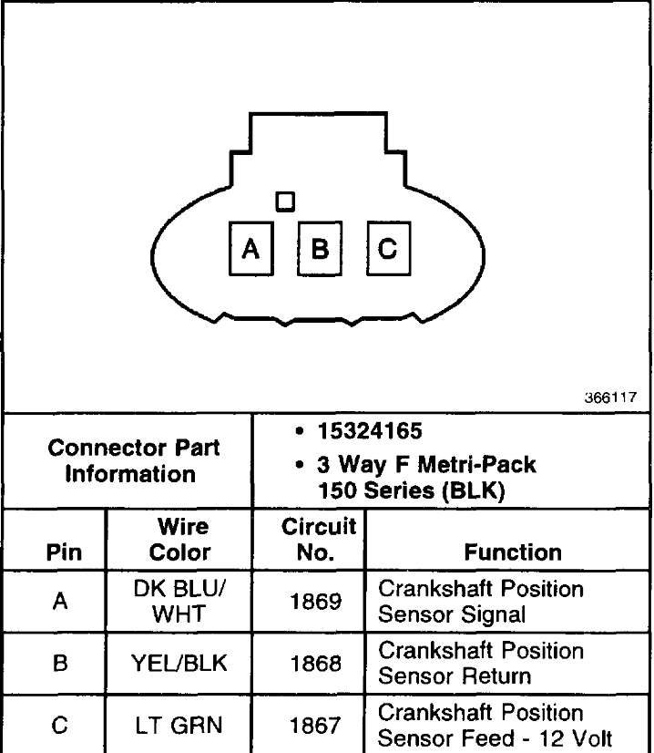

You need to check to see if you are getting power to the sensor. You should have 5V to the pin.
Here are few helpful articles:
https://www.2carpros.com/articles/how-a-crank-shaft-angle-sensor-works
I have attached the replacement procedure for your reference.
