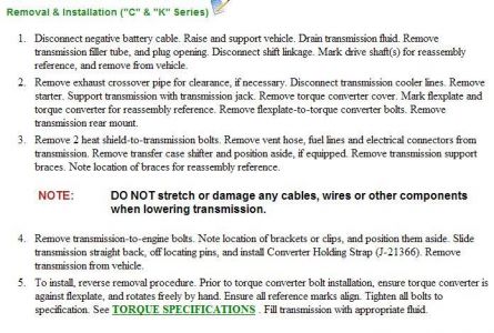

Once reversoe goes there is nothing that can be done other than an overhaul of the engine or replacement. Below are the procedures for removing and replacing your vehicle's automatic transmission..
https://www.2carpros.com/forum/automotive_pictures/261618_Noname_427.jpg

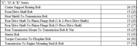

TORQUE SPECS ARE IN Ft. Lbs. (N.m)
https://www.2carpros.com/forum/automotive_pictures/261618_Noname2_115.jpg
